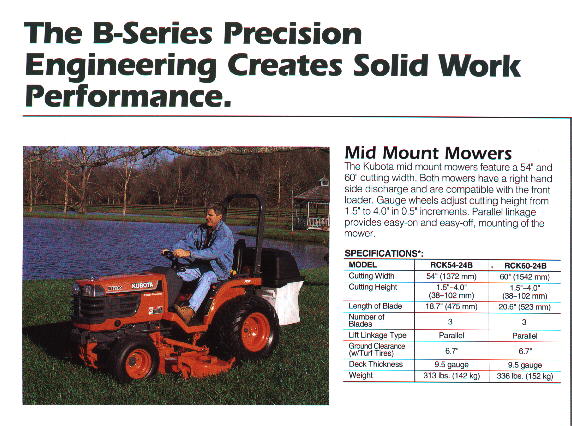

Here is a not very good pic of a Kubota B1700 with bar turfs on the rear. The B1700 and B2100 were dropped as was the 2400 in 2000. The B1700 had the same D905 engine as the BX2200 rated at 17 horsepower at 2600 RPM. Interestingly the B1700 and the B2100 and the B2400 all had Position Control. The pictured B1700 was 2WD though it was avaialble in 4WD and also gear and hydro and all 3 models(4WD) were available with Bispeed turning. Now only the 2410HSDB has the Bispeed feature. Realy cool. J

Look at the last page on the BX1800/2200 brochure. They call the tires TURF and BAR TURF when listing hieghts and widths. The don't list R1's.
   / Extra set of tires for new BX2200? #20
That is interesting, I have a new brochure and the one that came with my BX, nothing there on mine about bar turfs, maybe I should go find my glasses. Nonetheless they are not bar turfs, they are bar R1's. Bar turfs have a rounded shoulder, and generally, but not always, a double cheveron, depending upon width it could be more or even less. The spacing between bars is less also so as to provide more surface support. They would seem to be a nice tire. I think the ones on the little JD (with wife smiling) are in fact bar turfs. The BX bar tires are not terrible on turf but thinking they were intended for turf is a mistake, they will tear the ground and leave marks unless you stay off when wet/soft/muddy or get aggresive in turning in 4WD or sometimes even 2WD.
