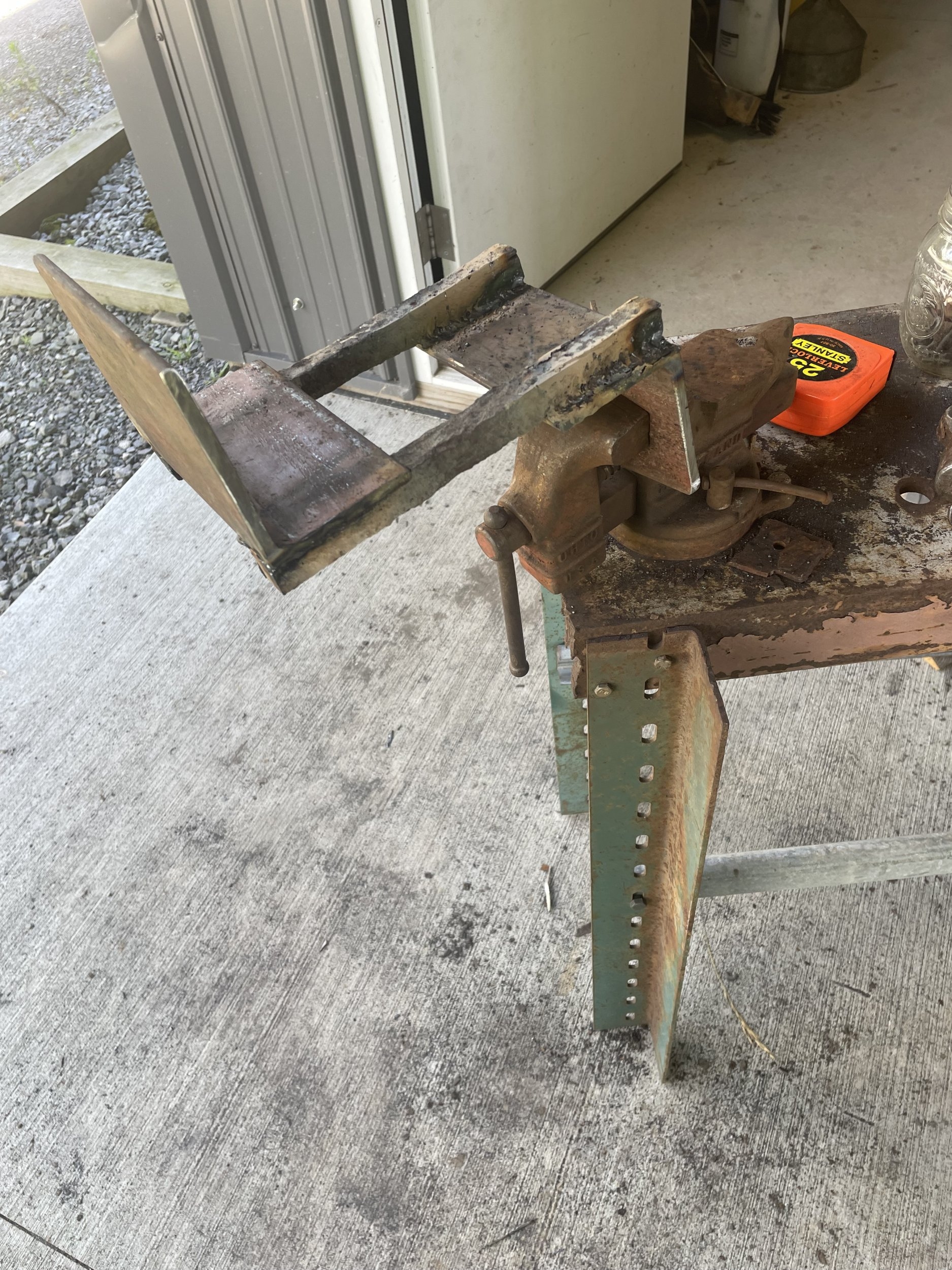

I’ve been having some knee issues since my 1951 Ford 8n broke down in mid-May. My only other 3-point hitch tractor (John Deere 4120) has a much higher operators platform. I always did most of the smaller jobs, that required lots of getting on and off, with that old Ford. I am not going to have time to get that old Ford fixed until winter.
To save my knee, I made up a 9” step extension for the John Deere. After a couple days of usage, my knee is already feeling much better.
I was a little worried about loss of ground clearance but no trouble there so far. A neighbor kid got his ATV stuck in a deep ditch behind his house last night and I had to drive thru some deep mud to get to it. No issues going thru that mud or ditches with the new step.
The step extension took me about an hour to make, from steel that I found on my scrap pile, and about (5) 1/8” 6011 welding rods.

It looks real low but as long as it works for you.
I'd be tempted to either run some weld beads or drill and tap it and run some short bolts up for studs to give some traction for when that gets wet, muddy or snow covered.

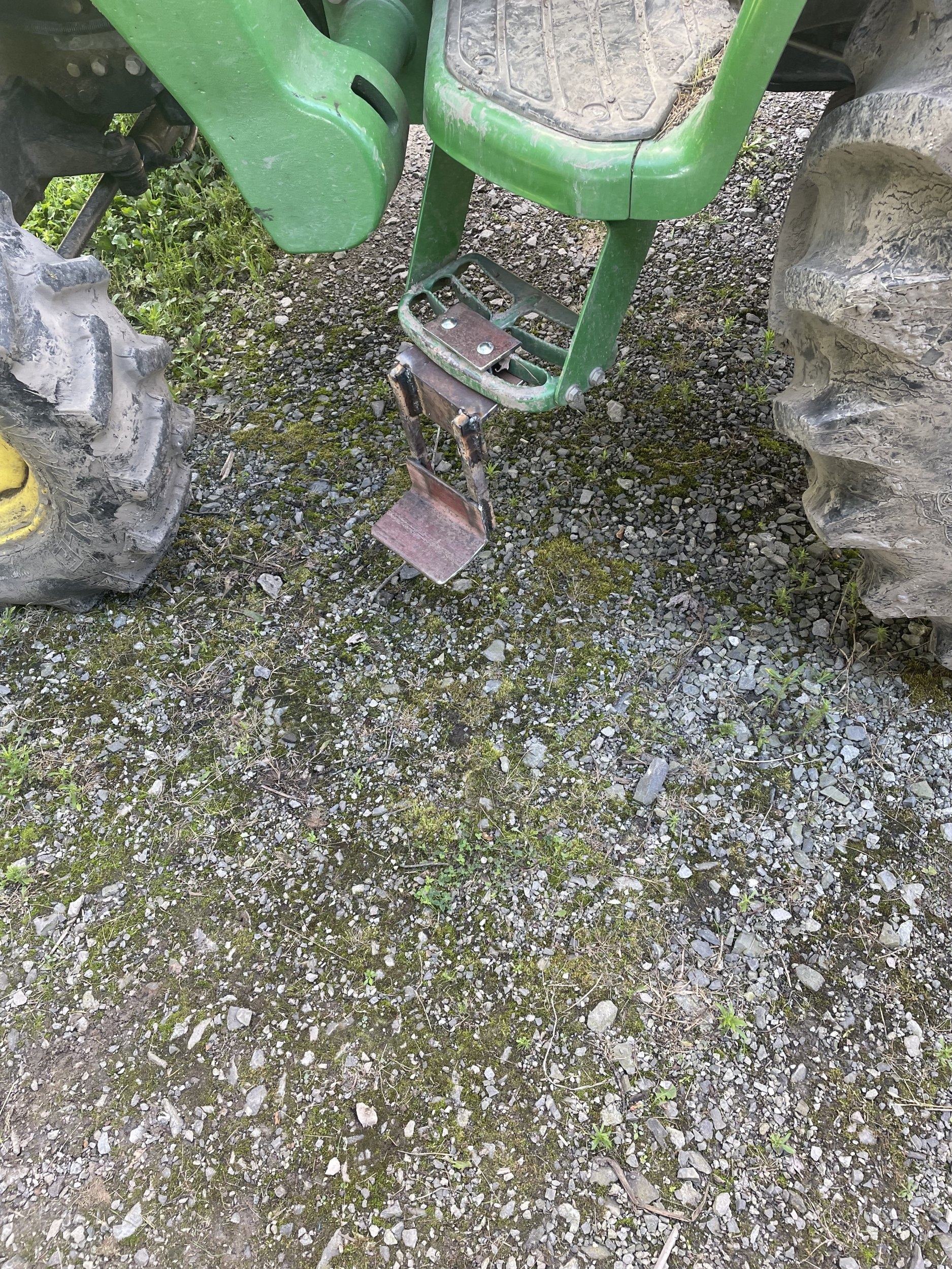

I think that the step being so low will catch on the ground sooner or later and bend or rip the upper step off.
I saw an idea that my solve the clearance problem.
The guy used a timing type chain (bend front/back but not sideways) to make a step that would swing back when it hit the ground or other obstruction, but NOT dive under the tractor when you step on it. It was a 1 piece chain design with a flat bar on the bottom for your foot.

I thought it looked kind of low too, but no issues in the mud or ditches last night. Good idea on the weld breads. That’s my main snowplowing tractor so those will come in handy this winter for sure. If my knee heals up my then, I might take it off for the winter.
It really is amazing how much more comfortable that makes getting on and off that tractor. Maybe I won’t even bother fixing the old Ford. The Deere is now easier to get in and off of, than that is.

I suppose I could replace the (2) 3/8” grade 5 attachment bolts with 1/4” and fender washers. That way they would shear off before the factory step would get damaged. Seeing as how the step is lined right up with the tires on that side, I don’t think that will be a big concern.
Also, this might just be a temporary thing until my knee heels up and/or I get the old Ford repaired. The hour that I put into it is already worth it, from how much better my knee feels, right now.

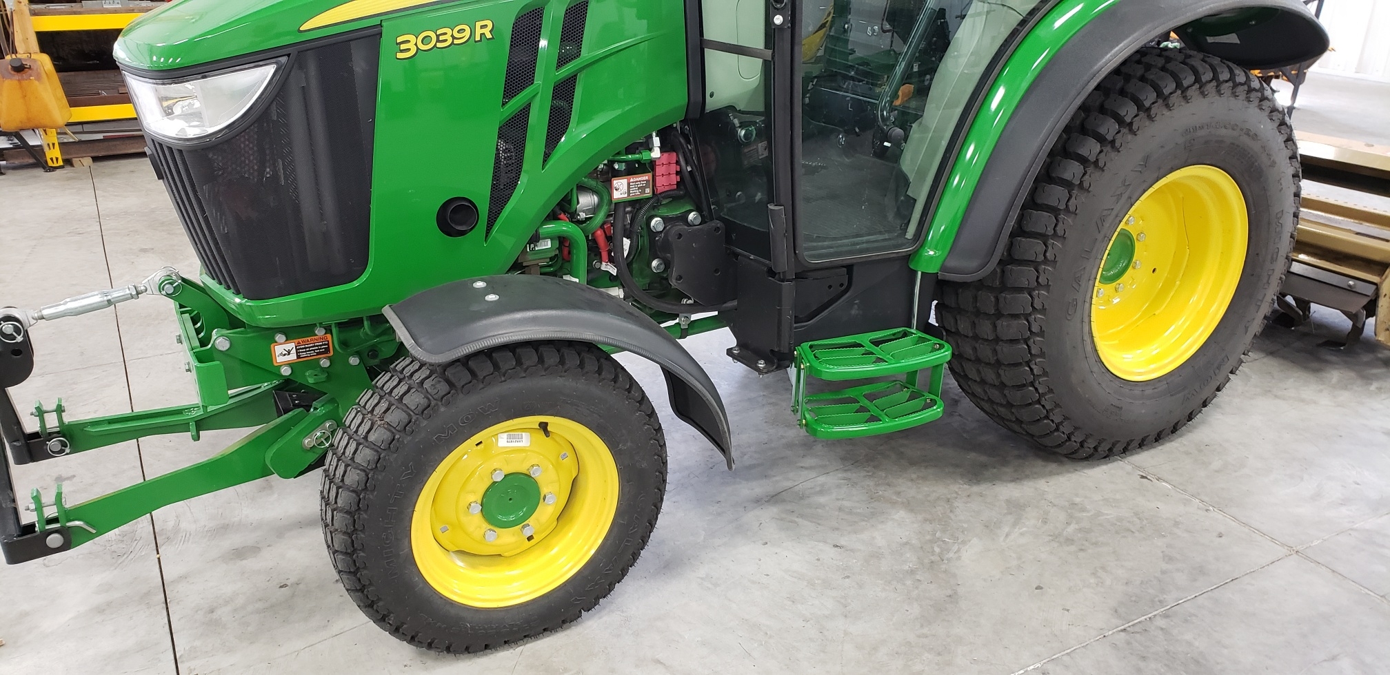

I did the same thing with my 3039r for the same reason.
Deere offers an optional second step and mount for the new 4 series but not the 3 series so I bought just the step and made my own mount. I made it weak so it would be the first thing to bend.

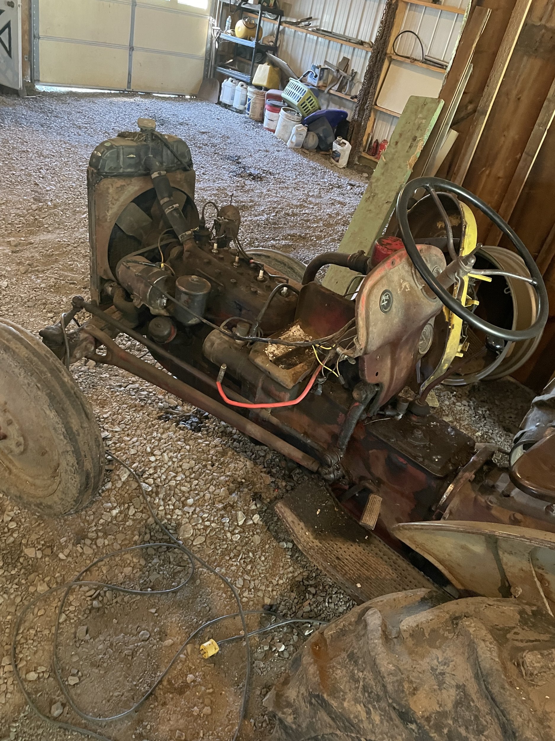

What is wrong with the 8N? Gas and spark are about that can go wrong, other than the hydraulics.

Weak and intermittent spark. I’m thinking it might be in the wiring harness or coil. I’ll buy a NAPA coil, to replace the cheap aftermarket one on it now, and if that don’t work, I’ll swap out the harness. No time for that until winter though.

Have you replaced the distributor cap? If it spits and pops any the cap is probably it.
