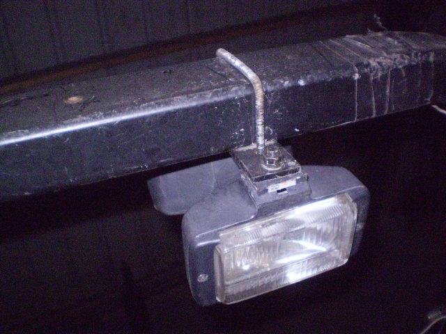

I wanted to share a very easy to make light mount for the ROPS on my TC40D. The "U" bolt is made from 1/4-20 all thread and I used a piece of 1/4" x 1.5" flat bar stock. I drilled 4 holes in the bar stock. Two holes for the "U" bolt and two holes near the ends to mount the lights on. I used some cheap driving lights from Harbor Freight. I found that the loader bucket blocks the tractor lights in front and it is difficult to see to the rear at night. I mounted one light facing each way and both problems are solved.

Great idea for an irritating problem! Can you post a diagram/photo/details of the wiring connection?

Check out some of the other posts on this subject. Most of the other folks have done a far more professional job than I did with the wiring. I just ran a couple of wires down the ROPS attached with electrical tape. I tapped the wire for the taillight for power and mounted a switch on the left side behind the seat. For the ROPS lights to work the taillights must be on as well. You could maybe ground directly to the ROPS but I thought that grounding through a pivot point would be unreliable so I ran a ground wire.
