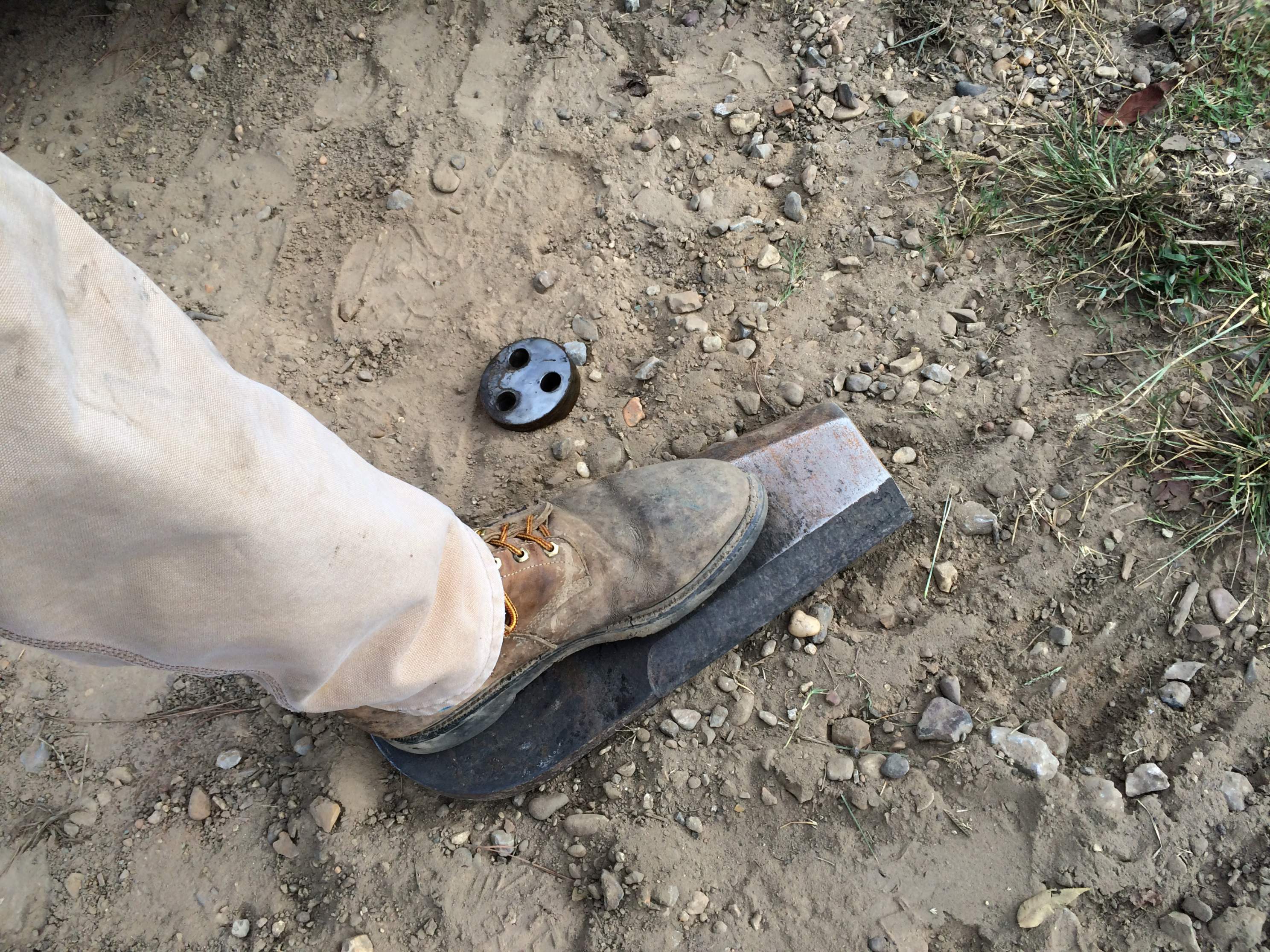

My theory is a rotary mower with offset blades (edge is lower than the mounting point) aren't as heavy duty as straight blades, like the Davco or Bradco.
Here's the Bradco blade with a size 14 boot on it. The puck (3.5" diameter) with the three holes is what the blade pivots on, held by three 3/4" grade 8 bolts. The blade carrier weighs 600lbs, the mower is 2klbs. They suggest 30-45gpm at up to 4ksi.
Thanks for the pic. I agree.
