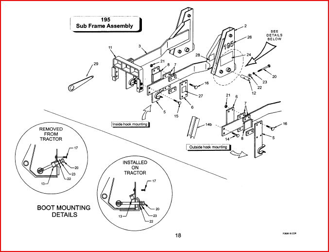

TBN says your attachment is invalid. I'm very interested in seeing pics of loader locks.
Condolences to the family of the victim. I hope he didn't suffer.
I'll try uploading it again:
The lift lock is #14b on the second picture. The lift lock for the DT275 with the Buhler 195 loader was important because the hood could not be opened without loosening and dropping the grill guard, and had to be done with a raised loader. It is not so important with the DK35 since the hood can be opened with the loader down.
View attachment 438225 View attachment 438226
Got it this time, thanks!

kco's 2nd pic looks identical parts-wise to my Allied 495's setup. Funny that while the mounting bosses & decals for lift locks are there the actual parts aren't. Yes, I do use the 7' wide bucket as a working platform with ladder to access and 8' 4x4s under the bucket. Guess I should make up some lock arms, but would keep using the lumber supports in case a bucket hose goes.
I've used concrete blocks as stands in a pinch, but always with plywood 'cushions' between them as well as oak cribbing underneath and on top. (haven't busted a block in 45 yrs, done that way .. or not at all) :2cents:
That same FEL is fitted to my Hurlimann 435. The loader carries the same placards. Unfortunately, the strut is not with the loader. It really should be fixed to the unit .
Good ideas with a serious flaw.
