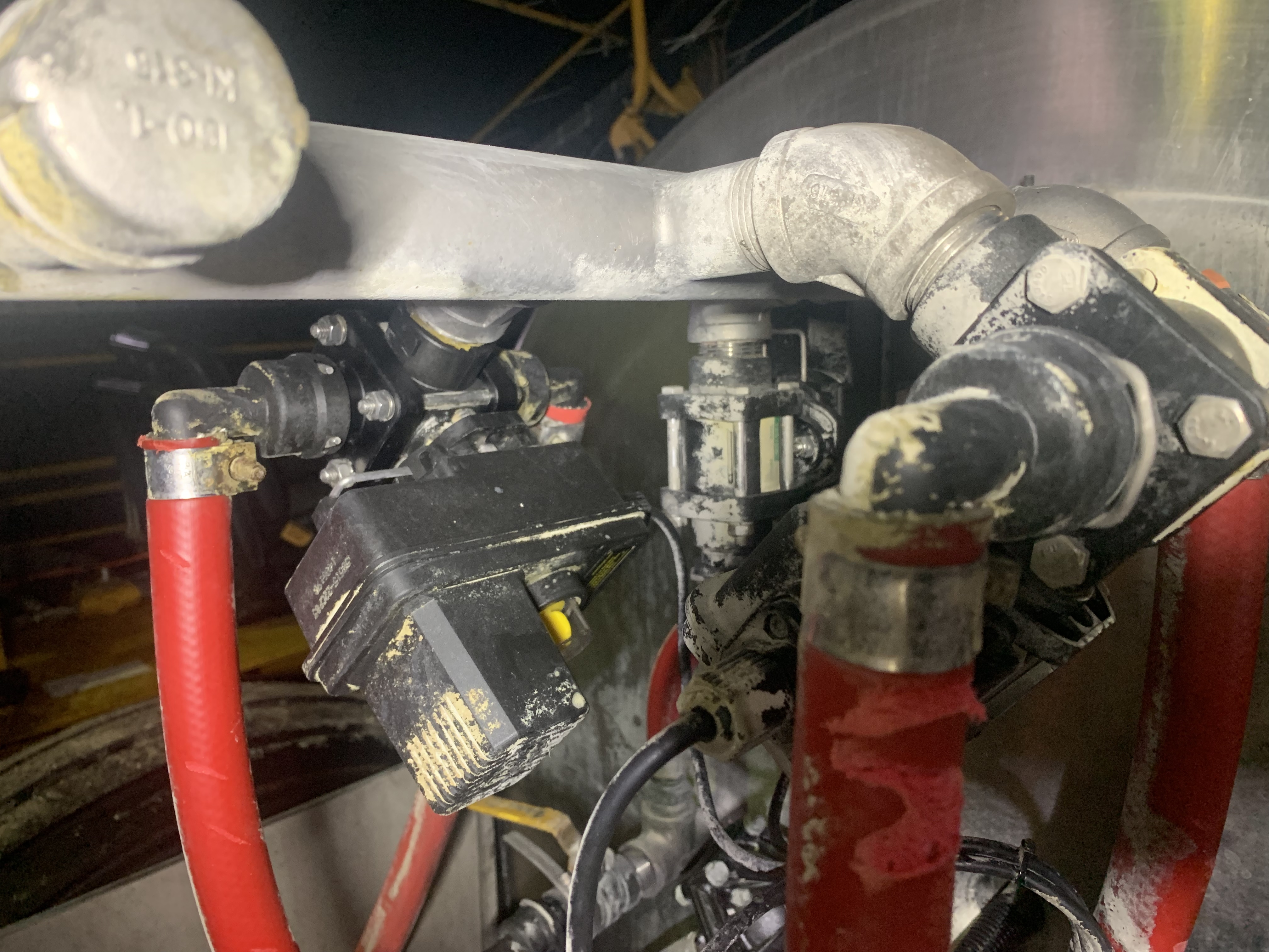

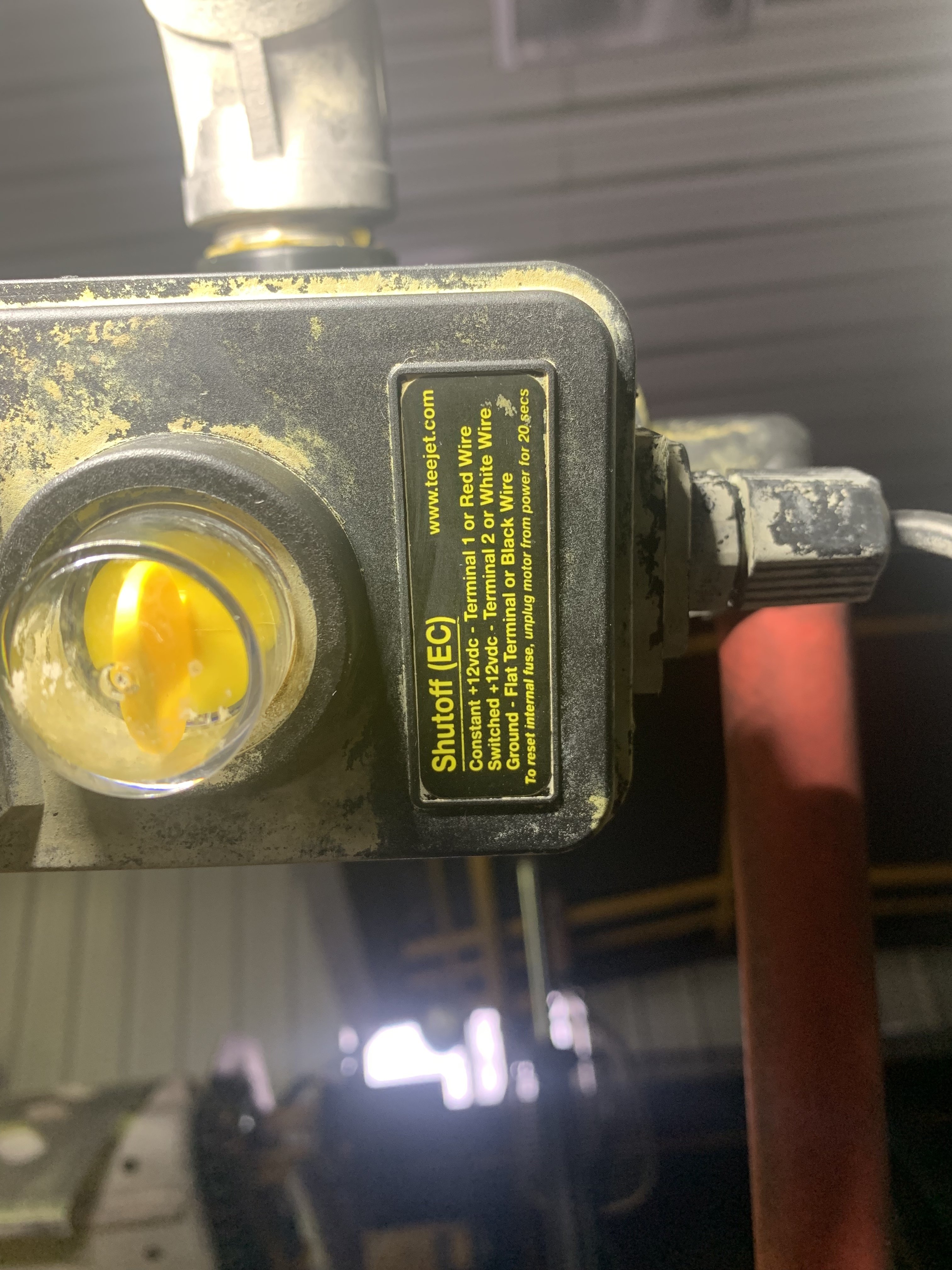

I’d look up some FE. Myers pump dealers and see what they can tell you about that pump and parts availability. Also as I mentioned before you could call Phil Brown Welding and see what they can tell you about it.
As far as electric valves I like the TeeJet series motor driven ball valves, I’ve got 9-10 years on a set in present sprayer and no issues. They make a lot of styles.
they’ve got a 46page PDF of all there options to choose from, very informative.
