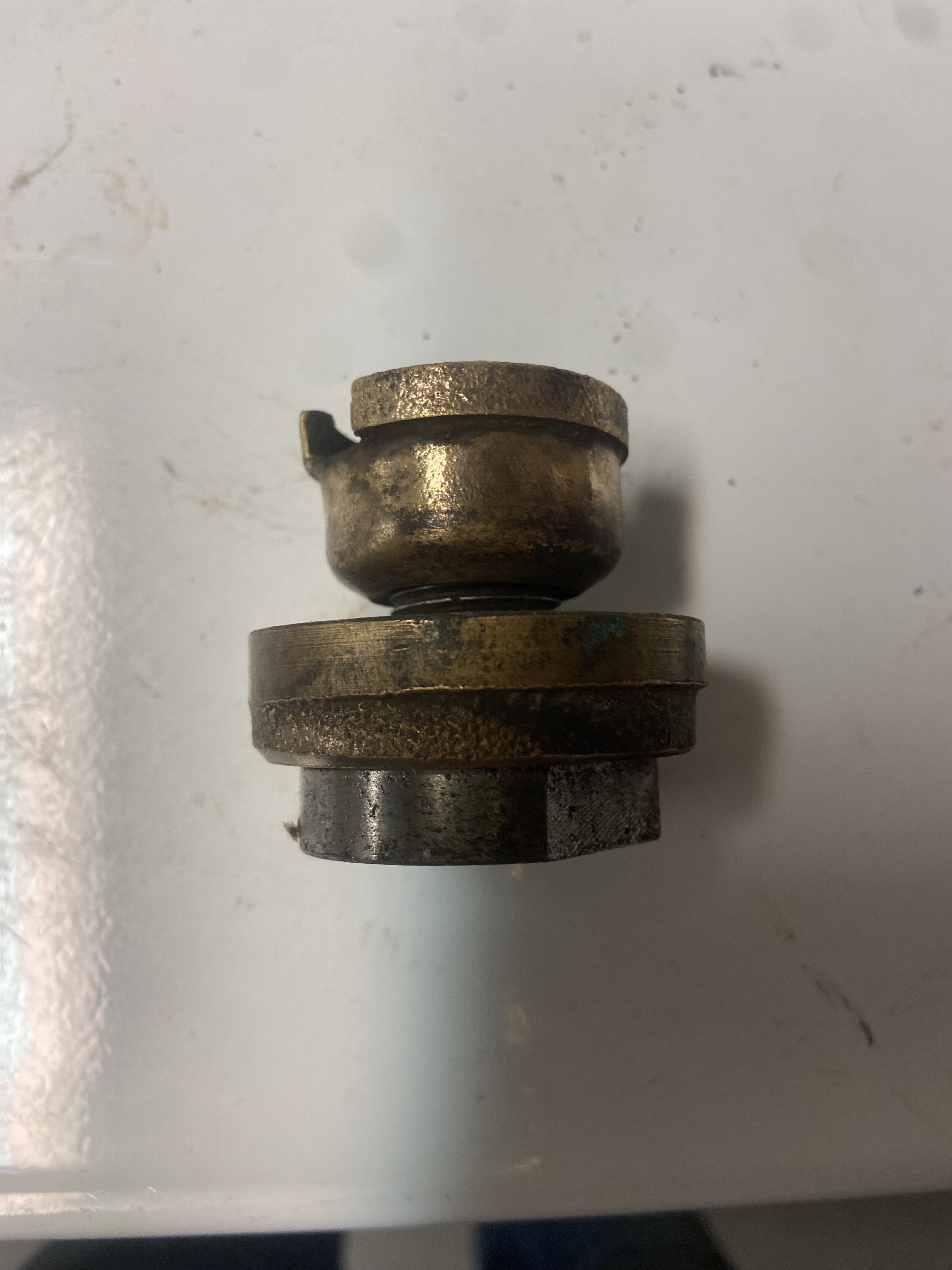

Here are some photos of the pistons

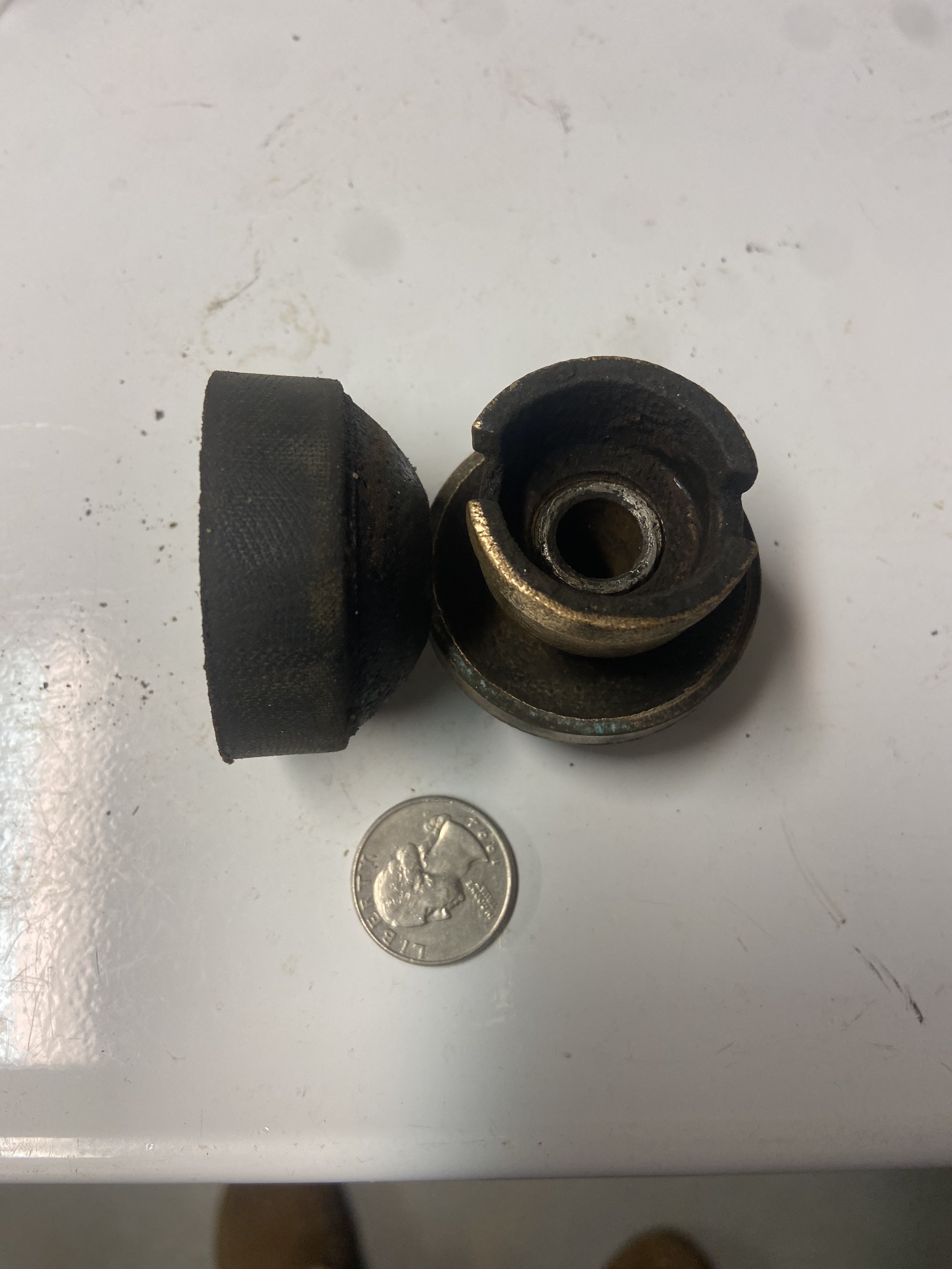

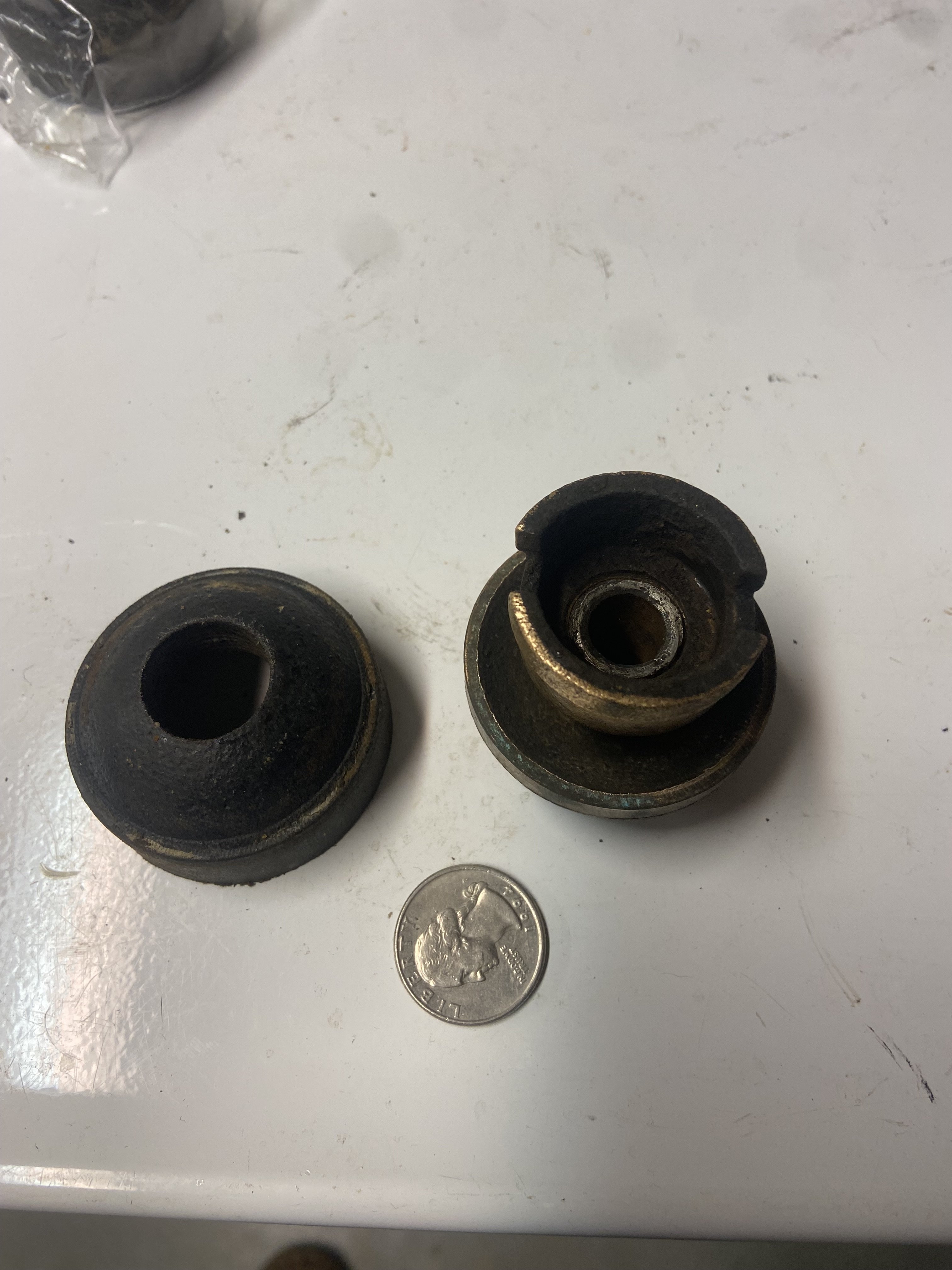

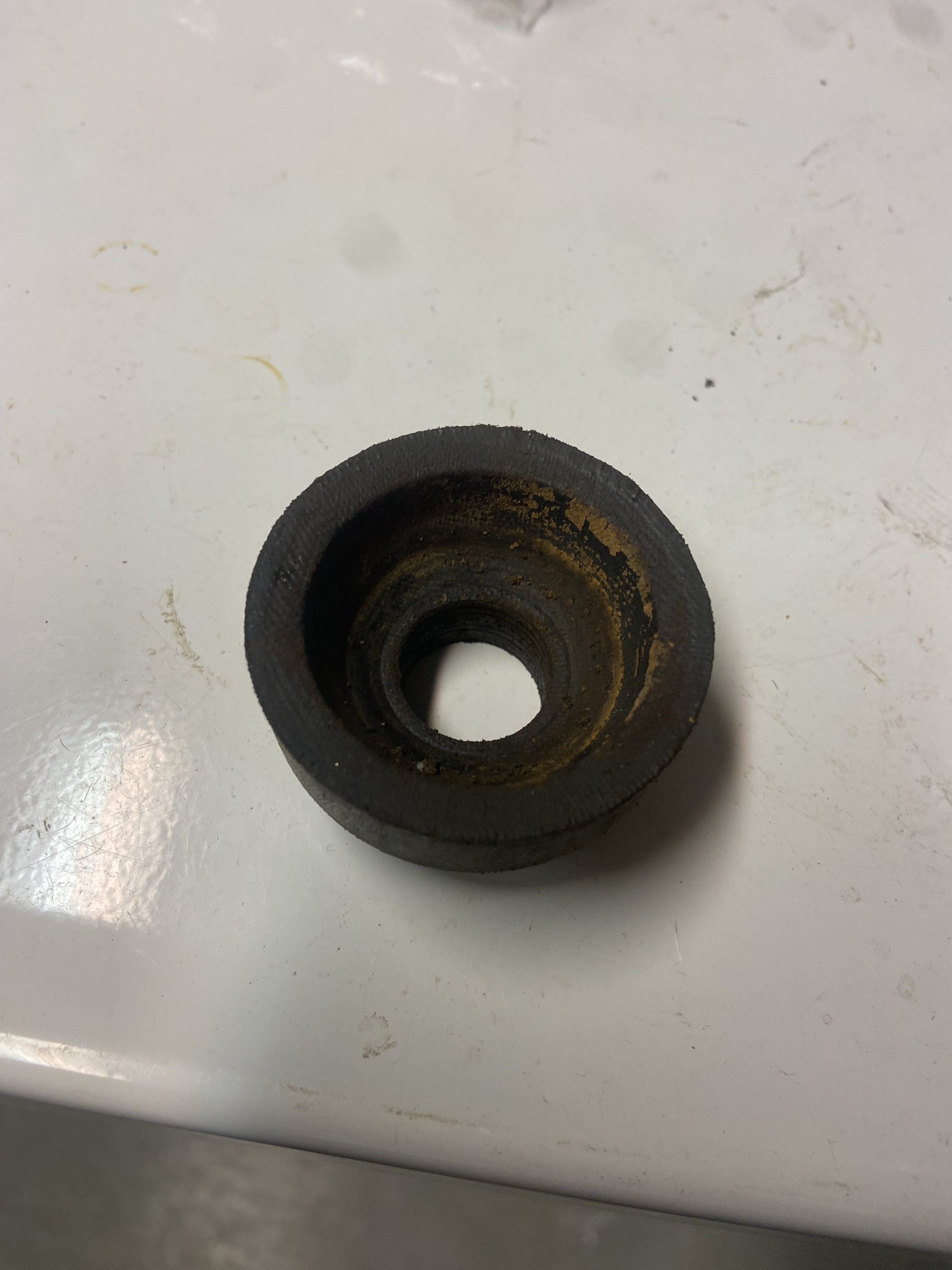

Not sure what to call the rubber cups that screw down onto the piston brass body. Any thoughts on where to source?

Nice work, those pistons look very much like what my FMC piston pump used . We always referred to the cups as the leathers. I had a special tool that fit in the slots of that clamping nut. I don’t think those leathers will be too hard to find. My FMC pump used ceramic cylinders for the leathers to slide and seal in. If you’re cylinders are ceramic be very careful with them and make sure there not cracked or chipped.
I always let the new leathers set in some hot water for a few minutes before install as that softened them and made much easier.

Update: Still haven't found any rubber/leather cups for the pump. The units I have look pretty good, but after all the tearing into it, I would like to find new units. I also bought new unions for the sprayer on the 3/4" pressure side to replace some crusty units currently on the unit. I think I am going to completely revamp the manifold that has the mechanical valves in it simply to make it easier to service and drain down the road. I am also going to add 4 compact 1/4" NPT ball valves to the cylinder head to drain it instead of the pipe plugs currently in the unit.

As I recall the leathers needed to be driven into the cylinders with a good sized hammer and steel pipe that fit into the cup , then the nut was tightened down on top . I don’t remember having a torque spec , maybe there is , I just snugged them up good and tight.
Pictures along with your questions would be very helpful
