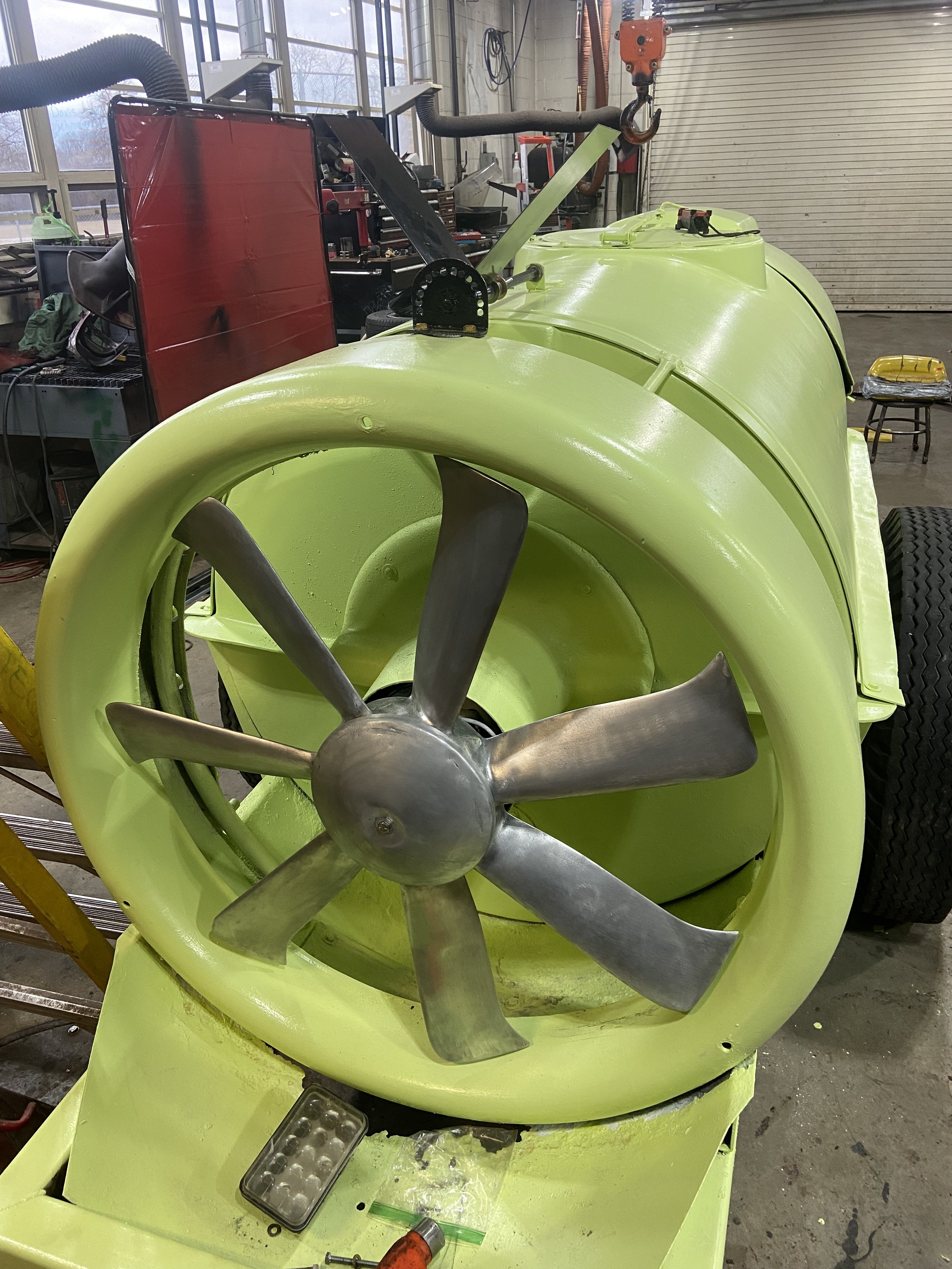

Today, I was able to get the fan off and start the process of giving it a polish. I think debris will stick to it less if it is smooth and shiny. Was actually pretty easy to get it off. I was worried it was going to be a bear to remove. I also pulled the hubs off just to check and make sure they were well greased and they were not. I've had quite a few hubs off in my day and these had to be greased once and once only. The hubs had a decent amount, but it was about the consistency of semi-cured RTV or soft tub and tile caulk. It was time to clean them up and repack.

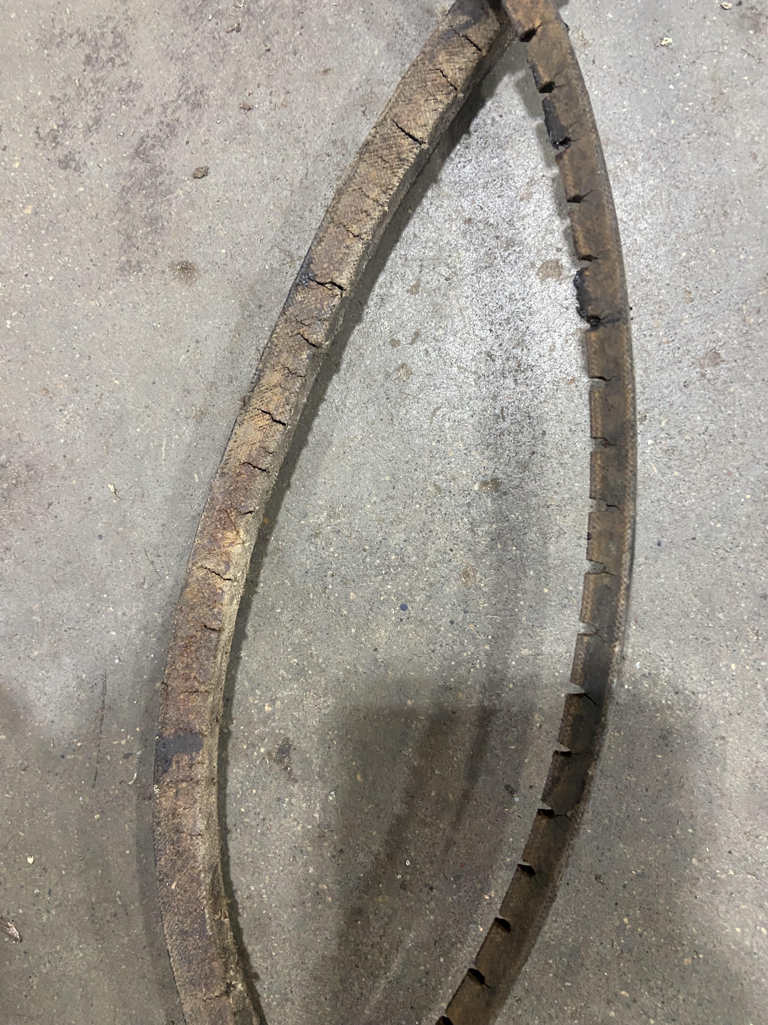

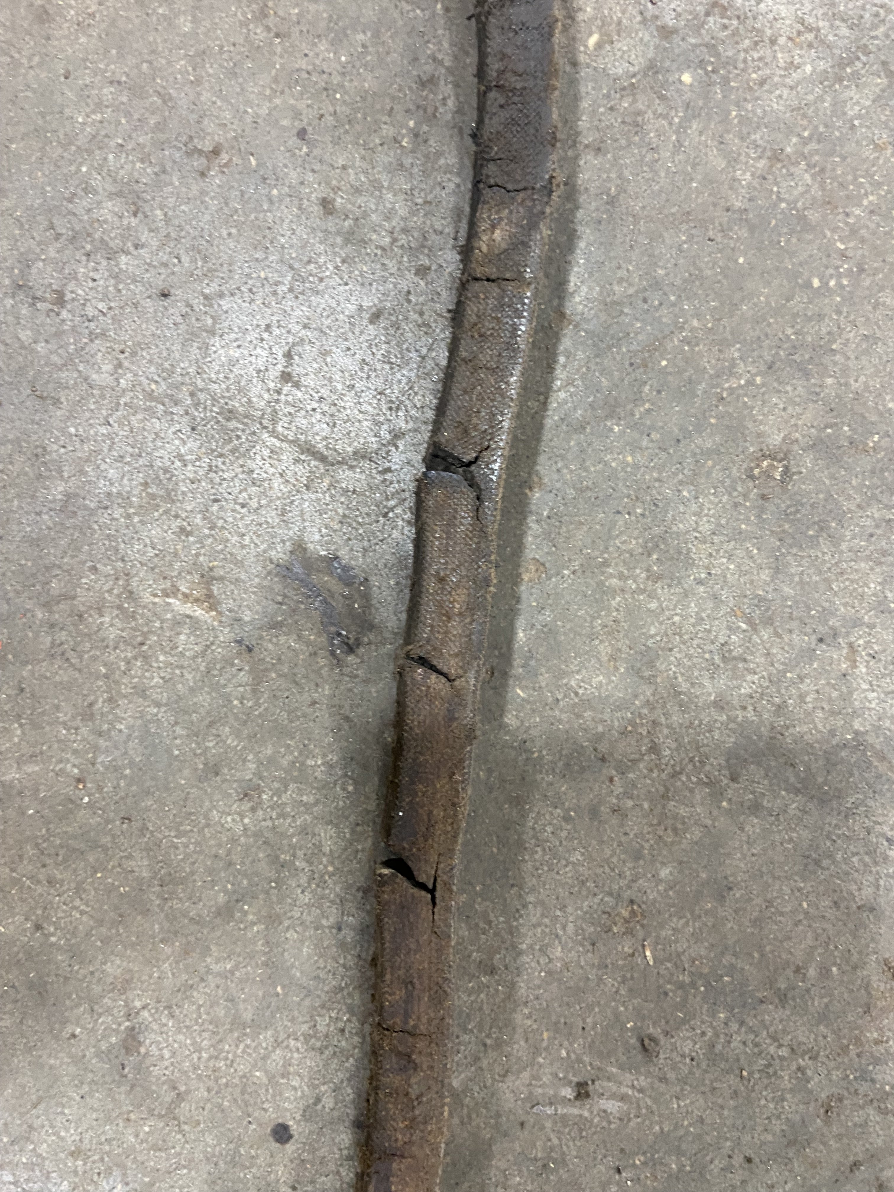

Update: Pulled the main drive shaft out in order to replace belts and bearings. Belts look to be original. It just has that look……

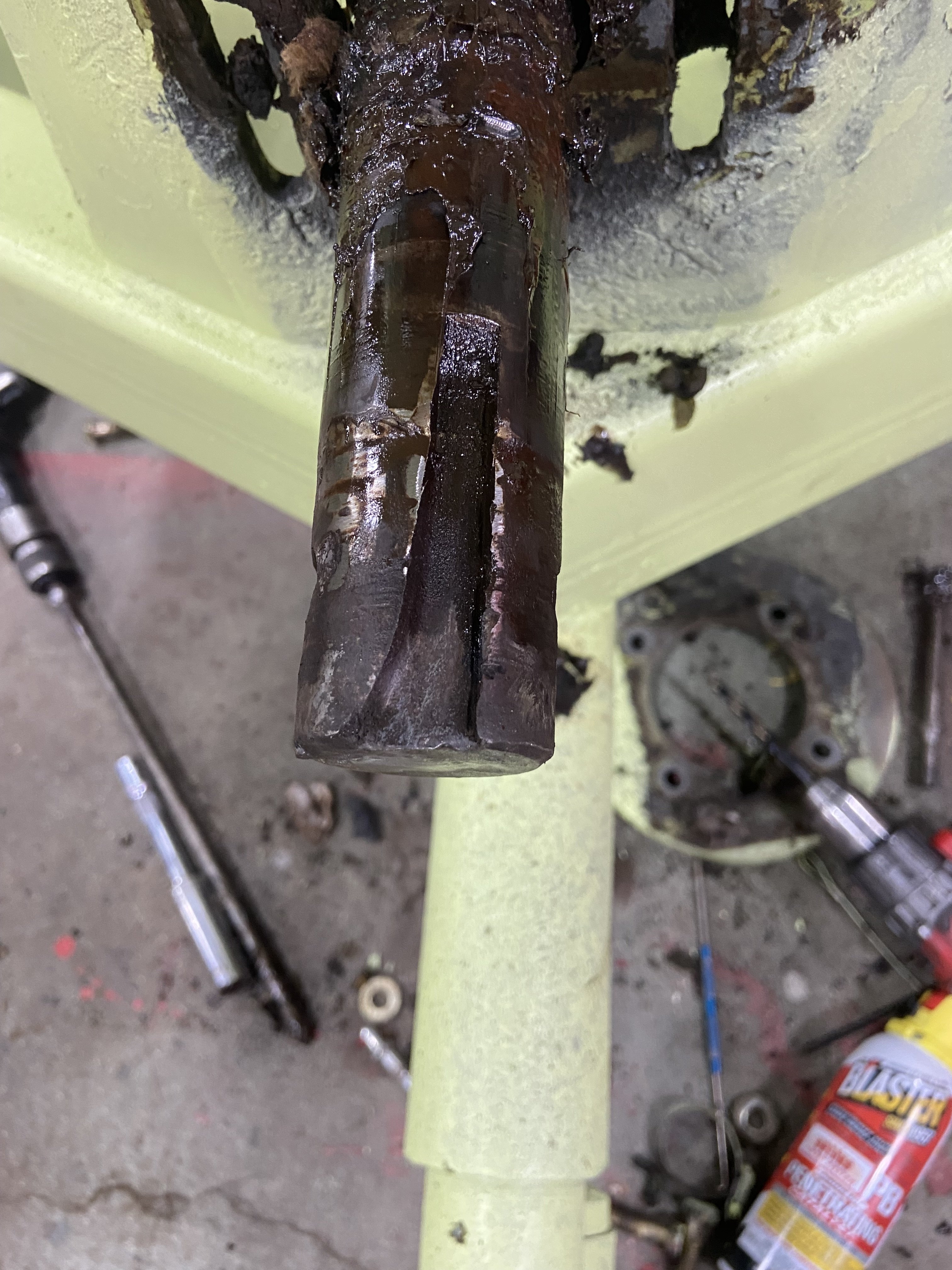

The input side of the PTO shaft is rough. I am going to have to do some work on the end of this key way

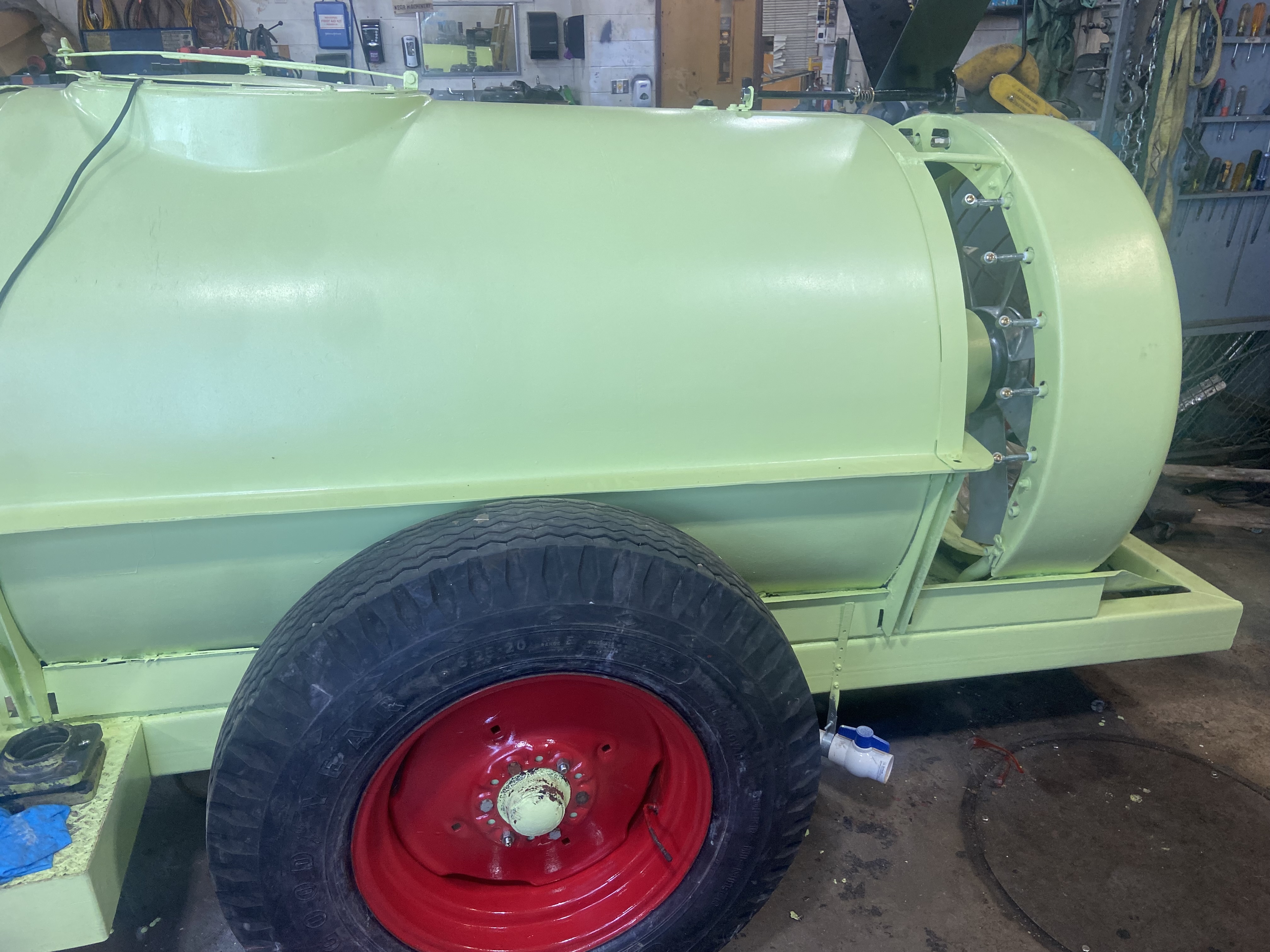

The fan and the nose cone are polished and mounted

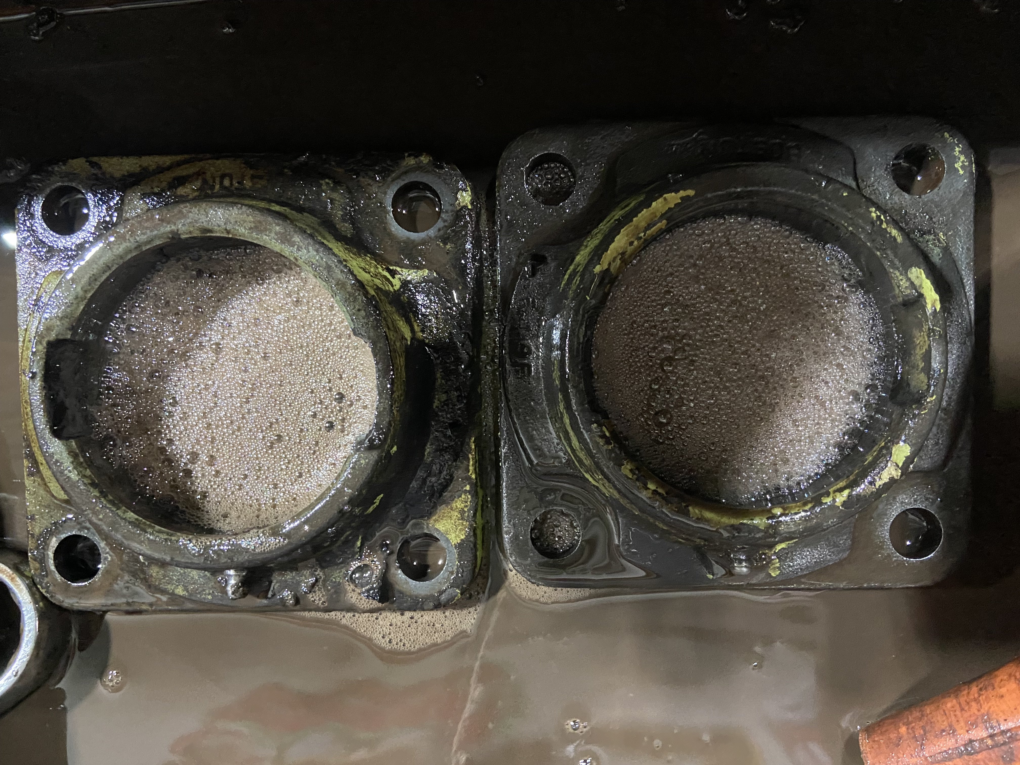

I pulled the flange bearings out and the housings look good, I ordered new bearings and I will redo the zerks to make them easier to get to.

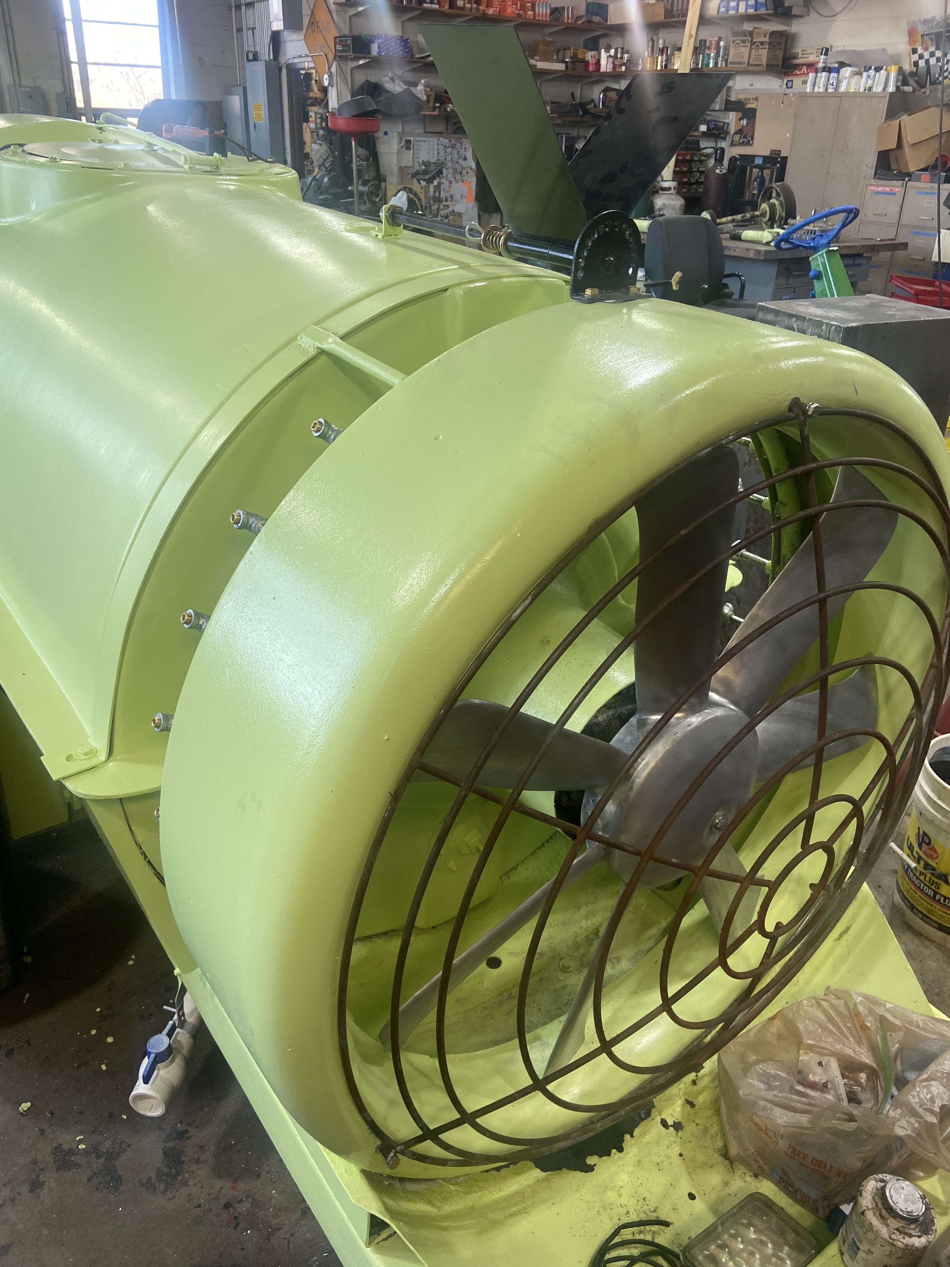

Fan guard installed with new inserts into the fiberglass.

The red wheels are what they seem to have in photos and mine were red too. Not exactly the same red, but very close.

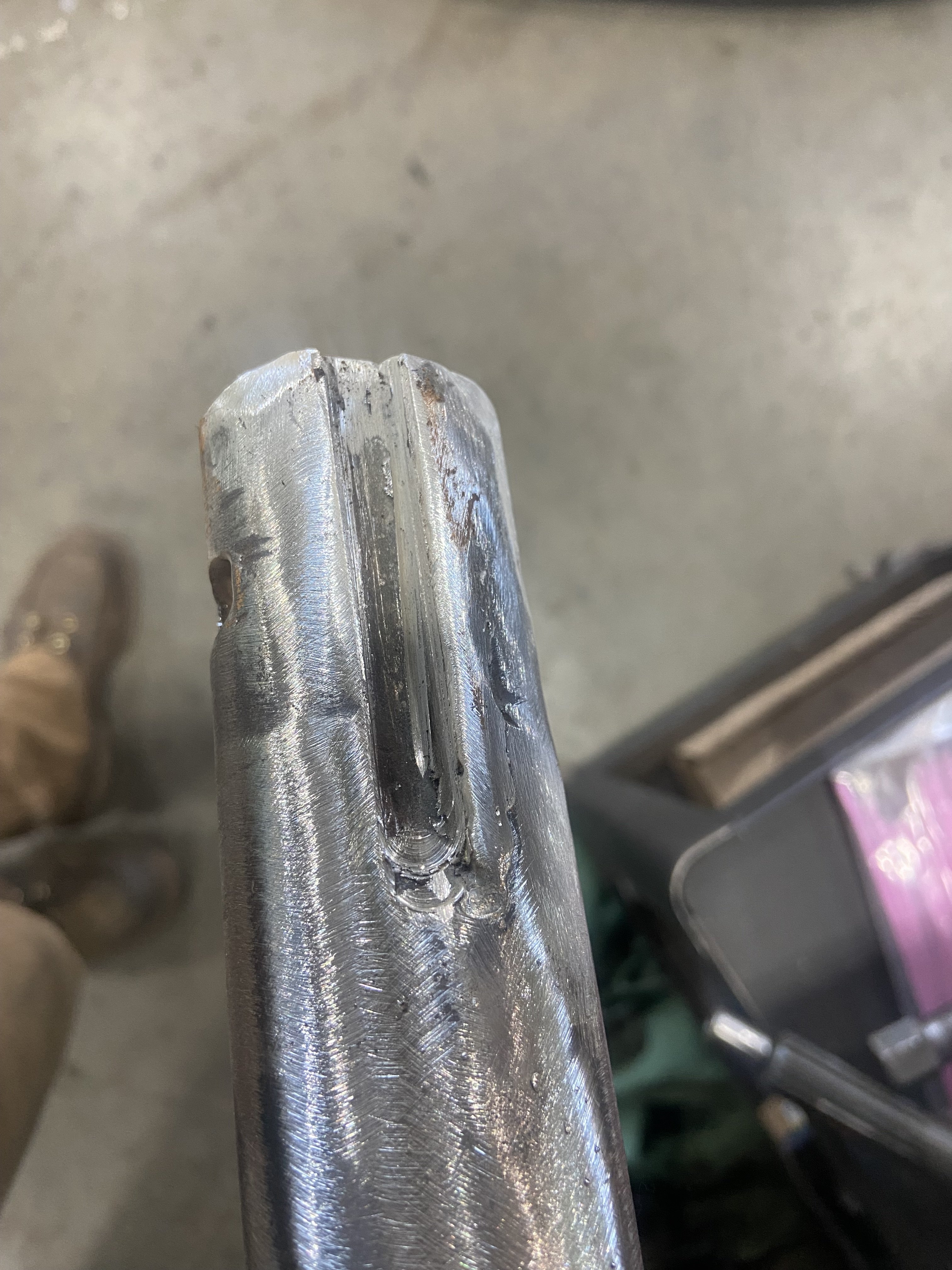

Welded up the end of the shaft and ran it through my mill. 3/8 key way was pretty easy. Waiting on new key stock.
