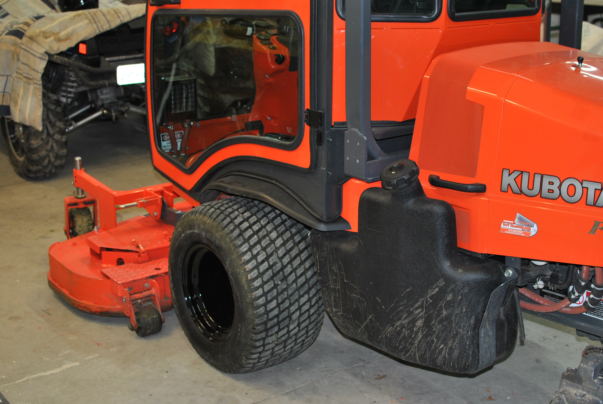

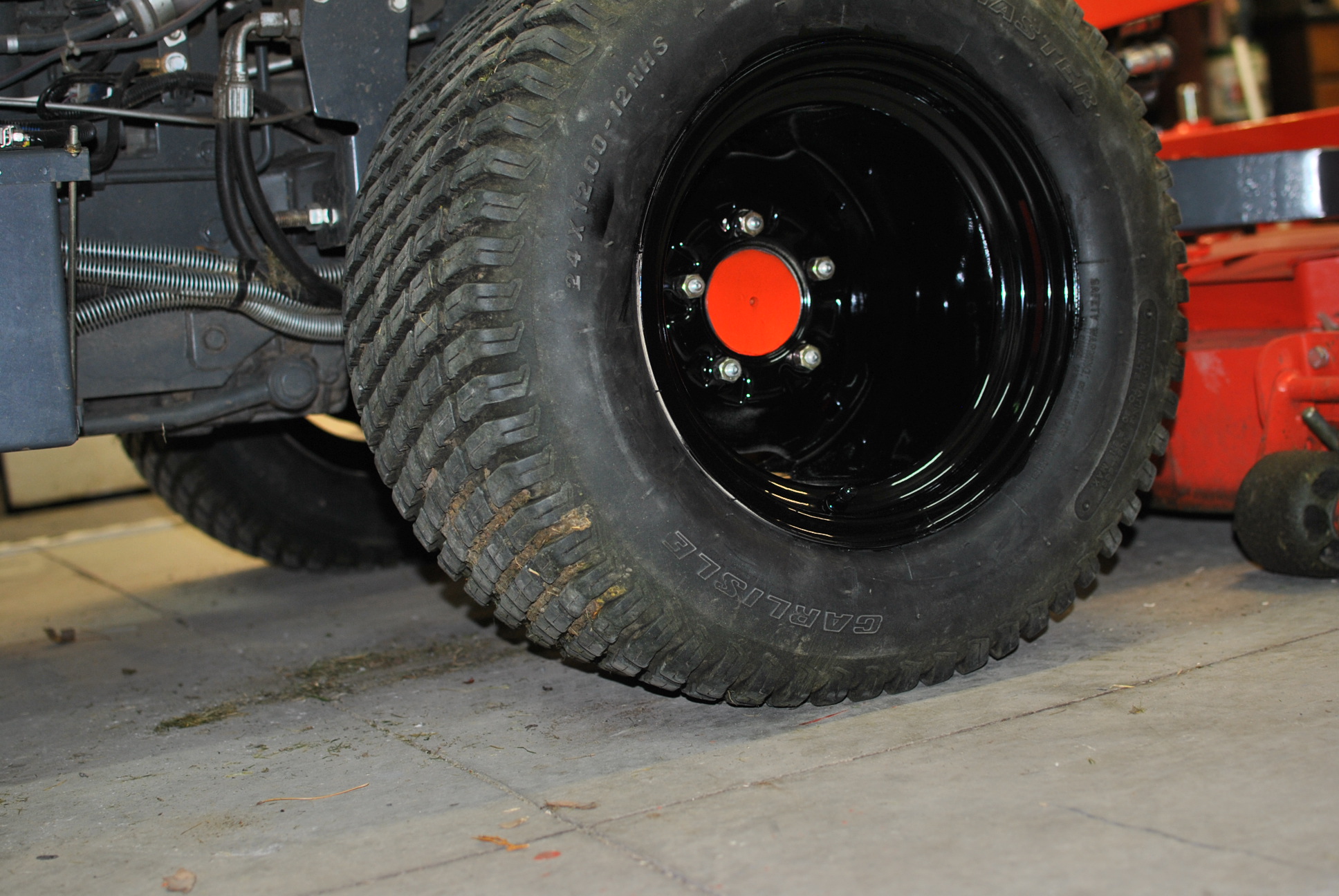

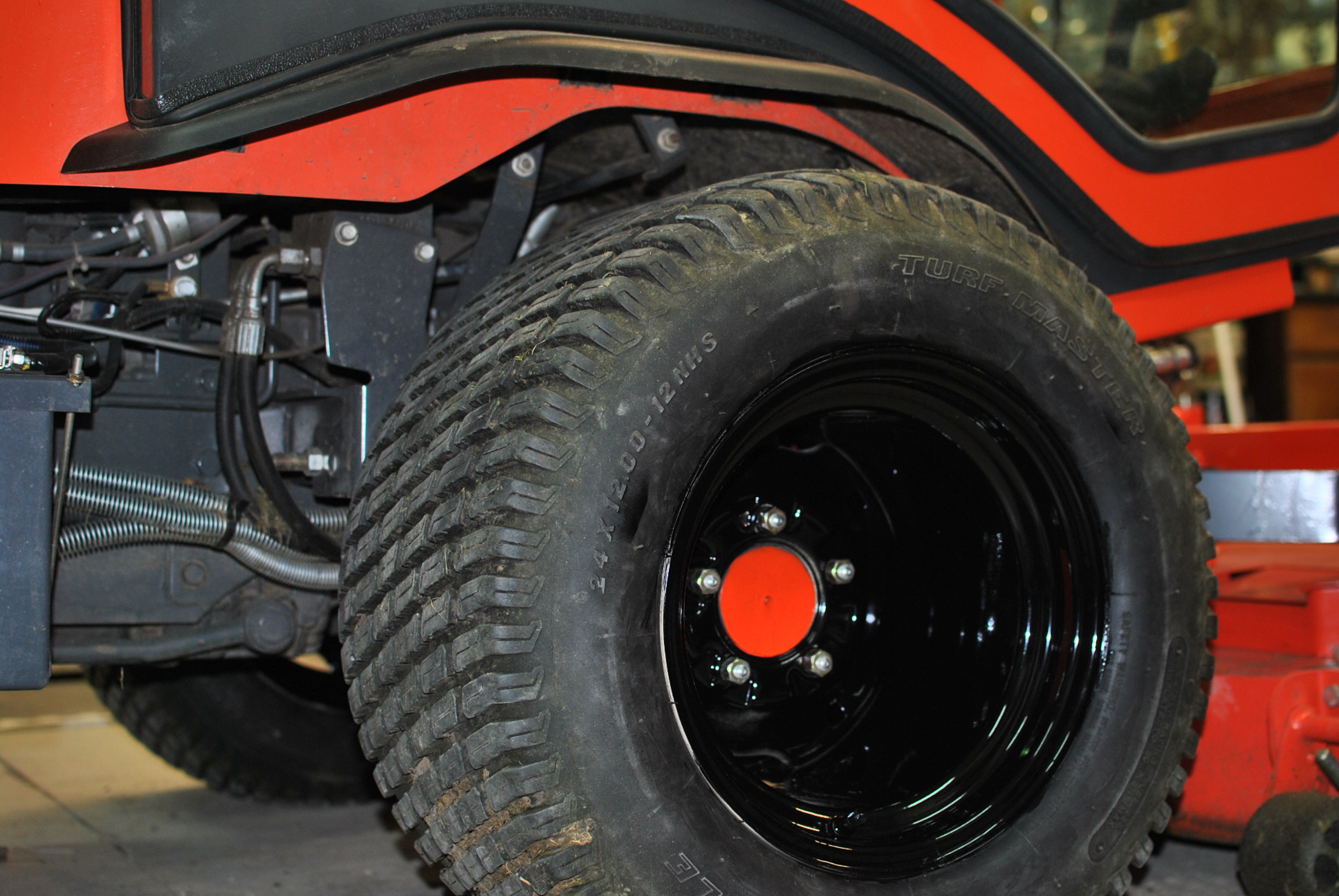

Dan, black rims look good, may paint mine when I get these bar tires off and put my original turfs back on.
I posted pics for potential buyer to see them. I don't mow in snow or mud so I prefer turf tires on my Fs.

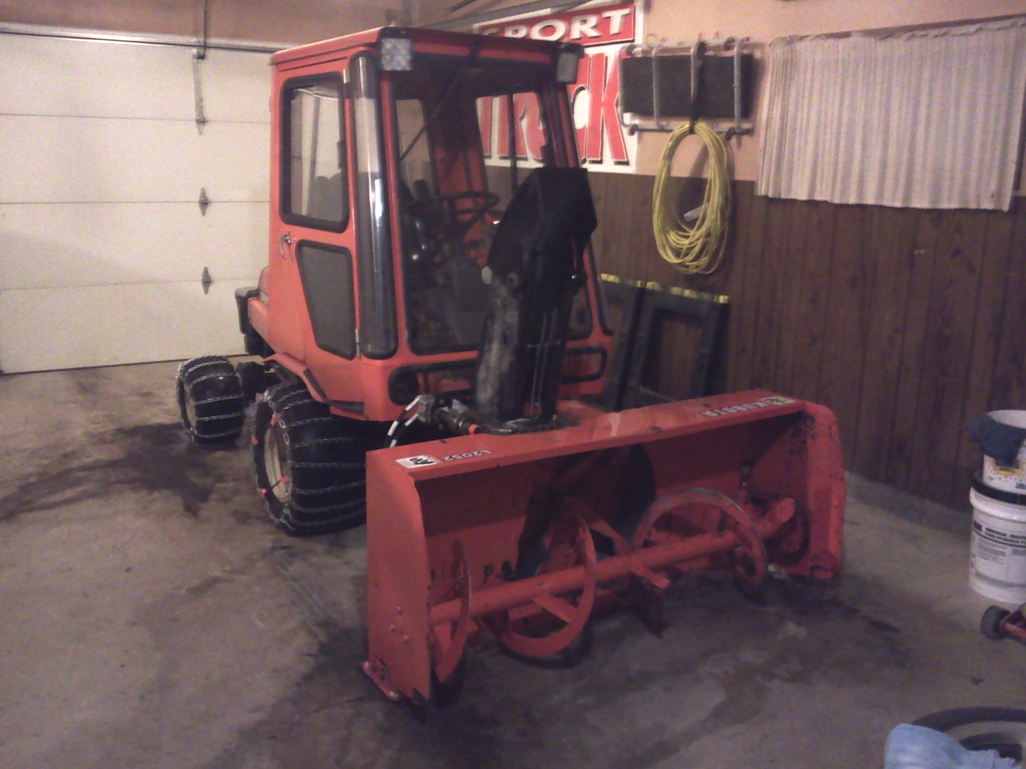

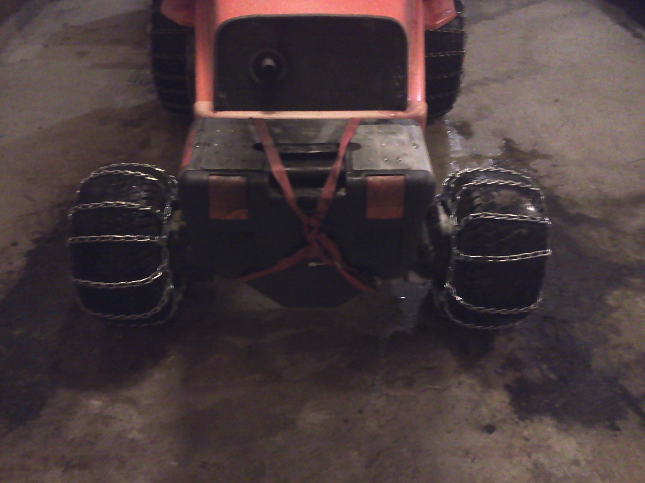

I am wondering if anyone with an F series has installed tire chains, specifically on the steering tires?
I bought appropriate sized chains for my 18x9.5-8 tires, and was dismayed that they interfered with the hub/knuckle/spindle behind the wheel when installed.
I use my F3060 for snowblowing, and found that last year I was a bit light in the rear end and had limited steering traction. I will add a bit more weight to the rear this year, but really want to get chains on.
Steering wheel/tire data:
-18x9.5-8
-3" backspacing (rear hub face of wheel to edge of steel rim)
-4x100mm bolt pattern with 67.1mm hub

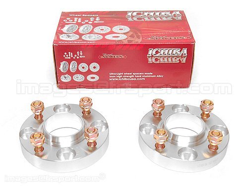

I was hoping to stay away from spacers, but right now these seem to be my best option:
These are 38mm thick (1.5"), and do have the hub centric 67.1mm.
I ran a set like this on my 2000 GMC K2500 to space the rears out to match the track of the front and they did work out well.
Thanks all, I appreciate your input and creative solutions!
Chris

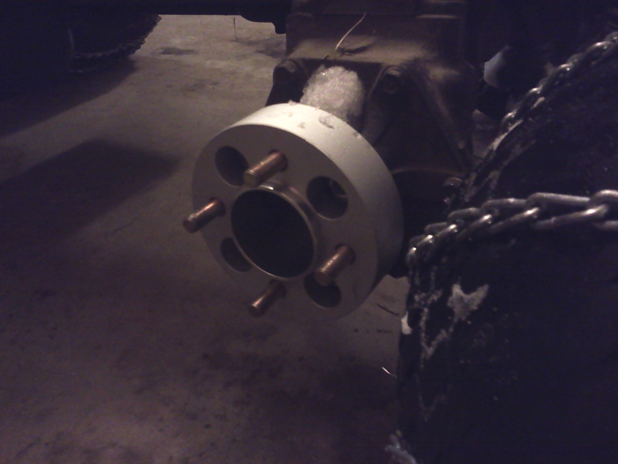

I wanted to update this thread now that I have installed the spacers and put a little time in on them.
-the correct hub size is 70.1mm, not the 67.1 that I previously mentioned (and ordered). After getting the correct hub centric spacer, all was good.
-I have about 200 pounds on top of my original counterweight... I think another 50 pounds or so is going to balance things out properly. Once I find my "ideal" weight, then I will start fabricating. I suspect that may wait until warmer weather (like JUNE!). I like the idea of loaded tires, but will wait until I get a second set to keep it "light" for mowing.
-the tire chains have made a tremendous difference in steering. That and the extra weight this year have made close quarter work much more predictable.
View attachment 352095View attachment 352096View attachment 352097
Looks very good Chris, and thanks for the hub spacer size and supplier name. I think I'll do the same thing.
Dan
