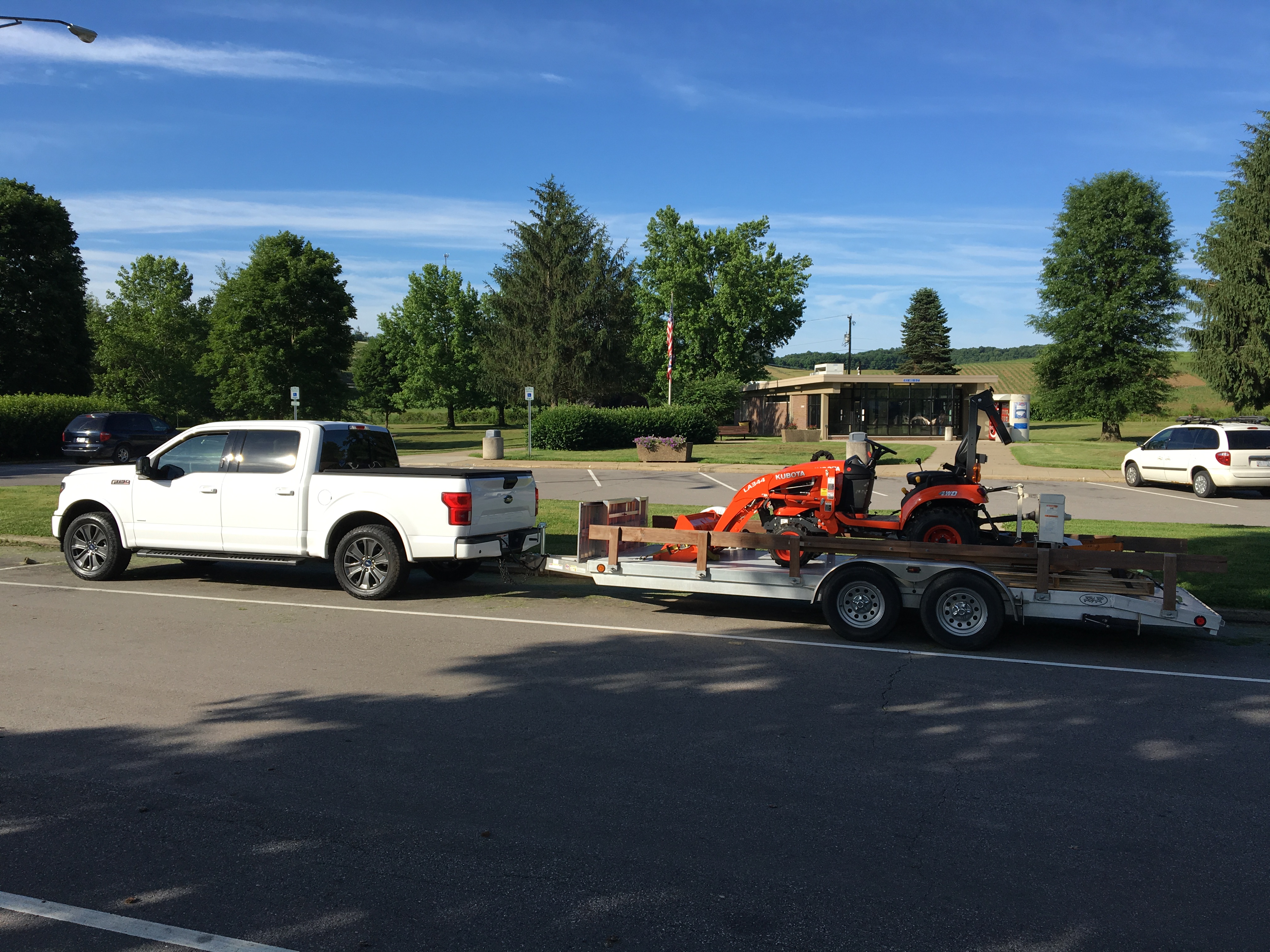

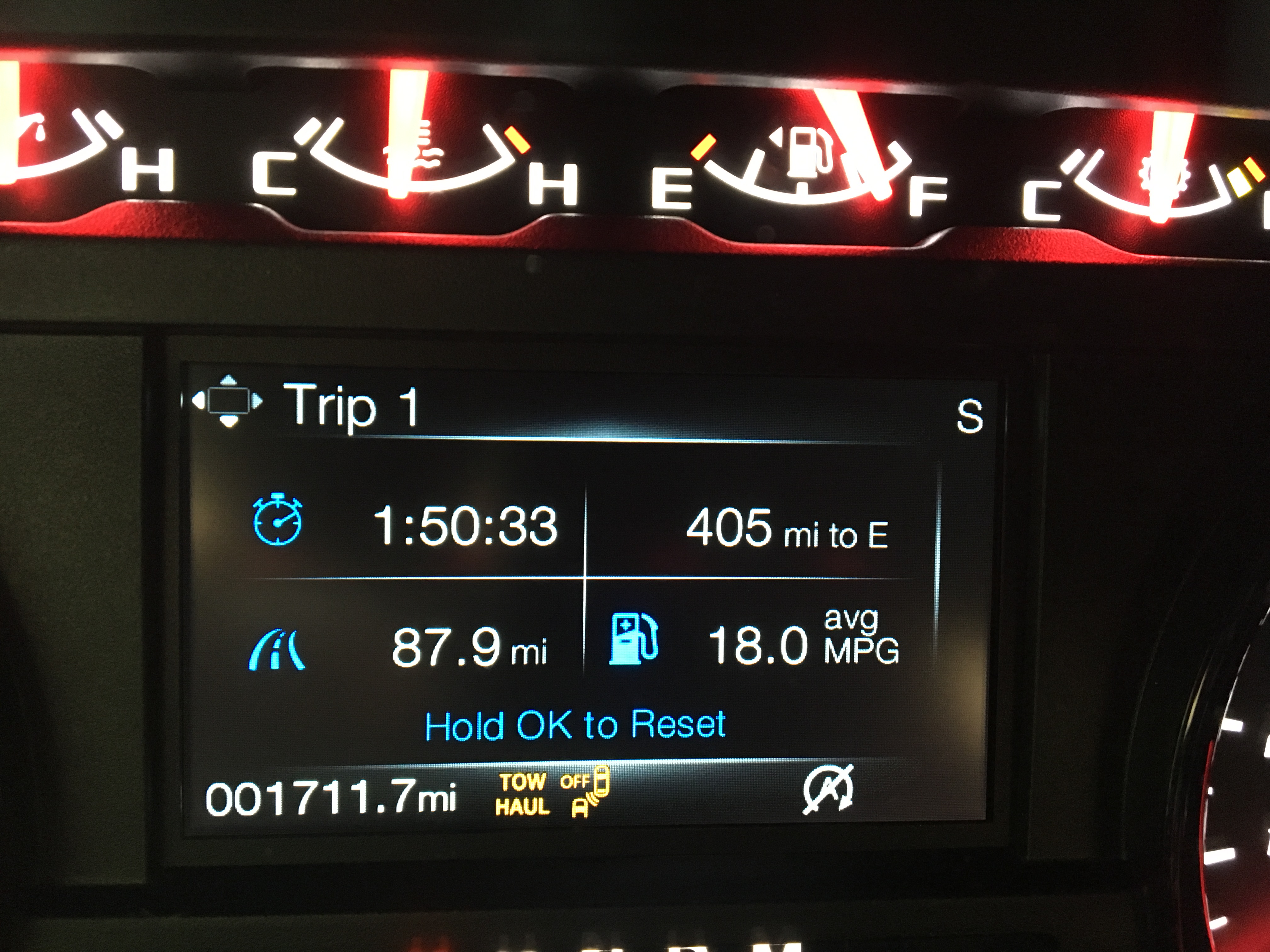

Here's a recent trip taking my tractor down to my camp in SE Ohio hill country. Trailer load was about 4500#, another 500-600# in the truck. Truck is a '18 2.7EB 10AT 4x4 super crew, 3.55 gears.
All the OEM integrated towing gear is awesome as well. Down right fun compared to towing 40 years ago!
