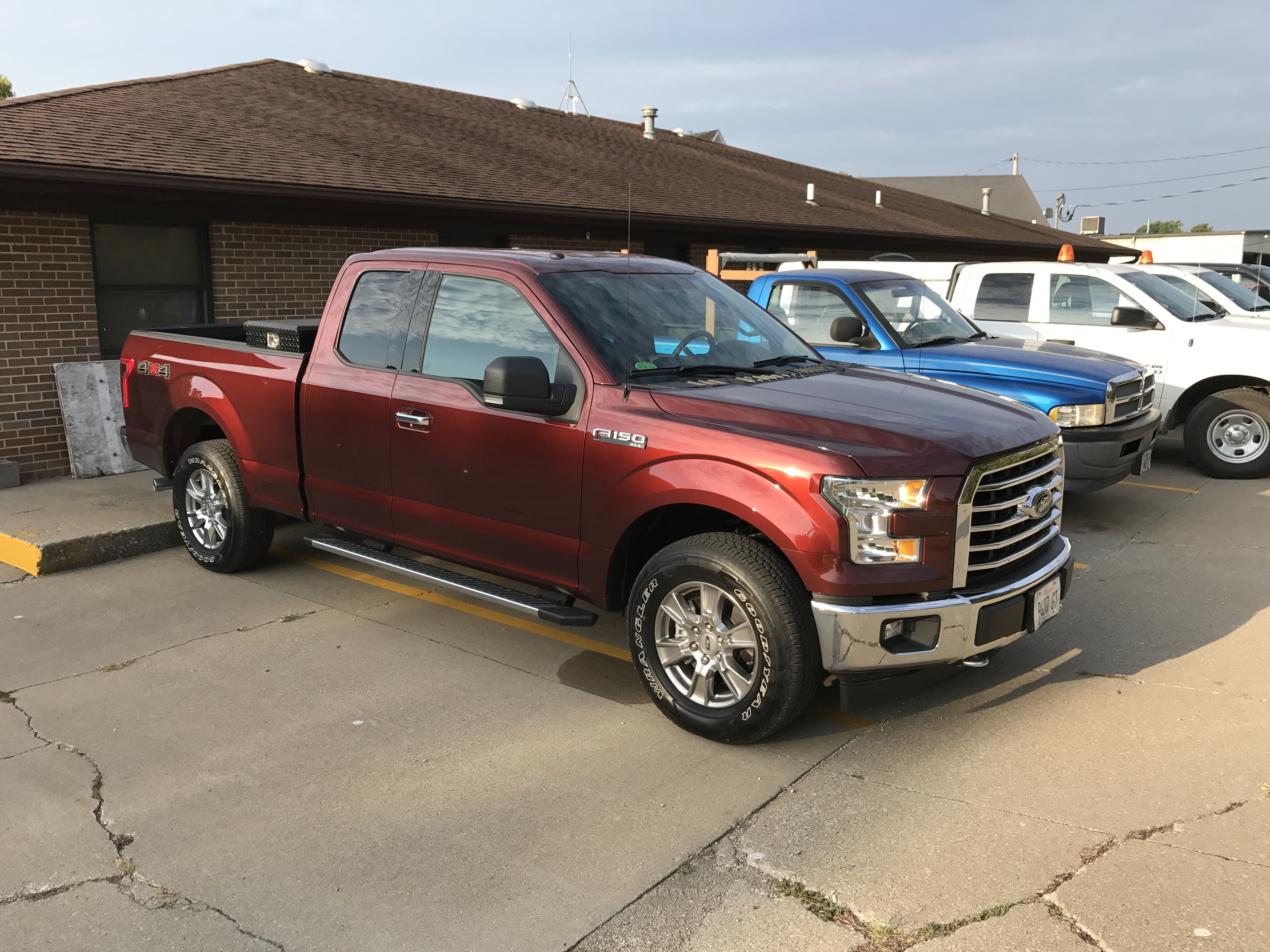

If I were buying, no doubt I'd pick the 3.5 turbo or the 2.7 turbo as my second choice. If buying used, I would make sure any 5.0 I was looking at was 2017 or older. The redesign they did in 2018 appears to be a step backwards with some oil consumption being the biggest issue.
My personal truck is a 2017 5.0.
