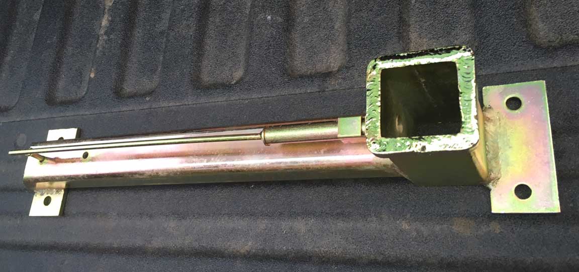

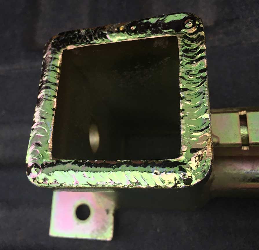

Had opportunity to include this in a plating project.
460211d1457500984-f150-front-2-receiver-hitch-f150_front_11plated-jpg
Well if we're gonna zinc plate this thing it can't just look like Harbor Freight. Decided to TIG the gap in on that cheesy HF doubler wrap.
460212d1457500984-f150-front-2-receiver-hitch-f150_front_12plated-jpg

Thanks IV Farms. Hope yours turns out good too.
SHINY!!!!

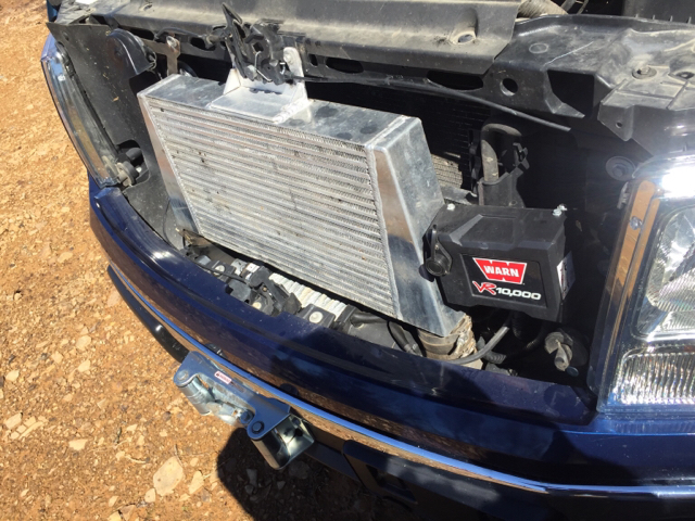

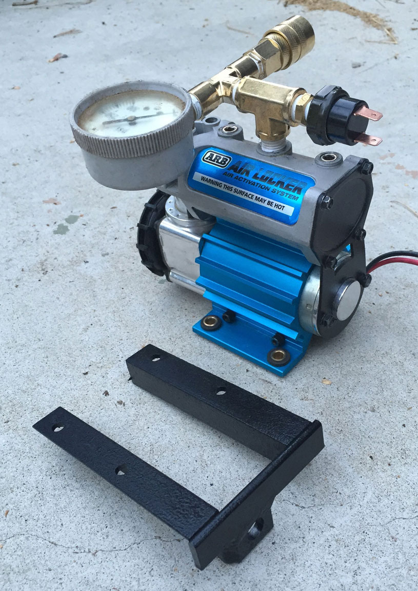

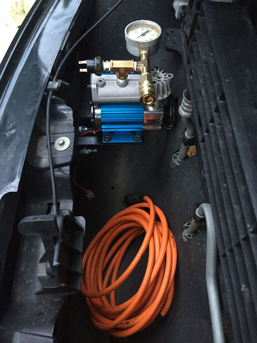

Thanks guys. There's so much space ahead of the radiator it's like a front trunk. So I mounted a 12v compressor in there. It's ARB brand, made for operating an air locker but it seems pretty stout. Wish I had a rollbar or some tank volume to pressurize. I think I'll make some kind of carrier for the hose and air chucks etc.
I want to put one on mine. As a Ecoboost guy I had to get creative!ImageUploadedByTapatalk1457537444.598433.jpg with all that space.
