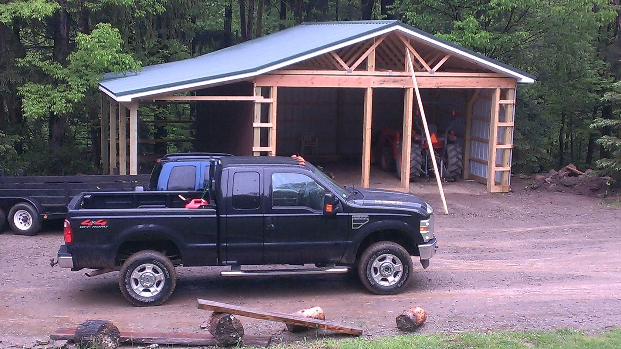

I have a 2009 F350 V-10 and I love it. I have 410 gears and a supercab. I don't put a lot of miles on and I average about 11 MPG all around which is great for the weight of the truck. If I drove 15K a year I would look for something with better fuel milage.

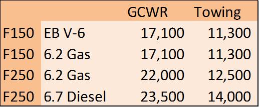

Took the liberty to look at the 2014 Ford Towing Specifications. Below are the maximum capacities possible with the configurations shown below. Please note these are maximums and are heavily dependent on cab style, wheelbase, 4x2 vs 4x4, gear ratio, etc. (One must really be careful how the truck is configured with the F150 to achieve these values)
Link to F150 Specifications: 2014 Ford F-150 | View Towing Specifications | Ford.com
The newer F150 with the "Heavy Duty Payload Package" seems to be very capable from "Fords" perspective.
F150 ecoboost is limited to 11,300 on the fifth wheel with both the max tow and max trailer packages required. The F250 6.2 is at 16,000 on a fifth wheel. Almost 2.5 tons difference.

You can tow 11,300 with a Ecoboost. You would be gaining 1200lbs with a F-250. Finding a Ecoboost on a lot equipped to tow 11,300 may be tough. I think Ford wants to sell a Ecoboost F-150 or a diesel Superduty.
Put a gooseneck in the F250 and tow 16000. 4700lbs.
