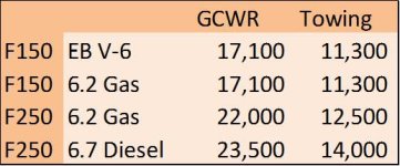

Took the liberty to look at the 2014 Ford Towing Specifications. Below are the maximum capacities possible with the configurations shown below. Please note these are maximums and are heavily dependent on cab style, wheelbase, 4x2 vs 4x4, gear ratio, etc. (One must really be careful how the truck is configured with the F150 to achieve these values)
Link to F150 Specifications: 2014 Ford F-150 | View Towing Specifications | Ford.com
The newer F150 with the "Heavy Duty Payload Package" seems to be very capable from "Fords" perspective.
F150 ecoboost is limited to 11,300 on the fifth wheel with both the max tow and max trailer packages required. The F250 6.2 is at 16,000 on a fifth wheel. Almost 2.5 tons difference.

You can tow 11,300 with a Ecoboost. You would be gaining 1200lbs with a F-250. Finding a Ecoboost on a lot equipped to tow 11,300 may be tough. I think Ford wants to sell a Ecoboost F-150 or a diesel Superduty.
Put a gooseneck in the F250 and tow 16000. 4700lbs.

Here are some numbers I found:
1) 2004 F150 5.4 V8 3.73 = 9200 lbs towing and GCWR 15,000 lbs
2) 2014 F150 Ecoboost 3.73 = 11200 lbs towing and GCWR 17,100 lbs
3) 2014 F250 6.2 V8 4.30 = 12,500 lbs towing bumper pull, 15,000 lbs towing gooseneck/5th wheel and GCWR 22,000 lbs
Anticipated max towing at 11,500 lbs. F150 curb weight approximately 5600 lbs. Looks like this would put the F150 at it's max and maybe a little over.
These numbers look about right?
   / F250 6.2 V8 vs F150 Ecoboost #34
You really ought to put the trailer/tractor combo on the scale and see EXACTLY how much weight you are REALLY towing. Not guessing.
My current tractor with heaviest single implement weighs around 9000 lbs. I use a 82" x 22' 12K bumper pull equipment trailer when I move it. Total combined weight of tractor, implement and trailer is approximately 11,500 lbs. I don't know the exact weight on the trailer but estimated 2500 lbs. I usually tow this set up three or four times each year approximately 30 miles to the hunting lease. My current daily driver and tow vehicle is a 2004 F150 with the 5.4 V8 and 3.73 gears. I am not currently in the market to buy, but like to plan ahead for major purchases. I have been torn over whether to consider a F250 for my next vehicle or stay with the F150. I typically keep a truck 10 years so want to make the right decision. I like the idea of the diesel, but see them as too much maintenance and cost. I currently get around 14-16 mpg with the average closer to 14 mpg. I think the F250 gas burner would be very close so mileage not a deal breaker. Curious to hear thoughts on this and why.
