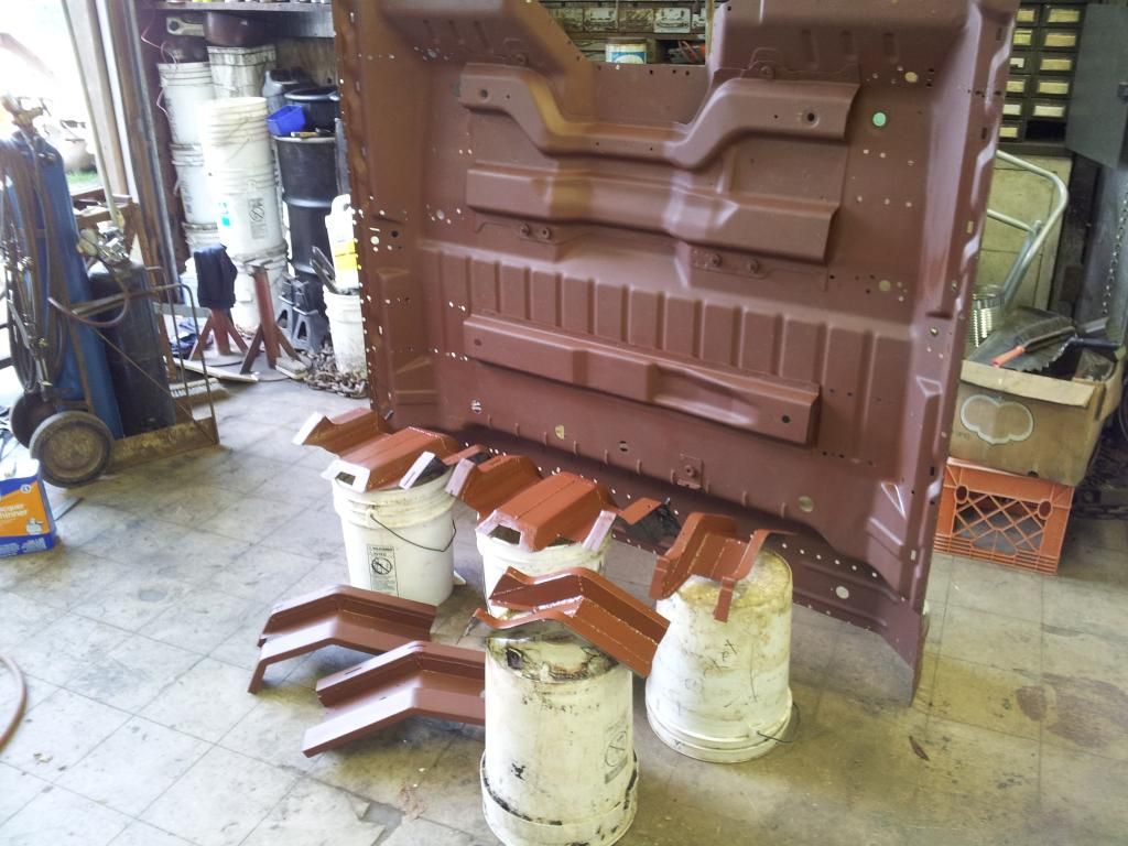

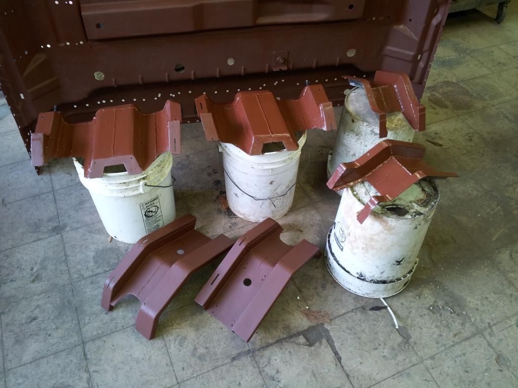

Spent all day cleaning and sanding sheetmetal parts. Inner rocker panels and cab corners stripped of all paint/primer. Did a little hand sanding on the inner cab corners, and peeled the lables off the rest of the parts... wire wheel seemed to strip the paint easily enough on what I cleaned up, then hand sand with a scotchbrite pad, clean with lacquer thinner, then prime.
All cleaned up...
Primed with self-etching primer
Remember the 'Where's Waldo?' books? That's the 'Where's the inner rocker panels?' picture... shop is a jungle!

Just wondering if a weld thru primer would be a better option? You could prime then weld into place and retouch after! Just a thought.

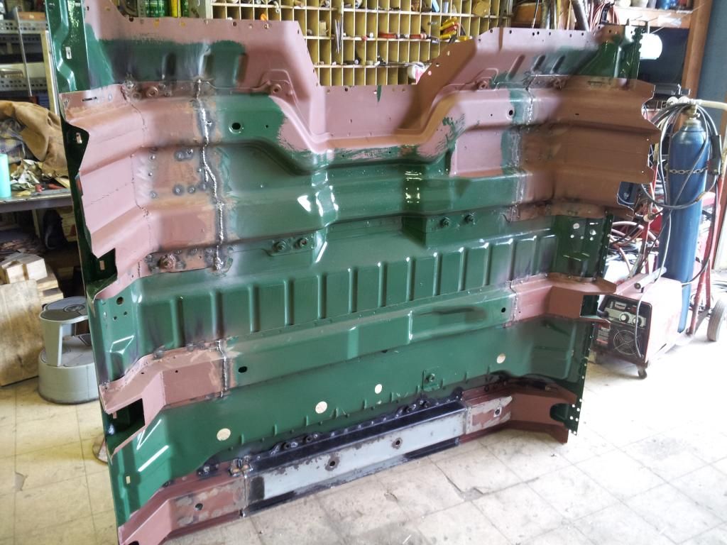

I plan to prime, top coat, fit in place, mark weld spots, sand thoes spots, then use weld-thru at the weld locations. Then follow up by touching up heat damaged areas. I have been using weld-thru primer as needed thru-out the project, but sparingly.
Today I sanded more panels, and primed, then top coated what I could. After lunch I got the floor pan sections over the front cab mounts ready to weld back in, then welded them and all the spot welds across the back of the cab and trans tunnel.

Finally feel like I'm making progress. Got the pass side inner rocker panel welded in... almost. Was nearly done when I ran outta MIG wire. So I spent some time prepping the driver side for when I get wire (tomorrow AM) and went home an hour early.
