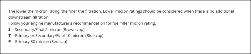

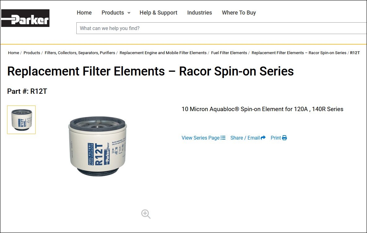

I would check Facet brand small 12V fuel pumps for replacement if new pump was ever needed.
The original fuel pump has been perfectly adequate, and in F3060 it's easy to check the excessive fuel flow returning back to the fuel tank, but I have only checked it with the engine idling.
I just did over two hours of mowing yesterday and it worked fine.
PS.
It's easy to switch to Racor 12T (10 Micron) if pump capacity ever became a problem.

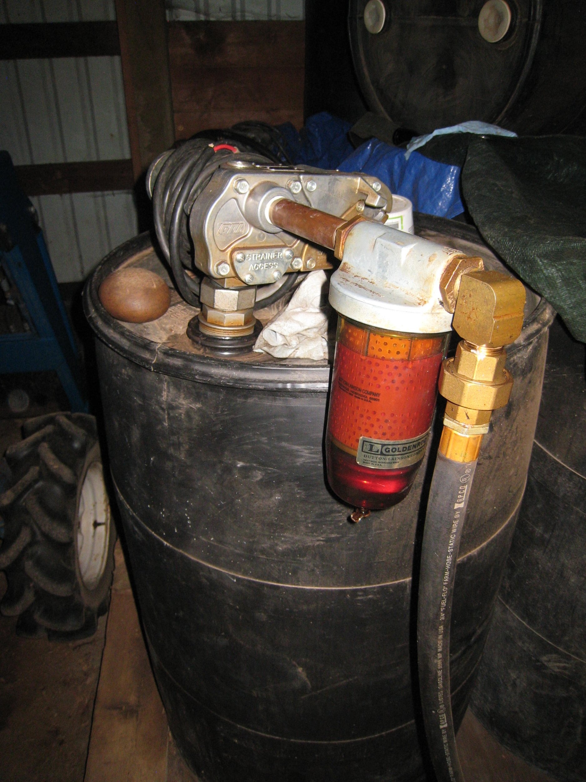

I like these spin on filters you guys have plumbed in (y)
I run a 10micron 3qt spin on filter with hydroZorb membrane for moisture on my 550gal tank.
Both mowers & 3 tractors gets filled from this tank weekly.
This setup was EXPENSIVE but I hadn’t replaced a fuel filter on any 5 units in 4yrs.

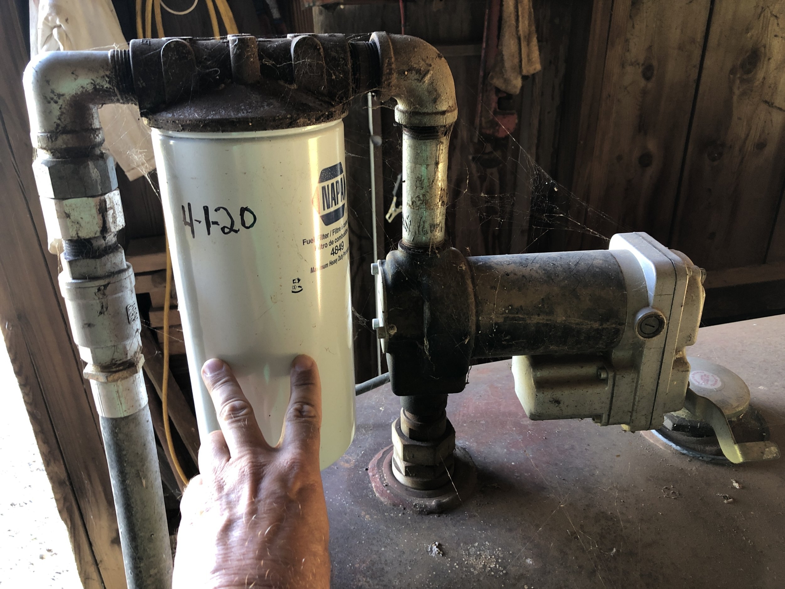

This setup was EXPENSIVE but I hadn’t replaced a fuel filter on any 5 units in 4yrs.View attachment 861655
I see you have some galvanized fittings on your setup. I've read that galvanized fitting will shed the galvanic coating over time and will adversely impact high pressure fuel pump performance.
   / F3060 2 Micron Racor installation #19
It’s possible.
The fittings on left side is aluminum.
