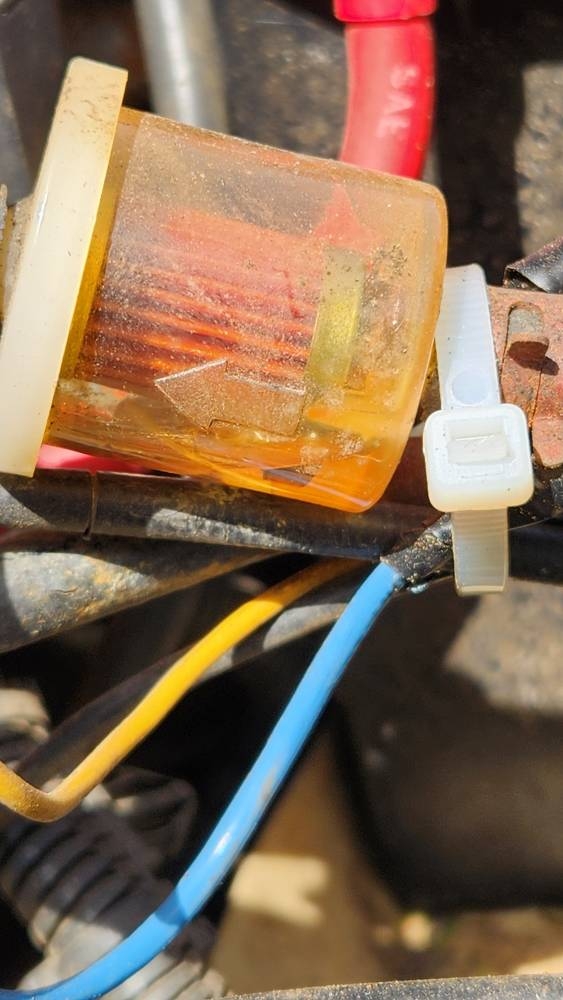

   / F725 fuel pump
I replaced the fuel pump, mowed yard for about a half hour and it sputtered and died, it started back up mowed for another half hour, the same thing. Started back up and once it started sputtering I put it up to full choke and it ran fine. Attached is a picture of the fuel filter that hardly has any fuel in it while the tractor is running. I've never noticed in the past how much fuel is in there while it's running.
   / F725 fuel pump #9
Do you have the filter placed in the correct direction of the fuel flow ?
   / F725 fuel pump
Yes, I did not have to remove the filter in order to replace the fuel pump,
