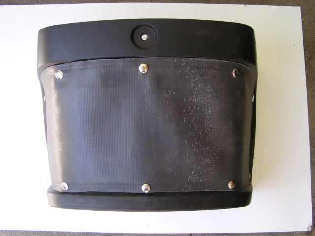

Another question comes to mind after reading some posts. Does the Curtis Cab come with interior liners to seal the open area behind the seat, and to plug the radiater fan from sucking all the warm air out of the cab below the steering wheel?
   / Factory Cabs for BX and B Series #13
</font><font color="blue" class="small">( Another question comes to mind after reading some posts. Does the Curtis Cab come with interior liners to seal the open area behind the seat, and to plug the radiater fan from sucking all the warm air out of the cab below the steering wheel? )</font>
Yes to both! The one for the radiator fan mounts with velcro which is held on by tape, though, and I found it didn't work great. I bought some do it yourself snaps and fastened them
on and it works much better.
Here's a picture of what I'm talking about.

Thanks for that pic!!! I couldn't determine what that extra piece of material that came with the cab for my B2410 was for- now is is clear!! The 2410 is built differently and there is solid plastic below the steering wheel, so I don't need it but I can see it would be essential on a BX.
