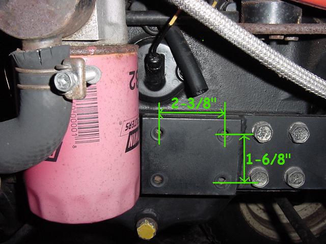

hummm..pic didn't post. second try
/ factory loader #YFL800
#12
well, pic is not wanting to post so left to right is 2 3/8" center to center, top to bottom is 1 6/8" center to center

Taylortractornut:
OK, next day and I'm going to try and give you a pic, see if they have gotten the site all running smooth now
