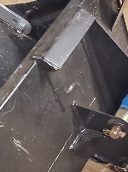

Ironically, I just started this weekend building it. It's actually going really quick and I'm super happy with how it's turning out so far. I will send some pictures later today or tomorrow. I'm basically cutting off the brackets from the bucket. Then reusing them; as part of reusing them it worked out perfect that the pieces I cut out to clear the brackets get reused for braces. Basically all you will need is some SSQA brackets, a piece of 2 in. square stock about 34" , and a few miscellaneous pieces of steel for reinforcements. I'm doing the whole thing with a 4 1/2 inch angle grinder, tacking it together with my mig welder, then picking up a use stick welder and I'm going to practice my skills.

Joe Tool, makes sense, good luck with the build. I was hoping to find SSQA brackets that were 7" wide at the top 5" wide at the bottom so I wouldn't have to cut the hybrid bucket at all. The standard SSQA adaptors looks to be 17" tall, I just measured from the inside of the lift triangle on the hybrid bucket to the protector plate below the pin hole at 16 1/2", the standard bracket may not fully engage unless the pin engagement length is adjustable or you cut a hole in the protector plate.
Really curious to see how yours works out. I did see a video online with an old Ford, same process you are undertaking.

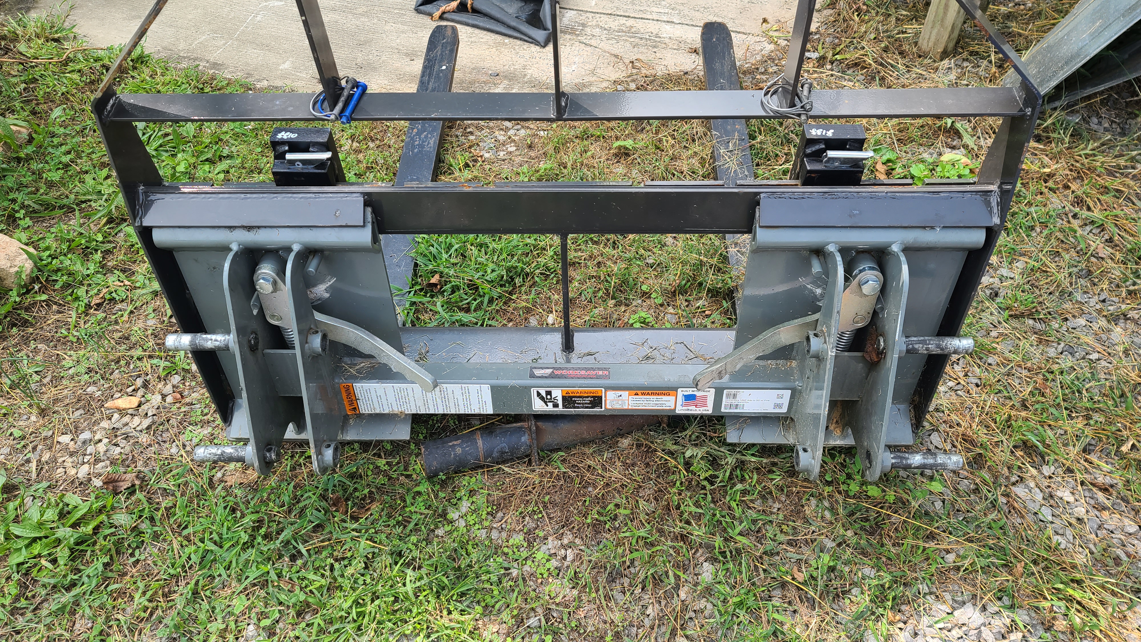

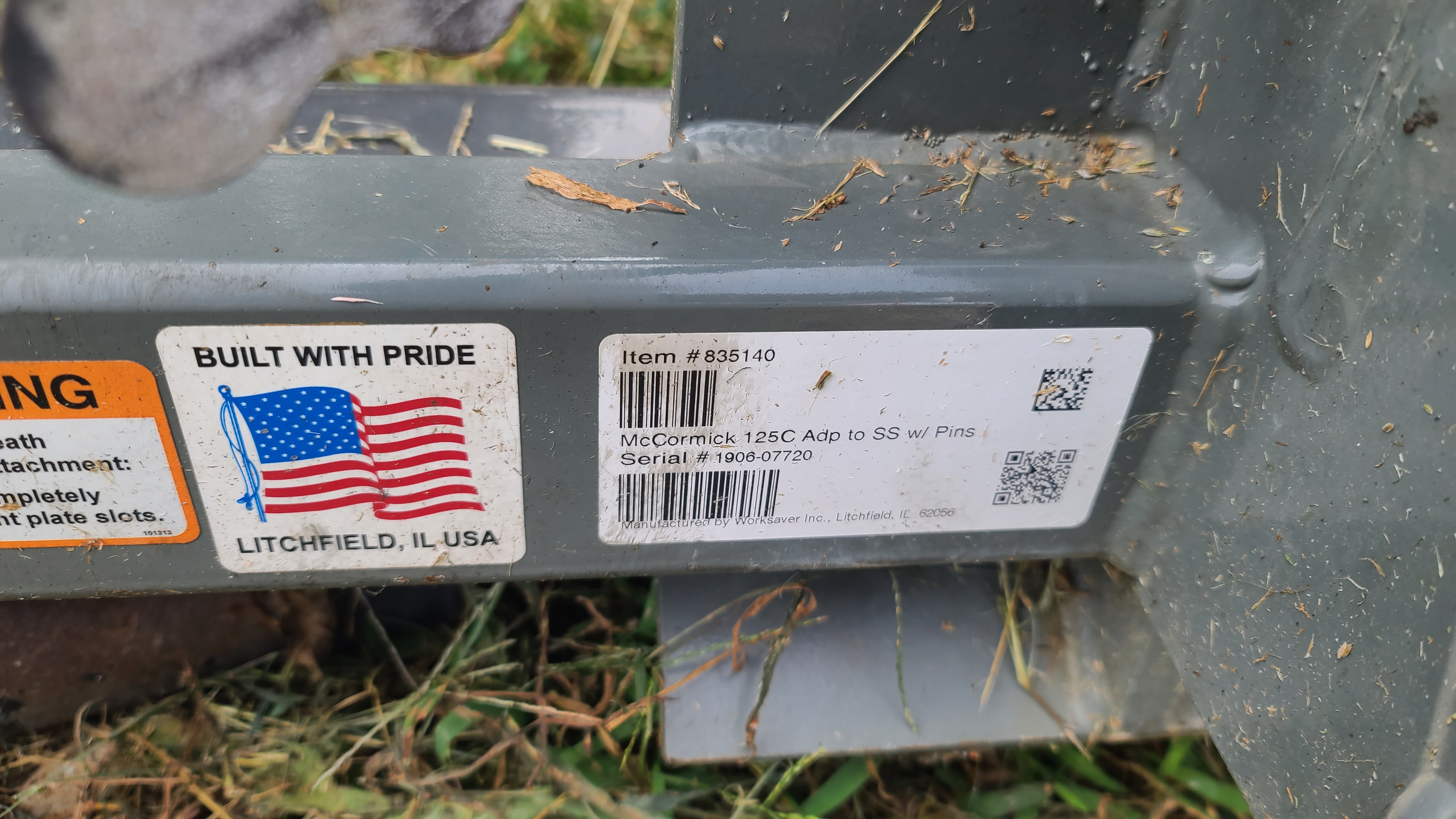

When I bought my LS125, the dealer sold me an SSQA adapter ... mind you, this was before this LS Adapter ever existed. I use it for standard SSQA attachments all the time, but was hoping that the new adapter would be able to be used for the stock bucket and all other attachments. Has anyone actually confirmed that the LS adapter is a mini skid steer sized plate?? Because, if it is, it would be great to know and would open the door for a lot of attachments. Does someone have the complete dimensions of the adapter? Did I perhaps miss that post? I am attaching a couple posts of my adapter I was sold by my dealer.
   / Factory SSQA For MT-125 Coming? #30
View attachment 669749View attachment 669748
Yes, I can confirm. I bought an LS MT122, with Factory SSQA bracket. It is Mini SSQA. As you point out, you can get 3rd party SSQA, like the one you picture, but now your bucket won't fit. Your dealer might swap the bucket for a XJ2025 bucket. My dealer offered to do that. I chose not to go down this path due to the weight of the bracket and the XJ bucket.
