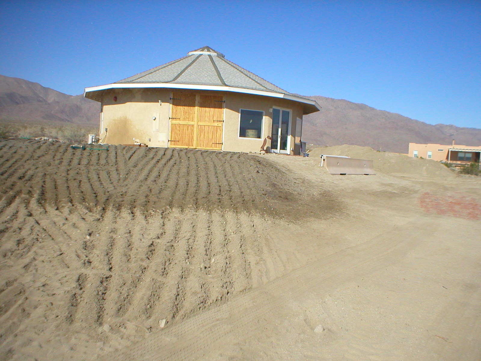

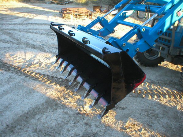

Ken, if you roll the bucket back so that the teeth are up off the ground, you then use the back of the bucket and have a smooth flat surface. I actually like back dragging with my toothed bucket and using the teeth, it then disperses the uneven ground evenly.

I see you back drag with the bucket teeth. Would like to do that with mine as well. No probems with tearing up stuff?

None as of yet,:D but you need to realize that the bucket is only tipped (dumping) forward 10-15 degrees. I do not have the teeth straight down.
There are many ways to use the loader for back dragging, but you will find that most of the loader manufactures suggest that you never have the bucket at more than a 15 degree angle while back dragging. As has been said before, look at an industrial machine vs our farm style machines, they are designed differently. An example would be that our 580 Case has the hydraulics retracted (collapsed) when the bucket is dumped, the opposite of what all of the AG tractors have.
