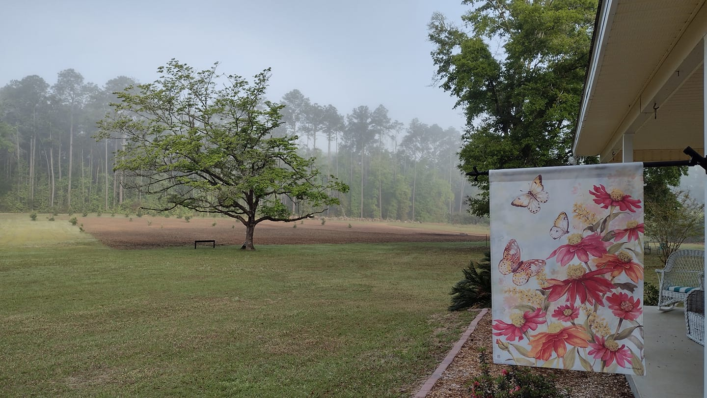

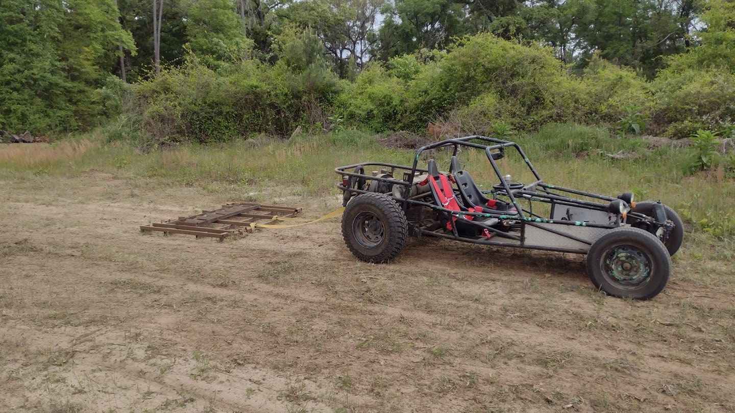

I've been trying to convert a forest into a mowable field for the last few years. It's coming along but not where I want it yet. I bought a tiller to work on it some this year. It already has grass established so I end up having to mow then till that. Having the clumps of grass makes working the soil level a chore. I will have to let the clumps die down and probably rake them out before I can effectively smooth the ground.
I till in several different directions then follow up with a homemade drag. I mow with a finish mower behind my JD4310 so my target smoothness is being able to drive wide open in mid range without having the seat bottom on the bounces. :) That will allow me to mow at the fastest speed the mower can cut without having to slow down.
I will probably end up having to top dress to get it where I want it but that would cost more than killing the existing grass and letting it grow back.
Hooked my drag to my rail buggy and pulled it around yesterday. Might as well have a little fun while I work.
