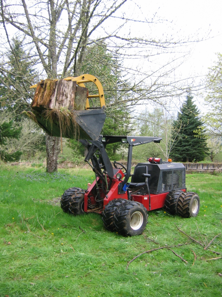

Toothbar and Grapple are on my system... My first technique was to raise and lower the mower. That met with some honest responses about safety. So I went to the grapple but it had limited reach. Went to the backhoe, it is pretty narrow and the work time is longer...
The rake is also to try and get into some ravines. I can take the bucket to the edge of a ravine, but I still have a wall of blackberries... at least out for another 6 feet or so...
Well, wife will consider my purchase of some more beefy angle iron and landscape rake tines ( Heavy duty $5.99 each). Problem is I have to go back to LA so this is going to have to wait...
Carl

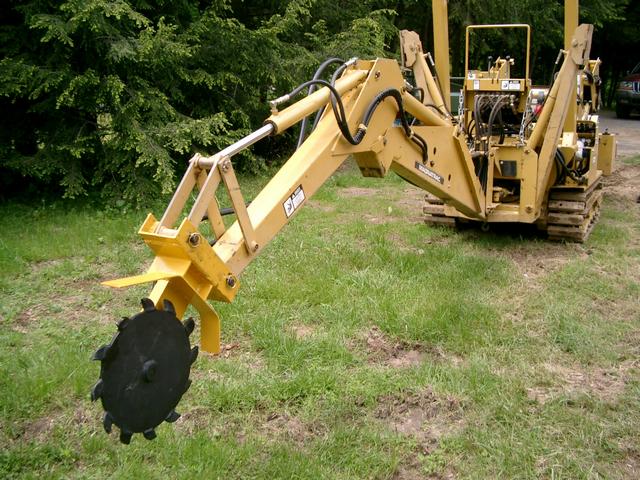

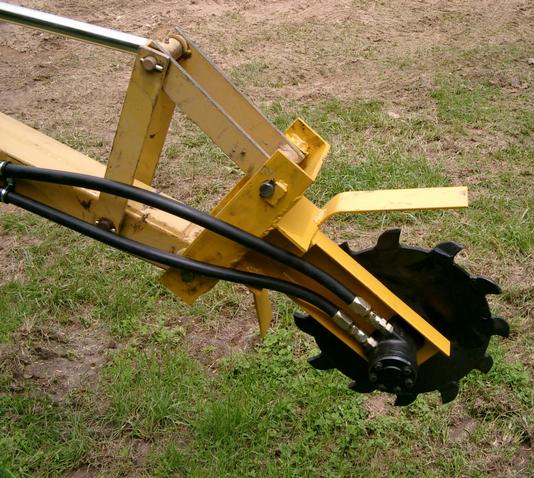

So if a Power Trac knuckle boom is out of the question... maybe what you could do is build something similar. Get yourself a hydraulic motor and attach a large circular saw blade and mount it on your boom. If you made the bracket for the cutter head able to turn, then the blade could be used vertical or horizontal depending on your situation.
I made something similar a few years ago to attach to my backhoe using a cutter blade and hyd motor purchased from Power Trac.
