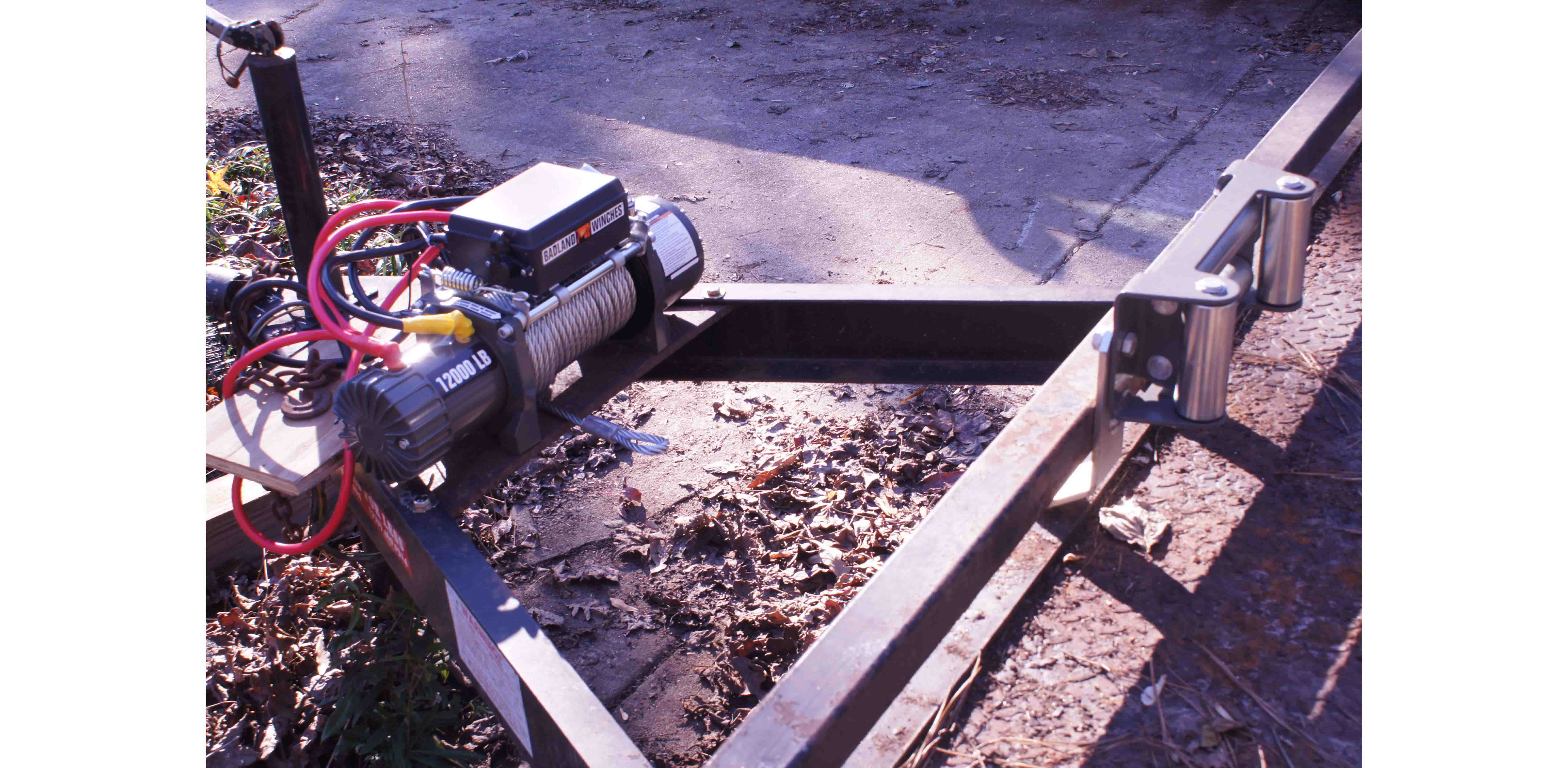

#15
View attachment fairleadw.jpgJust a photo of how I mounted the fairlead and the winch. The metal plate I had for the winch was not very long so the winch is closer to the front of the trailer than what I had really hoped for but it does allow the cable to completely clear the tire stop bar when threaded through the fairlead. I have only off loaded a small car with the winch, got it on the trailer with a hand winch and a come along and that effort convinced me that a powered winch would be better. So I don't know how well the cable will spool back in when pulling a significant load onto the trailer but I think it will be fine. Just handheld the cable with a rag when rewinding this time.
Well it seems I cannot upload a photo for some reason. Believe me it is about this far apart .....
