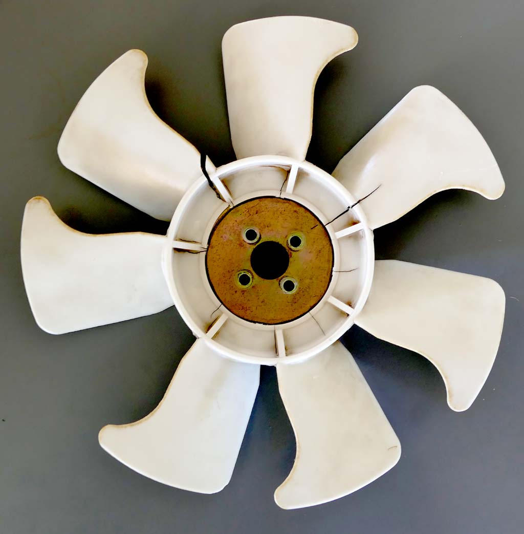

I had a plastic fan blade failure on my old LG (LS) 47hp. Tractor had done less than 1000 hours, but was able to get a new one from Korea (vis the Australian dealer) in about 10 days, for not a lot more than AU$100 delivered, so pretty happy with that service and price. Old one just was falling apart:

I'm just so pleased that I saw the deterioration in time (refer photo posted earlier on the LG fan). The damage to the radiator would likely have been severe had it disintegrated!
And thinking back, it was a really tight fit replacing it with the new one. That's when I bought a set of ratchet ring spanners!!!
