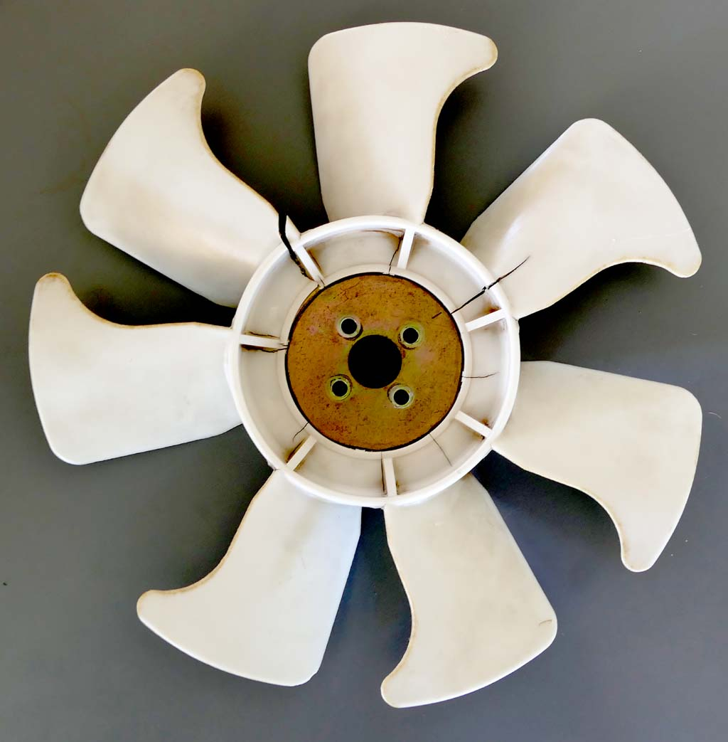

I had a plastic fan blade failure on my old LG (LS) 47hp. Tractor had done less than 1000 hours, but was able to get a new one from Korea (vis the Australian dealer) in about 10 days, for not a lot more than AU$100 delivered, so pretty happy with that service and price. Old one just was falling apart:
Thanks for the pics....I'm at 800 hrs now. So my inspection routine will now add a closer look to the fan.
After several pasture jobs I normally take the time to use simple green to clean the blades.
It just never occurred to me to look for this.
Shoot even an obvious crack like in the pics would probably get overlooked.
While washing and cleaning, the old gray matter is focused on what the next honey-dew on my list and would clean miss it...!!

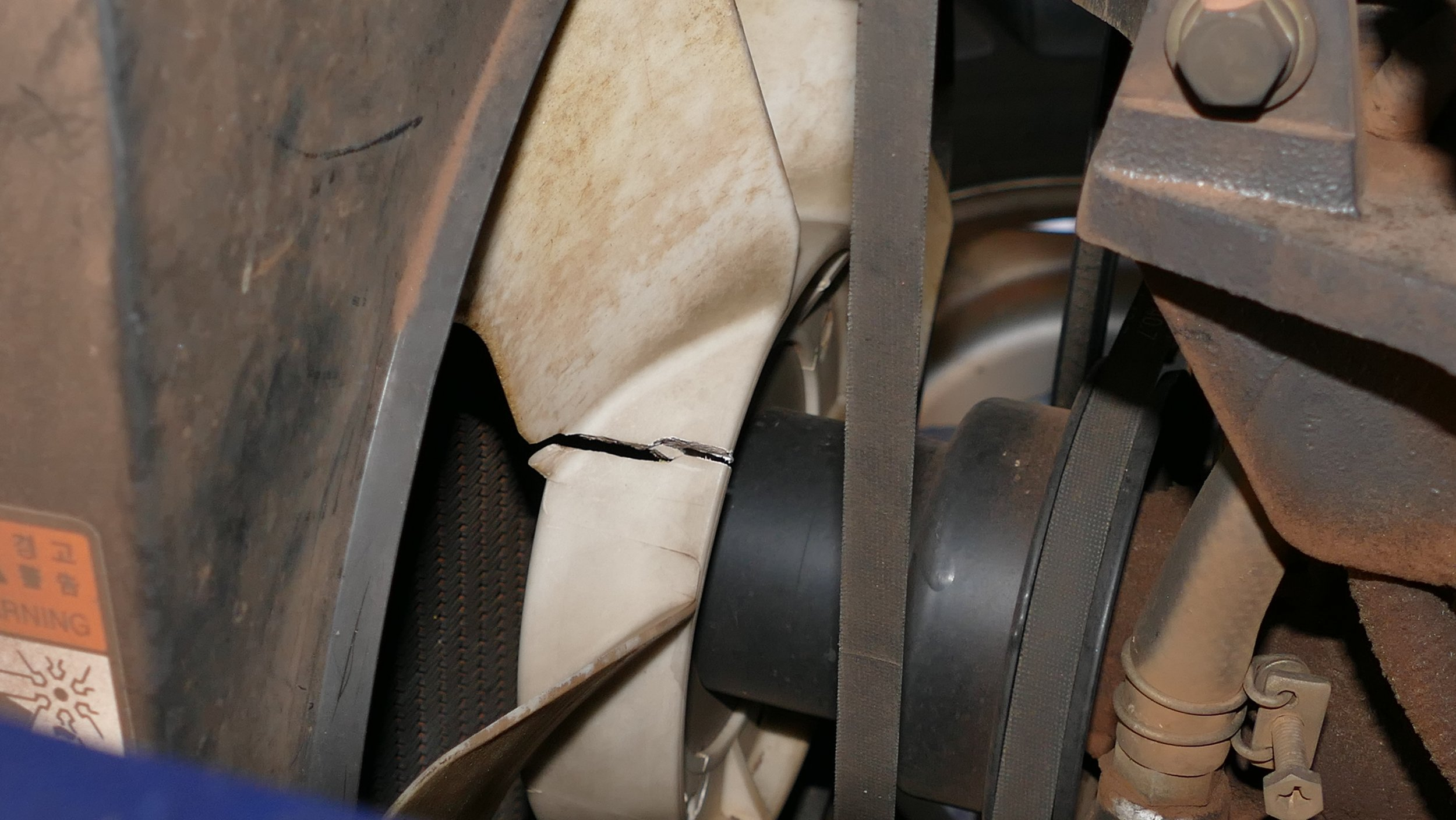

I agree that plastic can become brittle after time but less than 400 hours? It does get pretty hot here in the summer. 100 plus with humidity around 80 to 90%. Makes it feel like 115-120. But this summer wasn’t too bad. Only a few days like that. And we really haven’t had a cool snap yet. Until today. Never got out the 50s. Reckon four years could dry rot the plastic. And there’s two fins I still haven’t found. Just lucky it didn’t mess anything else up. New one should be in by tomorrow and get it back going Sunday or Monday.
There could have been a material defect, I dunno, but I've seen plenty of engine-driven fans self-destruct. Electric motor fans, not so much. Anyway, yes, it is good that the busted bits tangle with your radiator or dance with a belt.
