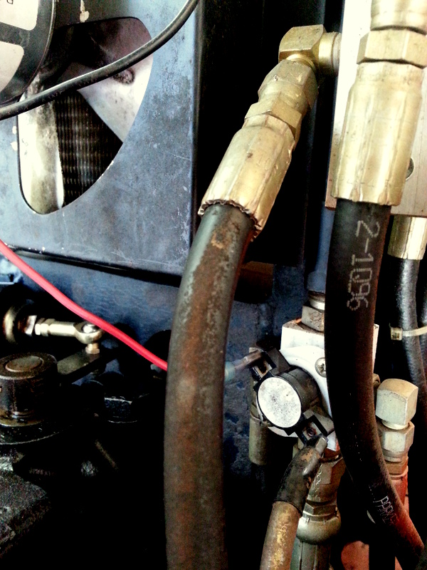

I have been slowly doing maintenance to my PT getting it ready for spring. I Just cleaned out the gas tank and installed new filters and gas hose. I am cleaning the carb and have a new fuel pump on the way. Also just bought a new marine water separator with filter the same setup that came with the Kohler. Of course could not get the original they stopped making them but the new one works perfect.
I have been watching for the hydraulic cooler fan to come on while the tractor sets idle. So far have not seen it kick in. How long before it is suppose to come on after the engine is running idle?
I hooked the old fan up directly to make sure it still works. It does so if it's not coming on guessing this is the thermostat and I will need to order a new one..
How many of you have just wired the fan up directly so it is always on.. I would think the fan would burn out quicker this way but would keep the hydraulics and engine cooler thinking I like that idea better.
Any one done this and how did work out. Not sure where I can get another fan, my guess I will have to modify with an upgrade this one when it burns out..

The hydraulic fluid may not get hot enough to need the cooling fan when at idle. Working the hydraulics should warm the fluid up and you can test the temp sending unit to see if it is still working.

I checked it after using it for a few hours lifted the steel lid and it was not spinning. Not sure if it had been running and cut off or not wouldn't be able to hear it with the tractor running.. Not a big deal though, as long as I know the fan still works. I'm sure I can find the part somewhere.. Thanks for the reply

Maybe hit the sensor with a heat gun?
I took apart the wire connectors and they were fairly loose. I cleaned them and put them back on tight. Waiting on a fuel pump right now as soon as I get her back up and running. I might try that if it still does not come on. Thanks..

I have the subaru engine and the White Rodgers heat relay opens up at 110 degrees, I think. To run the fan continuously I don't think would be a good idea, because that oil temp has a sweet spot. Being too cold causes more friction, so the oil heating up isn't a bad thing. So having the fan turn on at the right time according to how the engineer designed the hydraulic system would seem the way to go, to me.

Find out what the working temp is and get some water, heat it to that temp and see if the thermostat conducts electricity, if so then it isn't the it.
Then find out working temp of oil, see if it matches the working temp for the thermostat.
Why buy new if what you have is working.
Also, if the working temps of the thermostat and the oil are not matched or you want to lower the on temp, then consider getting a thermostat with a different working temp range.

If you are concerned that the fan is functional, you could always bypass the thermal switch to see if the fan comes on.

Since you know the fan works when connected to 12V and doesn't work when connected to the thermostat, and depending where the fuse is in the circuit, of course (you checked the fuse, right? :) ), then you're correct that the thermostat is most likely the problem. When mine was working it would always come on about 20-30 minutes after plowing snow, which was rare with the PT because I was usually done in 10! :laughing:
I noticed my thermostat stopped working about 3-4 year old. So I just hook it to 12v and start the tractor and go in warm weather. I don't bother with it in winter. Some day I'll put it on a switch.
I also tied a 6" piece of orange caution tape to the fan shroud. When the fan is running, it blows up and I can see it on.

Fuse is good, need to try the orange tape then drive it around.. For now waiting on a new fuel pump will here by Friday.. Didn't realize until I read all of the comments that it takes that long to come on. My last PT didn't have a cooler. Good tip on the tape thanks..

Thanks Ponytug first thing I did, it does come on.. :thumbsup:
