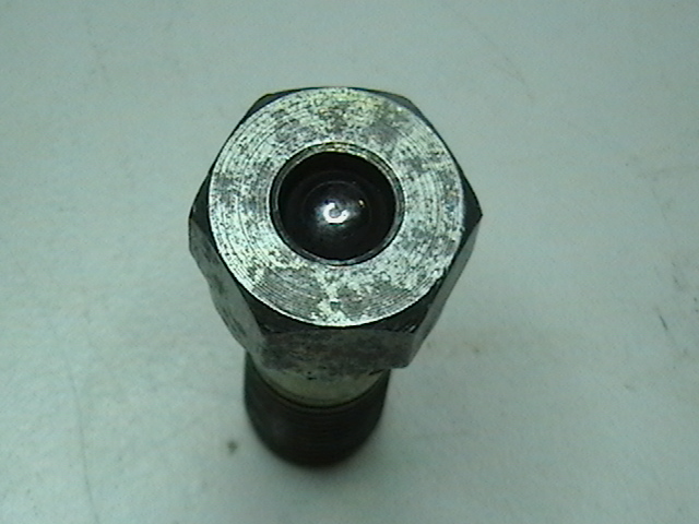

Hi I have a farm pro 2420 the has always run great. I put some new Fuel in it the other day and now it stalls out. It just chokes and stops. it all happens very fast. when you wait for a few mins it will restart. I put #2 diesel in it becouse it was all that i can get around here. does anyone have any ideas for me i am going to go check filters in a few mins.

You did not answer Gregs question? We need the full story to know were to start to help you.
Did you run it out of fuel?
If not is the fuel bowl clear?

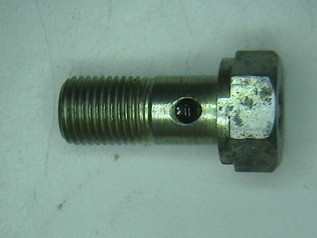

If not shut the fuel off at the fuel bowl, remove the black rubber hose from the bottom of the injector pump. Its a banjo bolt. There should be a screen in there as a last filter. Now using a clean jug put the hose in it and turn back on the fuel. It should flow about 1 qt per minute. If not you have either a blocked in the tank filter that is mounted as part of the fuel shut off or you have a internally collapsed fuel hose.

The cracked sediment bowl may have permitted air to replace fuel in the fuel filter. This is especially true if the in-tank screen is fully blocked. What's filling the fuel bowl may have drained backwards from the fuel filter. When you remove the sediment bowl from the tank, that little screen comes with it. Unfortunately, that means draining the tank first. Regardless of what else you find, the bowl needs to be replaced (I have a spare here if you can't find one locally).

Ok i have the new fuel Filter on and everything is back together. I have checked all lines filters all of it looks to be in good shape.
It runs fine for a while get hot and stops.
Still acts like it is a fuel problem, but i am not a mechanic.
Will getting it to hot make it act like it runs out of fuel?
