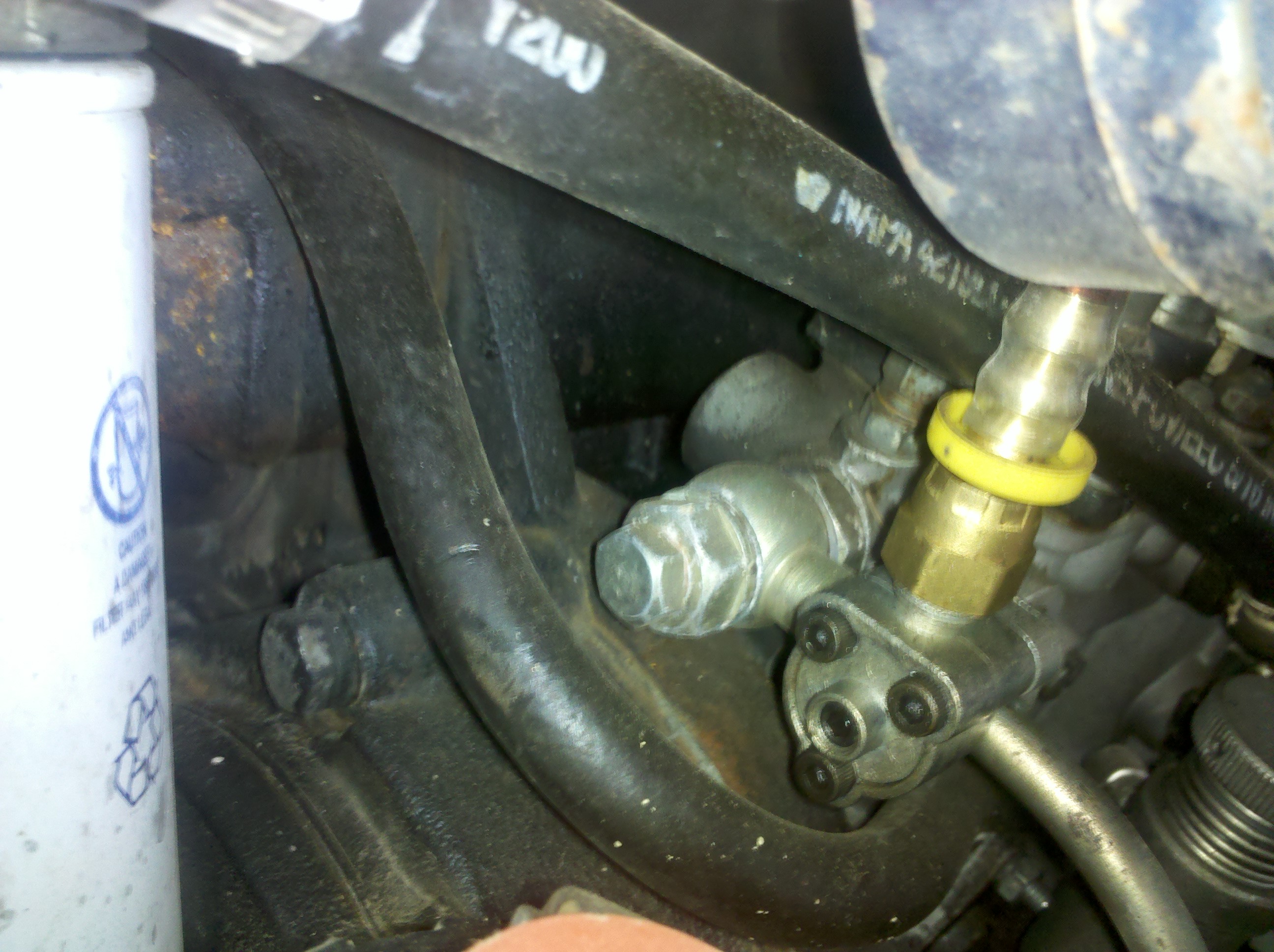

Not the answer I was lookin' for. My question was "where is this PRV on a Chinese tractor fuel return line"?

In this application it is not a "relief" valve but a regulating valve (semantics, I know). It maintains around 20 - 40 psig in the fuel cavity of the fuel injection pump. As I said before, it is the b-bolt that connects the fuel return line to the fuel injection pump (there is one line going in and one line going out. I will take a picture of it on the tractor tomorrow.).
I apologize for the late reply Greg, plate is very full for awhile. Anyway, this is a pic of the adjustable Pressure Regulating Valve on my TY395 fuel injection pump. On this particular installation the return line was plumbed back to the lift pump suction - not a particularly good idea - was aerating the fuel and building excessive pressure.

Ok, I understand now. Post-purchase mod with aftermarket parts. Or else it's a dozer thing, on which I readily profess ignorance. Cuz none of my four Chinese tractors came with any external brass fittings connected to clear vinyl tubing.
Forget about that part. That is a return-to-tank line I installed to prevent areation of the fuel. I'm referring to the banjo bolt with a plug in the hex to the left. The clear vinyl has since been replaced with regular fuel hose.
