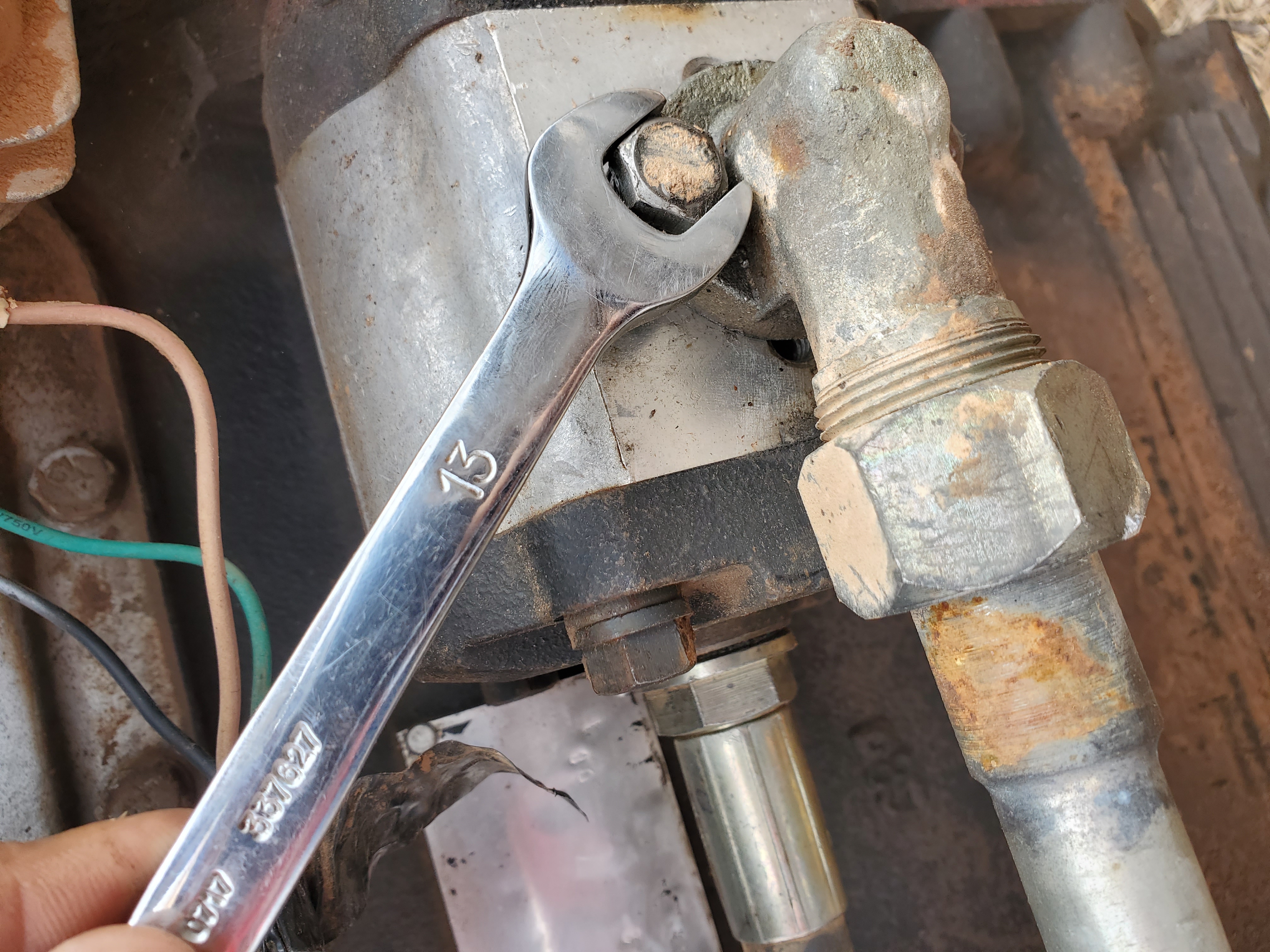

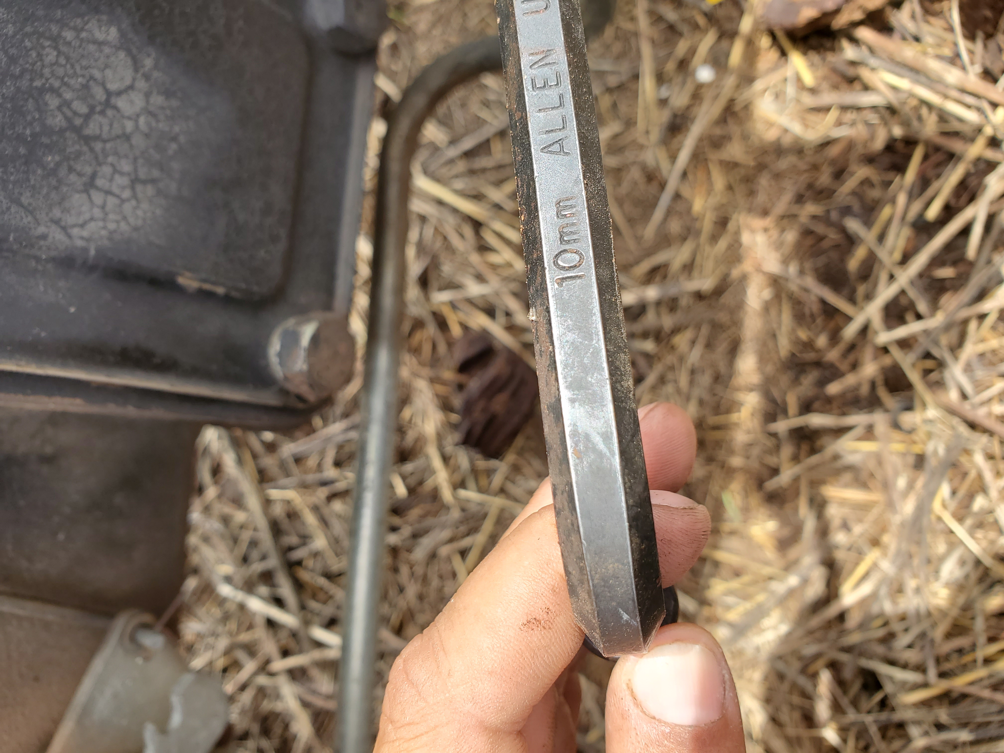

So before i forgot i wanted to share a few videos so future people can look and maybe it'll help them out with the starter. Take them with a grain of salt, tractor is in the field and I don't have a pretty shop lol.
