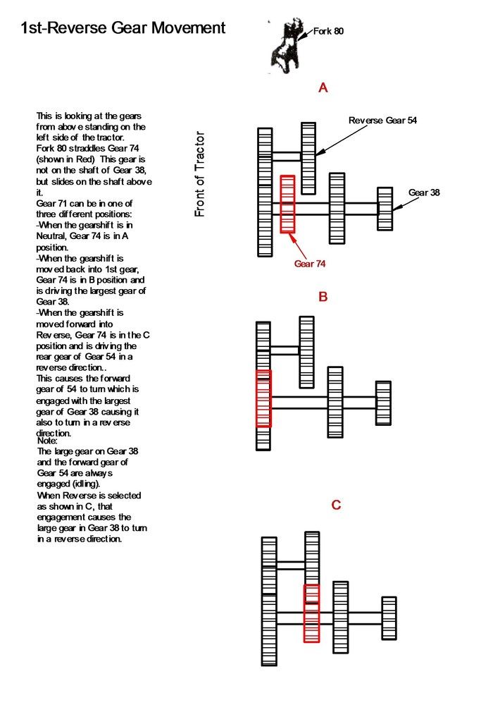

   / Farm Pro 2430 not moving #27
Michael,
I have a Jinma 284 and I don't know if your transmission is similar to mine. But in the event that it might help – here is a drawing. Many years ago I was trying to understand how the various gears in my transmission worked. This is the drawing that I made to help myself. Hope that it might help with your 'confusing' situation.
