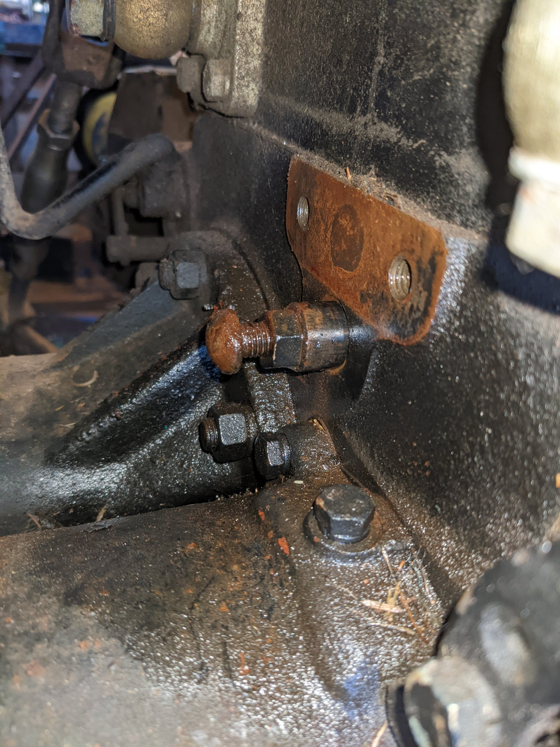

Can I attempt please to clarify a couple of points on my Jinma 254....
My issue is the diff lock is permanently on (have done everything suggested on here re back/forward/jam a break on etc but to no avail..)
The lever (and its shaft) are very floppy - is it that shaft that is moving within the assembly or is it more about the "button" and its shaft? Should I be attempting to pull the button out with some grips?
Hope the picture explains all?

The rounded over "button" you see is actually the head of the bolt. That bolt is threaded into the end of the shaft that connects to the shift fork inside.
In normal operation the shaft is pushed out towards the lever by an internal spring. This holds the locking jaws apart and allows the differential to operate.
In your picture the shaft is pushed in all the way and the jaws are probably locked together as you said. To prove this you can jack one wheel off the ground and try to rotate it by hand. It probably won't turn more than the backlash of the gears. Rocking the wheel that is not on the ground back and forth, perhaps rather harshly should cause the locking jaws to release and let the shaft pop out. When that happens the head of the adjusting bolt should make contact with the cam on the bottom of the lever. Looks like you have about 3/8 to 1/2" clearance there which would appear to be about right.
The question is why is the shaft (button) not popping out on it's own? A couple of things come to mind: broken return spring or something jamming the locking jaws inside. To have a look at either situation you will need to remove the seat and the 3point/tank assembly so you can have a look down into the differential.
BUT, it might just be "stuck" from dirt and corrosion on the shaft where it goes through the housing. I would remove the lever (two bolts) and pivot to get it out of the way. Then try to grab the adjuster bolt with something you can pull on. Claw hammer, crowbar, vice grips, pry bar, whatever. The goal is to get the shaft to come out of the housing that 3/8 to 1/2". It is just a round shaft and it is sealed to the housing with an o-ring so it is fine to twist the shaft as you pull. Rocking the lifted wheel might be needed to help jar things loose so you may need a helper for a few minutes. Squirting some rust busting penetrating oil around the jam nut can't hurt either. Also tapping on the end of the adjuster bolt with a hammer (like you are trying to drive it into the differential) might help break up any corrosion or jar something else loose. Tap, don't pound with a sledge hammer.
It is a robust and simple design. The only iffy part is the use of an o-ring as a seal in a wiping situation but they get away with it because there is no pressure on the seal.

Hi piper184!
Fabulous explanation - I understand it fully so HUGE thank you. The "win" for me is your confirmation that the rounded over bolt is indeed the lock shaft and that it is in the "in" position.
Have had a wheel off the ground and it behaves exactly as you describe.
Will investigate further and of course report back.

This is good news. The spring is on the far opposite side of the sliding shaft and is held on with a nut so I doubt that if anything was broken it would be able to push the shaft out. But then again that might depend on where and how it is broken. Most likely it has not pushed out quite far enough and the jaws are still engaged but just barely.
I can't tell from the photo if the rounded button head is actually touching the cam on the lever. Also is the lever all the way up. It will free fall until it contacts the button. The spring pushing on the shaft moving the button is the only force used to raise the lever. The cam needs to be well lubed for this to happen. I suspect you still have corrosion and grit on the shaft and or the cam.
Take the two bolts off that hold the lever pivot to the housing and remove the lever entirely. Try pulling the shaft out to see if it will come out a little farther. Work it back and forth while squirting more of your favorite magic juice in behind the jam nut.
I would do all of this with the right wheel off the ground and the trans in neutral. That way you can rock the wheel in both directions as you work on the locking shaft. Nice and easy with no power applied will allow things to slip free without doing any damage.
In normal operation when the lock in engaged and with no pressure on the lever, it will release and raise the lever on it's own just by traveling a few feet in either direction. Sometimes it will stay locked until you turn some. But remember that in a turn one wheel is rotating faster than the other so that is keeping pressure on the jaws and that may help keep them locked.
I am betting that the shaft has not come out far enough for the fork to move the right side jaw completely clear of the left one. Keep at it and I bet you get it loose.

100% Correct!!!
I removed the lever and a bit of gentle persuasion resulted in the attached (will clean up & grease). The spring is clearly alive and well as the shaft now pops back out when pressed in.
I now have a tractor that turns corners!! I seriously cannot thank you enough..... as Christmas approaches I would, as a thank you, like to make a donation to a charity of your choice?
Please private message me (or stay public if it means someone else might do similar....!) to let me know which charity that would be?
Let us hope our "conversation" and pics help someone else too!
