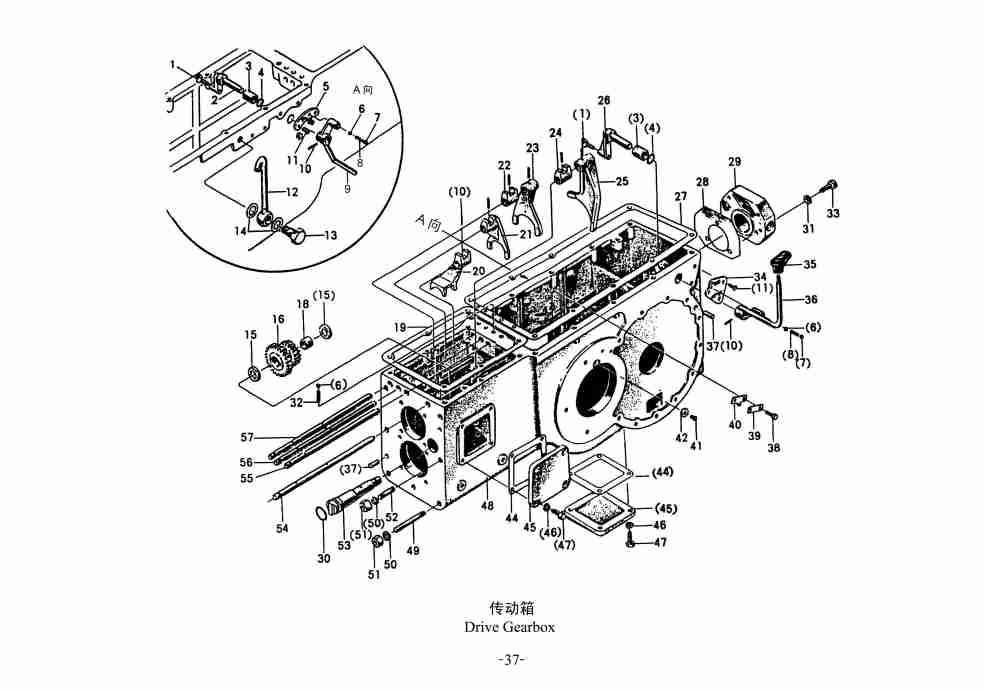

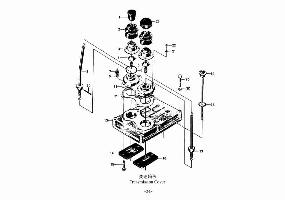

That (erj) diagram is of the wrong transmission. Here's one that's more representative of the 300 series Jinma.
and the transmission cover
Photos of the problem tranny show clear evidence of long term exposure to wet gear oil. How long have you owned this tractor?

Your diagram is my transmission, with exception of different gear location.
My 3rd gear is by itself where reverse is in the schematic you sent
The picture erj posted looks like failure/breakage of the block,groove that shifter end goes in on the upper tube.
I drained gear oil, & it does have a very liittle yellowish tint to it, but there was not but about 3.2 gal fluid in it.
There is a little rusty stain on the tubes, but none on gears or inside wall of box
I did remove the roll pins & moved forks back & forth & all seems fine
I don't think tubes can be removed unless broke apart, as I could not get them to move back enough to remove.
Will flush gearbox with kerosene & put back together
Mechanic 1st thought a gear was stuck or o-ring broke,
now says that shifter end may have not been engaging or something stuck, he says all looks good now
I got this tractor about 6 months ago, this is the 4th Chinese tractor I've had.
1 was junk, 1 was too little, 1 was too big, this 30hp is ideal for my use, I just miss the FEL
Other than a couple lights not working, this one has been perfect
David
