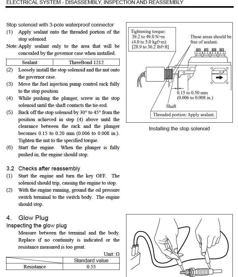

Again this is for the Mitsubishi SL3/SL4 motor with Bosch injection, but the solenoid layout seems similar to what you have.
PastedGraphic-1.jpg Hope it helps

I'll get a pic to post later on the solenoid mounted. Its does have to be set right and where I have it now the engine starts and shuts off. You can actually screw the solenoid in while its running and see a change in the way the engine runs. With that said, today the solenoid stopped energizing again. It worked great for about 20 start ups. I think another relay is causing the problem . Aggravating!!
