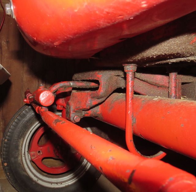

Thanks DJ54 I check out the links. The center steering arm is naturally bent, if that is what you mean - it is not damaged, but the cylinder at the end that holds the tie rods is worn. The tie rods fall out of the bottom. The ball on the end of the tie rods that fit in the center connector are very worn also, they have gouges and do not allow full range of motion.
Here is a pic of the steering arm, I put the tie rod that fell out (down) back in but it all needs replacing because of excessive wear.

I actually meant bent, as in damaged.
Maybe the tie rod ball seats are worn badly, possibly even missing..?? Mine are worn pretty well on my '47, but not bad enough to drop out. Bates does have new ball seats. Farmall Letter Series :: Farmall A :: Steering :: Tie Rods
You might try those salvage yards if there is no means to build the tie rod balls up then grind down. I may do that to mine someday.
Bad thing about buying used, they may be near as bad as what you have.
   / Farmall A steering parts #8
They also have a pair of the tie rods in stock. Products :: 57869DA-ASSYU Tie Rod Assy Pretty pricey too. I'd probably do some shopping at the salvage yards first, or do the parts search through TractorHouse. I've had good luck going through that for hard to find parts, and prices can vary widely.

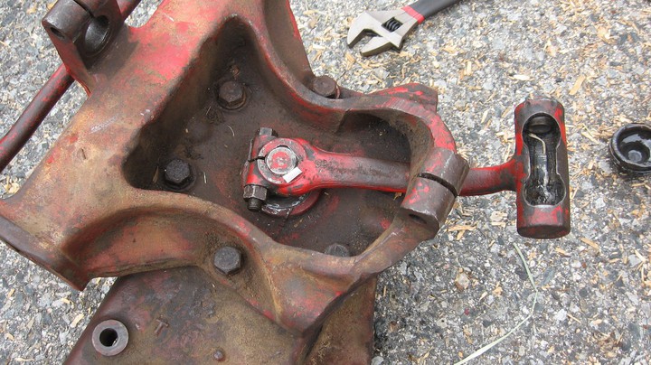

The three ball seats are all in good shape, I had enough grease in there that they did not fall out when the tie rod dropped while mowing. I think this is the right tie rod on eby - Farmall Tractor Tie Rod Tube Complete Adjustable A B AV SA B BN 57869D 48289D | eBay
but the steering arm on ebay looks very questionable, especially the underside - Farmall SA Tractor Good IH Main Steering Tie Rod Holder Mount Control Bracket | eBay
Here is a pic from the other side.

I posted the pic from Bates this morning, thinking something didn't look right. Should have dawned on me, especially when I said I'd ground a bit out of the center of where it attaches to the steering box. I'm thinking you may want to take a peek at where the other end of the steering arm where it attaches to the steering shaft coming out of the steering box.. Mine is like in the pic below. Split in the back, and a bolt to keep it snug on the shaft. And pretty sure the shaft is notched where the bolt goes through, to keep it from dropping off. It's been 25 years since I worked on the front end of that tractor, so details may be a bit sketchy, without checking..
The one in the pic from Bates, and the one you posted are for a Super A, and the steering shaft is threaded, and a nut holds the steering on from the bottom. Hate to see you order, and pay for something that won't work on your tractor.
