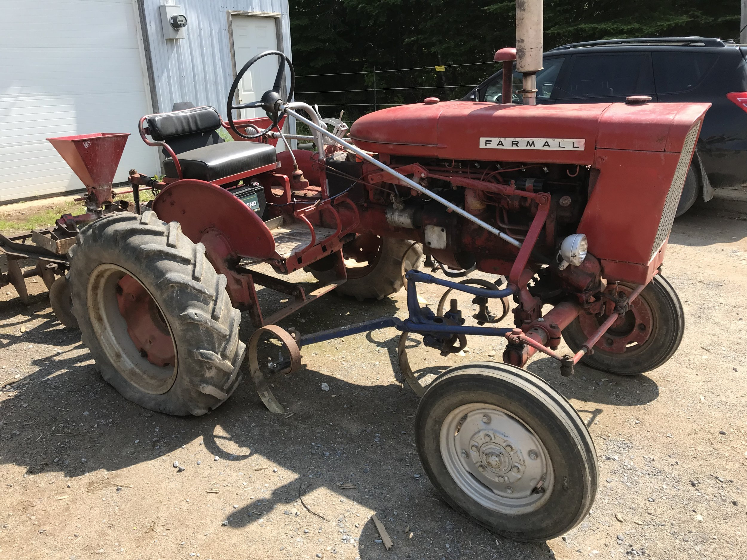

Which model is this? Was down by a local strawberry farm
