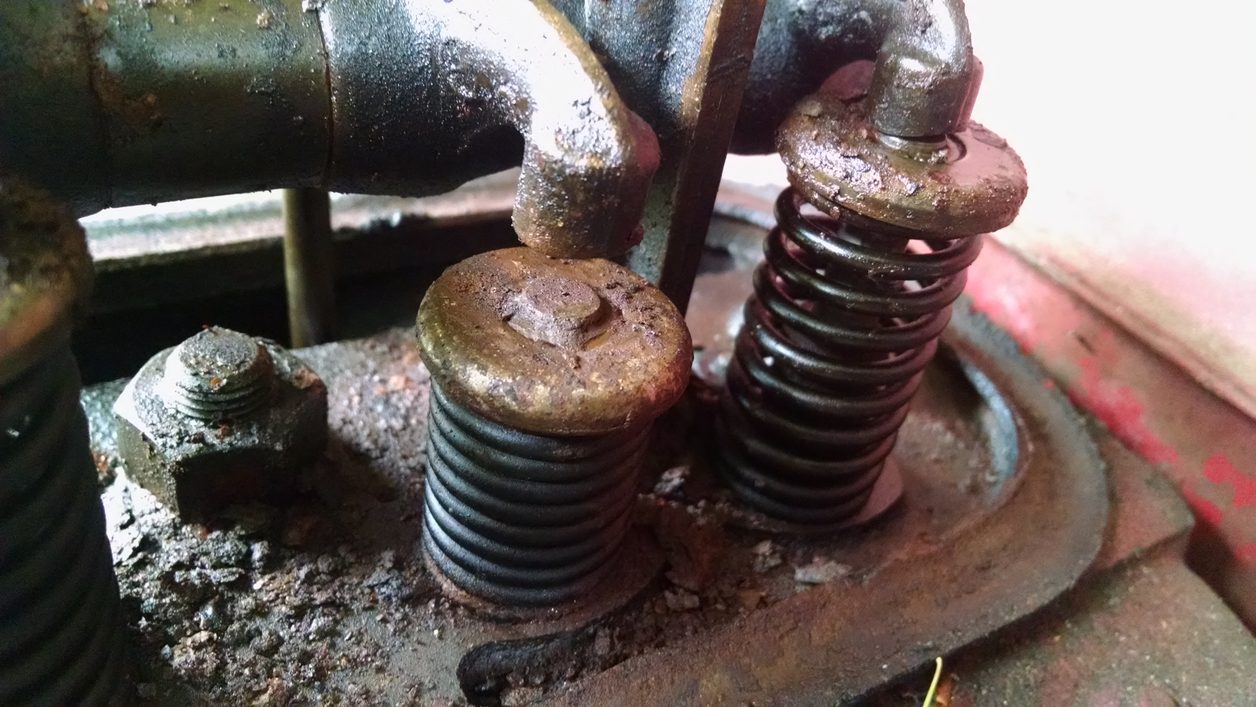

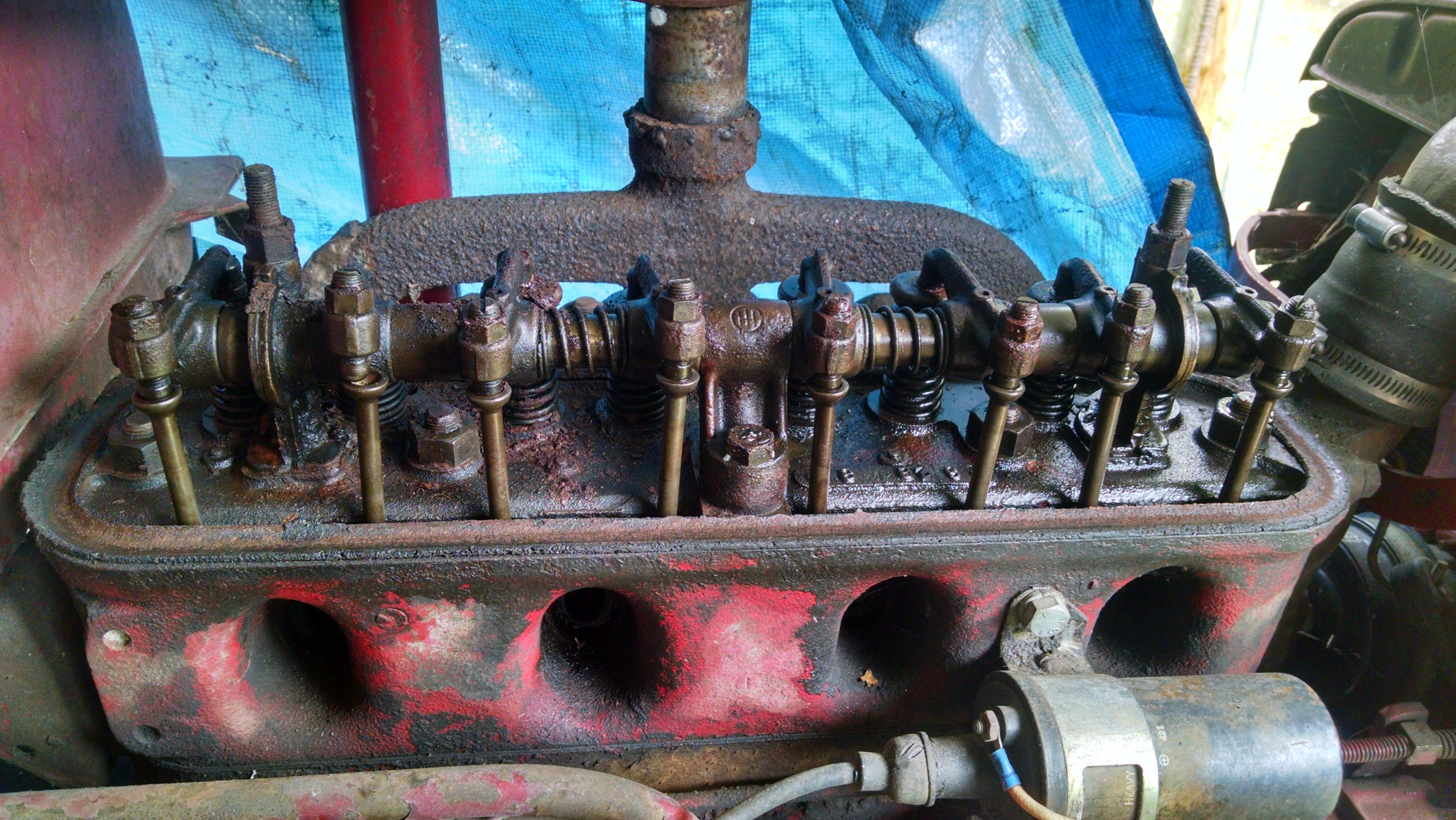

I need some advice on replacing/rebuilding the head on '47 Farmall C. Where would I go to boy a used or rebuilt head? AND should I replace the cylinder sleeves while I'm at it?

Do you have any cracks?
I'd try cleaning up what you have before going out and buying new. From the photos, that just looks more dirty than anything else. There is at least one stuck valve, but that may be able to be repaired.
Valve lapping is easy enough.

Pull the head and take it to a shop to have it services. The valves need to be lapped as well. They can check it for cracks and true it up if it needs it.

If you don't have any luck close to home, feel free to contact me. I am a retired master mechanic and machinist, but still have a shop here at the house. First clean and check for cracks and surface warp. It's quite possible that head would only need the valves refaced and lapped in, along with knurling the guides and re-cutting the seats. Mic the cylinders and pistons. You might need a set of rings and nothing more serious. Folks used to ship motorcycle and antique tractor heads in from all around the country to me. Let me know if I can help. This winter is going to be cardiac re-hab three days a week until the first of the year, so that leaves a lot of spare time. themotorsickledoc@yahoo.com or text 931-627-5370
