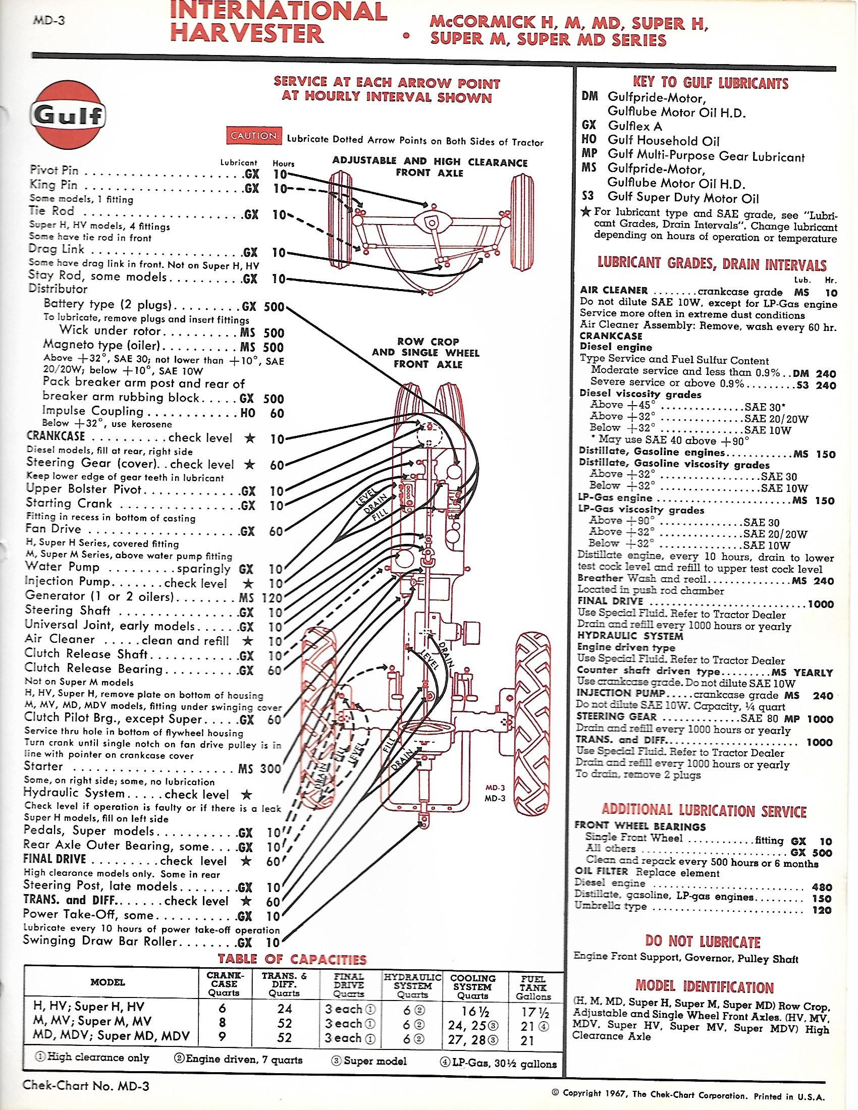

The plug you are pointing at, I the level plug. Fill plug in on top, near the gear shift. I've attached an old Lube Chart, from an old Gulf Oil catalog of multiple tractor lube charts I have. Shows all the lube points, and capacities.
If it has set outside, more than likely you have what looks like a milkshake inside the trans./diffy. Drain out that lower rear plug. Fill with a couple gallons of cheap Auto trans fluid ( Walmart brand is fine) A couple gallons of diesel fuel, and a quart of rubbing alcohol. Drive it around for 15-20 minutes, then drain completely. The ATF is high detergent, and will clean things up. Diesel fuel will wash it down. The alcohol will absorb any water/moisture, and bring it out with it. Another TBN member Soundguy, spoke of adding the alcohol years ago to the first two items I always used anyway to flush them out. Works great..!! Then refill, until it comes out the check plug. Capacities are listed at the bottom of the lube chart I attached.

(Edit) Forgot to mention, when you open the lube chart, you can save that image to a file on your 'puter. You can also print it off, and it will print out a full sized print, and save it, if you have a loose leaf notebook, if you have other manuals for it..

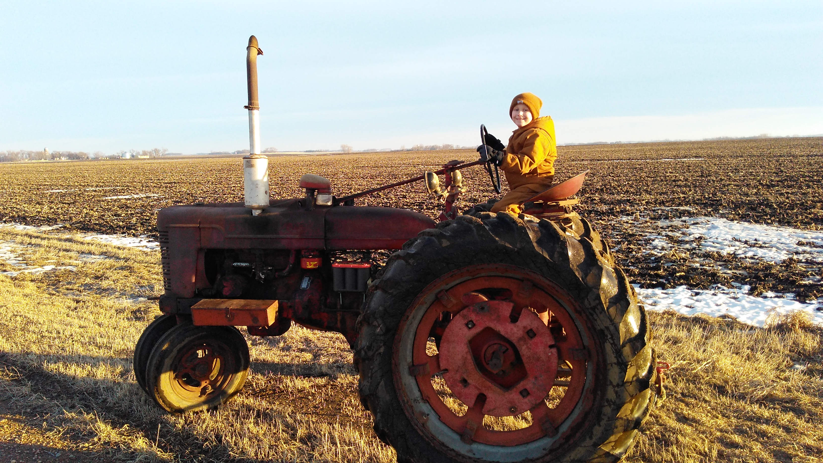

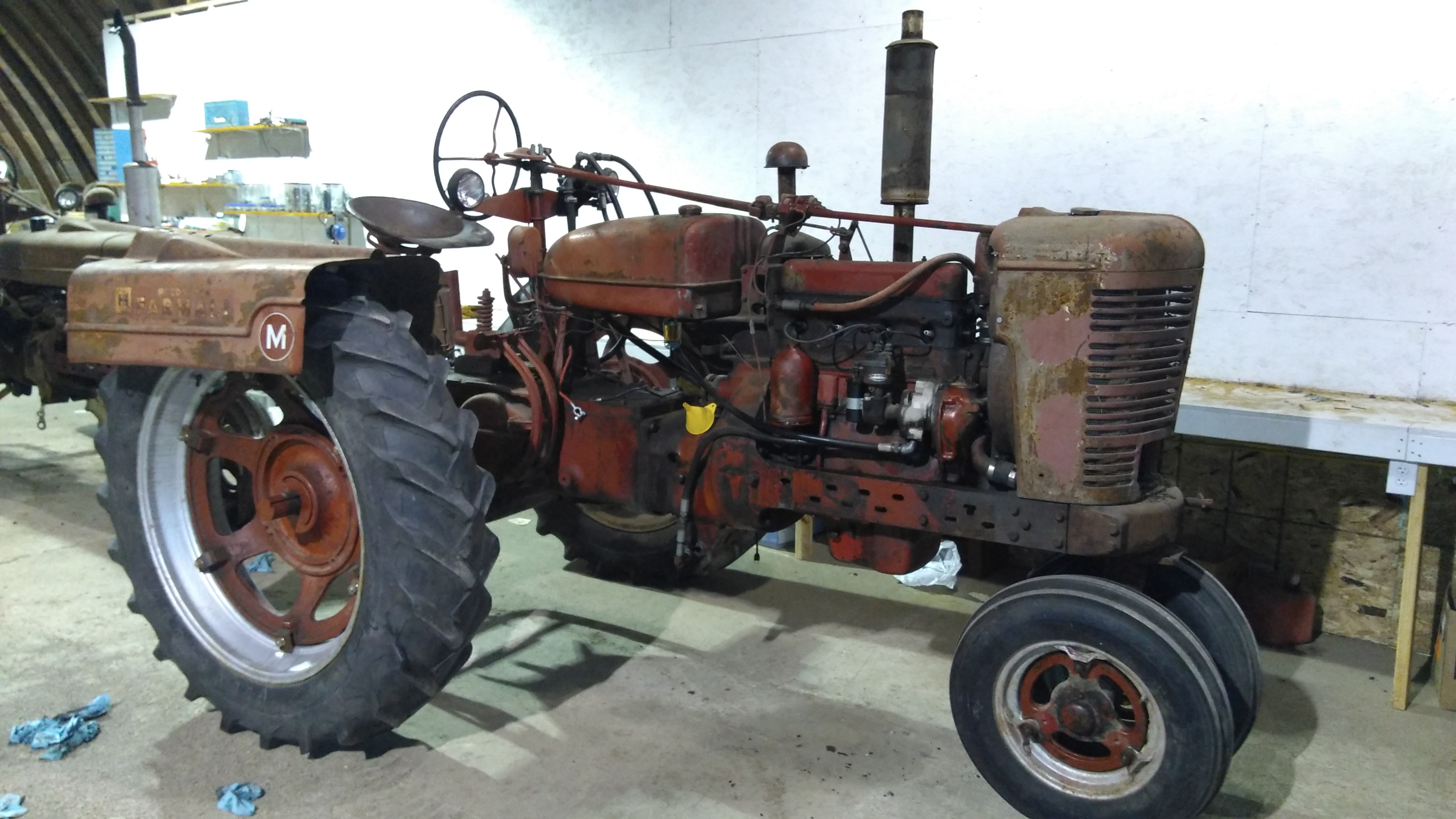

Hopefully next week I'll be pulling logs with the H I need to get an old Grove cleared for planting new trees this spring. I attached a picture of the H getting driven around a little yesterday and also my next project. 47 M with a blown head gasket bad manifold gasket screwed up carb and a few other things it use to have a loader and a wide front and a potted out rim I've been slowly working on this one also. I'll start a new thread for my progress on this one too.

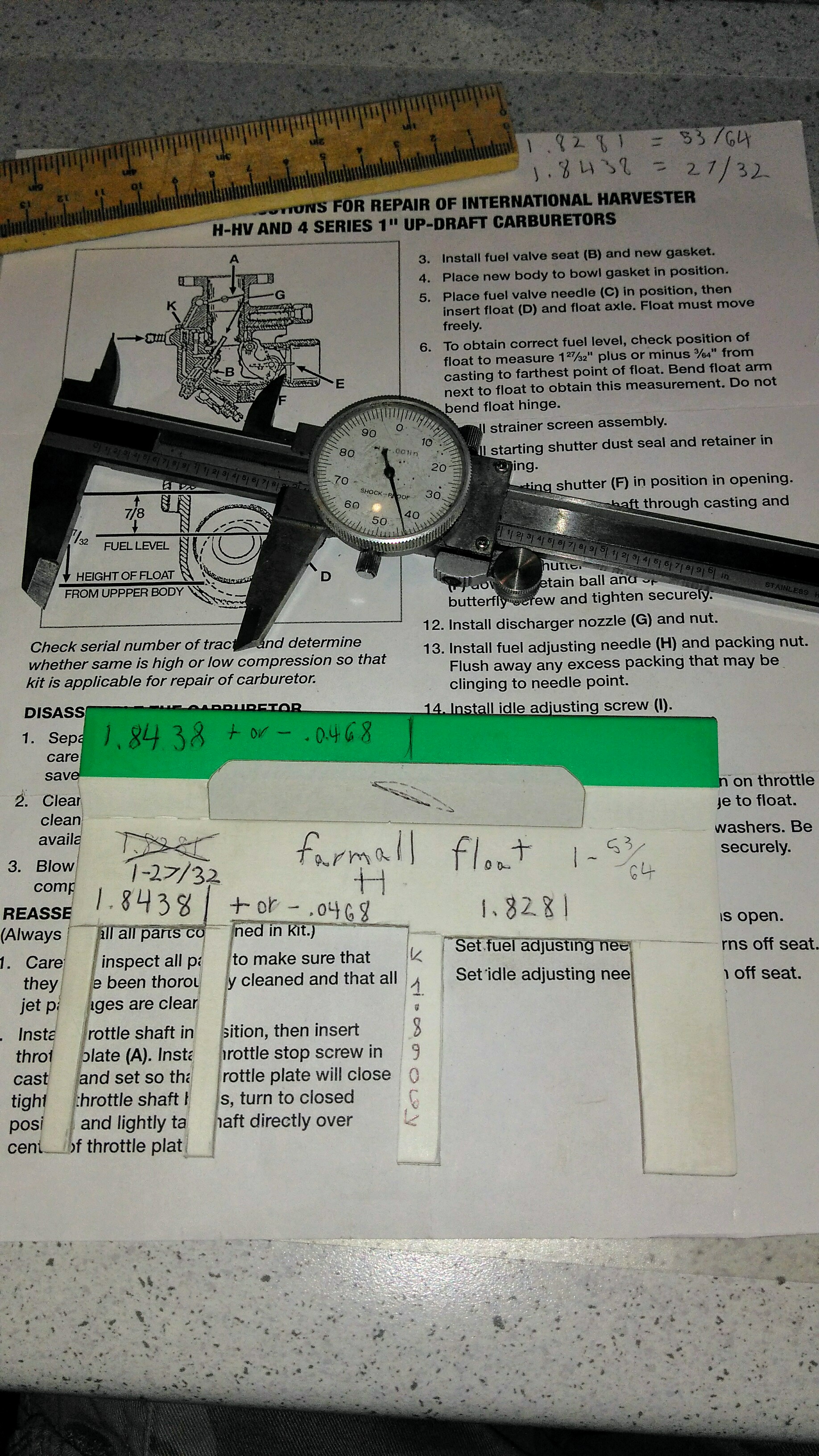

Got my jig update with 1.8438 and 1.8906. .89 should stop the leak.
