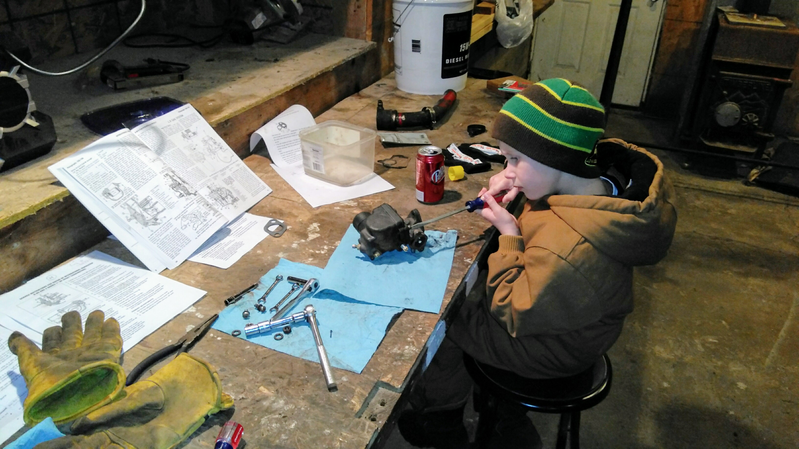

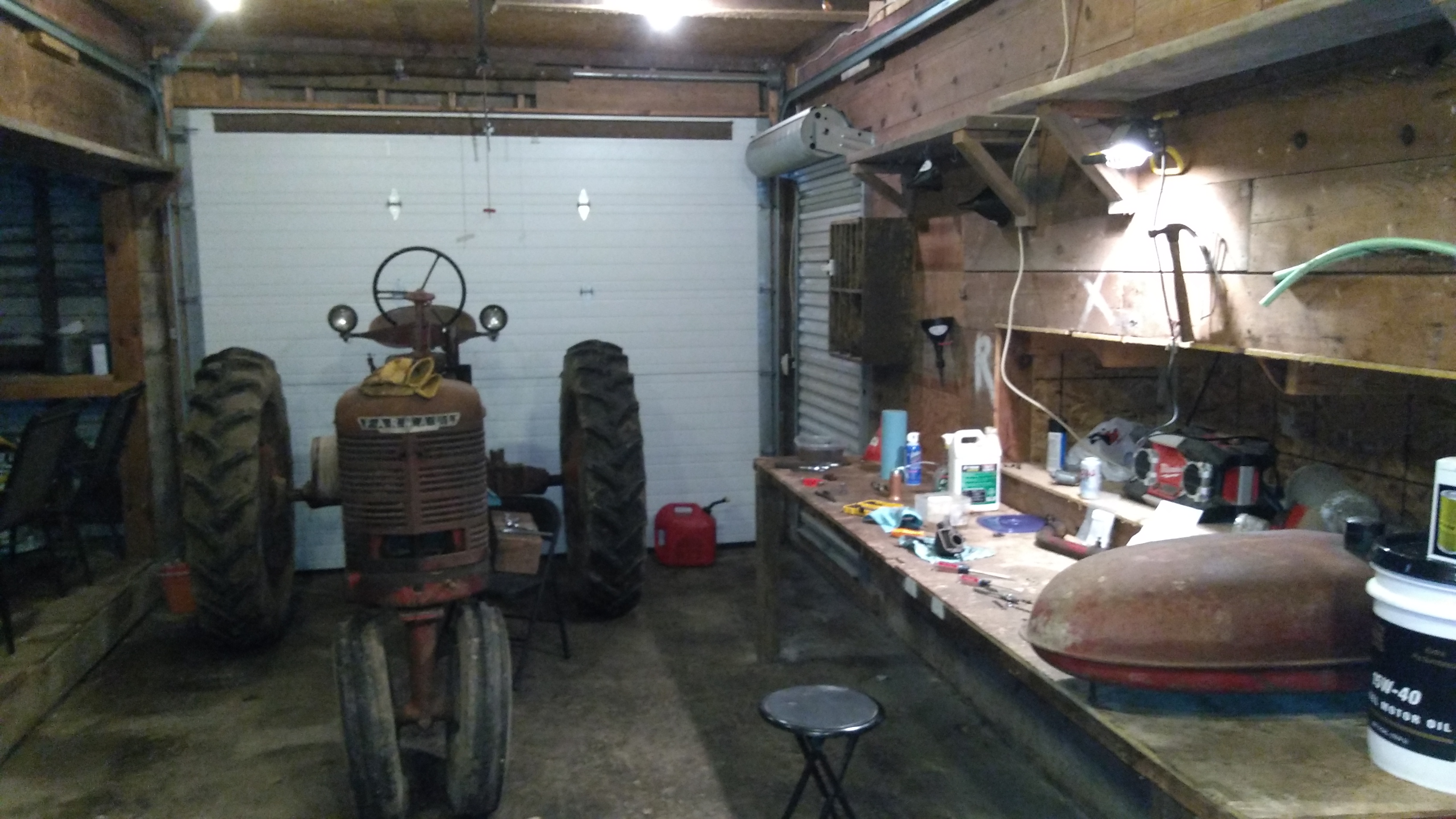

Thought I would add a little update. I got the carb totally rebuild points redone along with fluids and a bunch of little things. After taking the carb apart 3 times to adjust and change things like the float I got it running really smooth. The plugs are a little white which means she's a little lean so I might try to richen it up some but it seems to be running pretty smooth. Guessing it bad to run it on the lean side? For getting the float setup right I made a little jig that worked awesome. also had my 6 year old out helping pull and rebuild the carb with me. Now I'm itching for the snow level to drop so I can go pull logs with it and work it hard. I attached a few more pictures. I do have a question there is a little plug right Infront of the clutch is that the fluid level full plug for the rear end fluid?

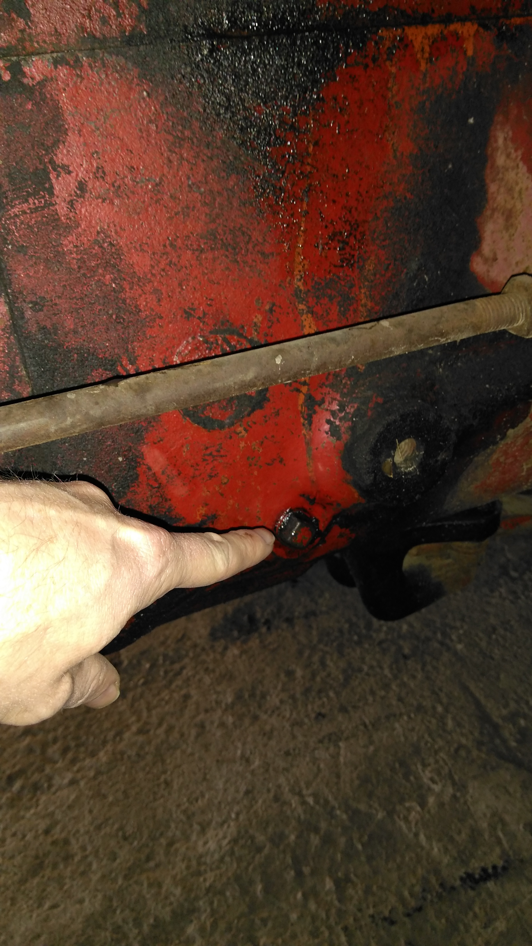

Here is the plug. When you pull it the same nasty fluid that appears to be in the rear end is in here also got me wondering if this is the full checker plug
   / Farmall H Startup Advice after 20 years of sitting #18
That looks like the drain plug. The fill/check plug is the bigger one about halfway up the pot.
   / Farmall H Startup Advice after 20 years of sitting #19
Very hard to tell by your pic, which is too close. Use a long pointer if necessary so the pic can take in more of the tractor chassis.
Appears there is a top cover just above your hand?? Maybe you are in the transmission case?? I'm not certain whether the trans and rear diff run in the same oil?? Older tractors tended to be separate cases. Sorry I can't be more specific

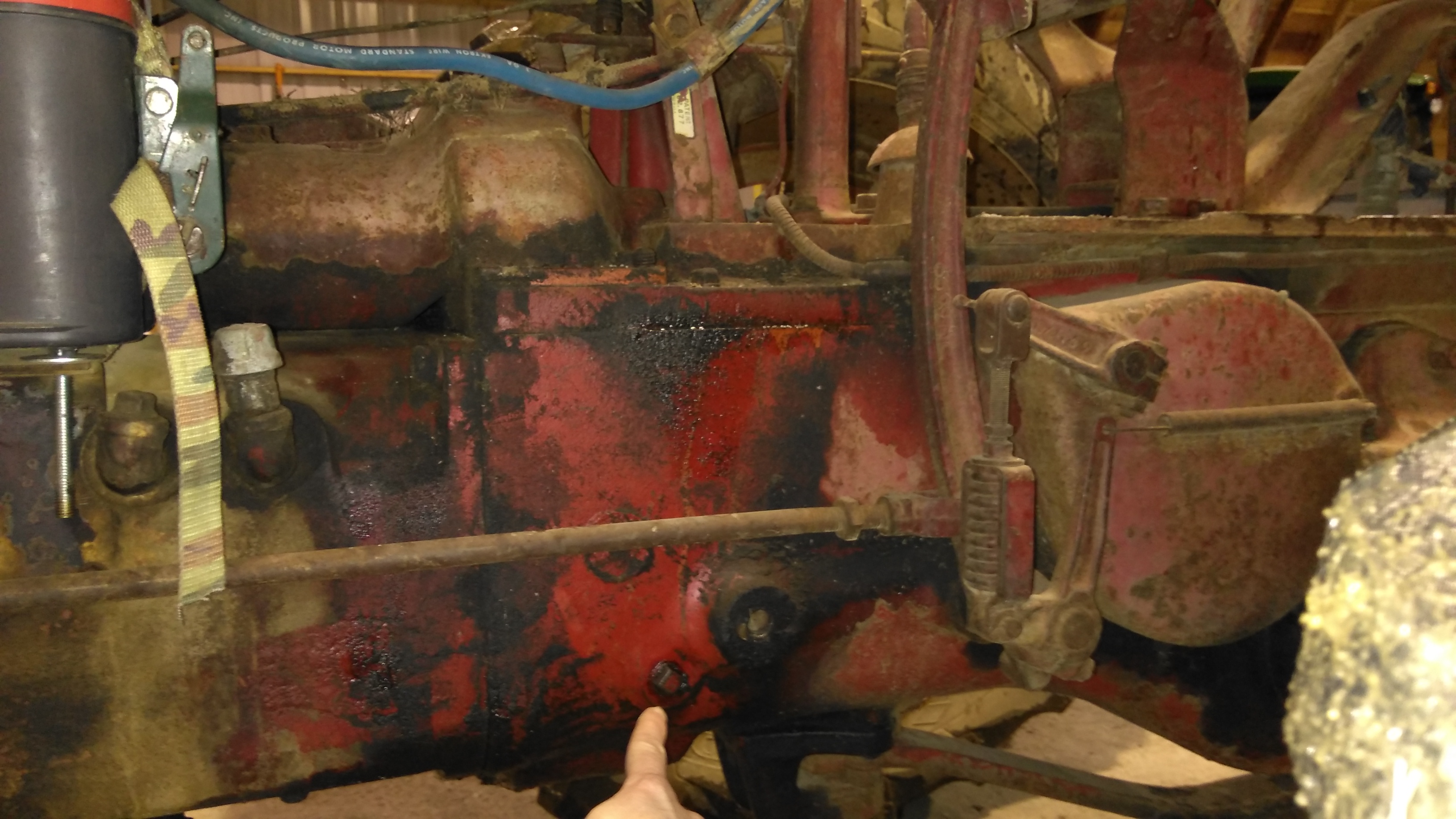

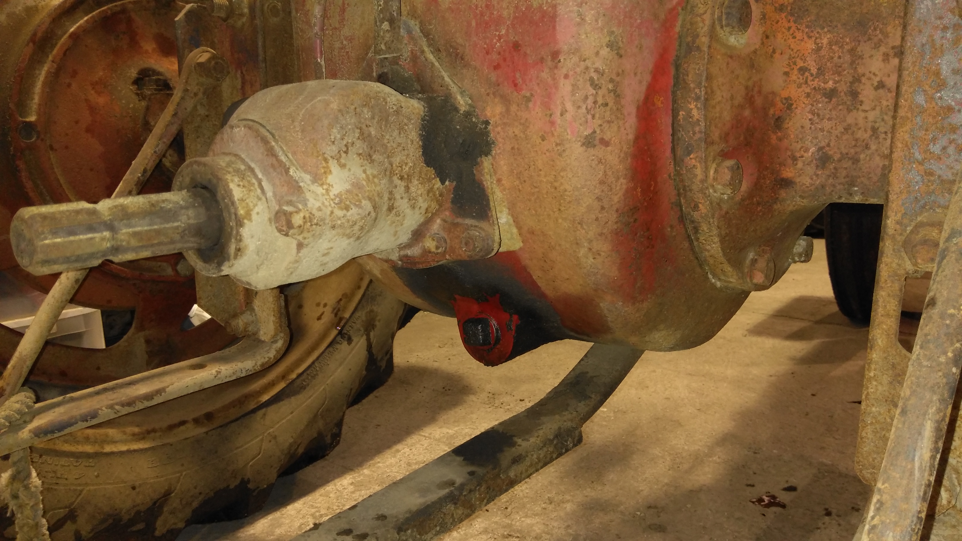

Here are better pictures sorry that last one was way too zoomed in 1486769656211.jpg1486769664104.jpg
Also a rear one of the main fluid drop plug
