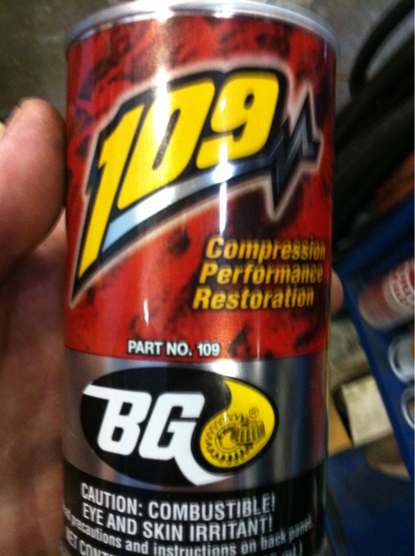

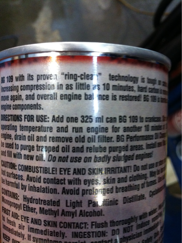

Thinking my 48 is sludged up too. On the fleet where I work we use Fuchs 1540. Good stuff. Might try that. Dad had always run the straight 30.
But what do you think of this oil additive. We've used it on cars before and it works well. Put it in run it til it gets up to temp or just a hair longer, then drain.
