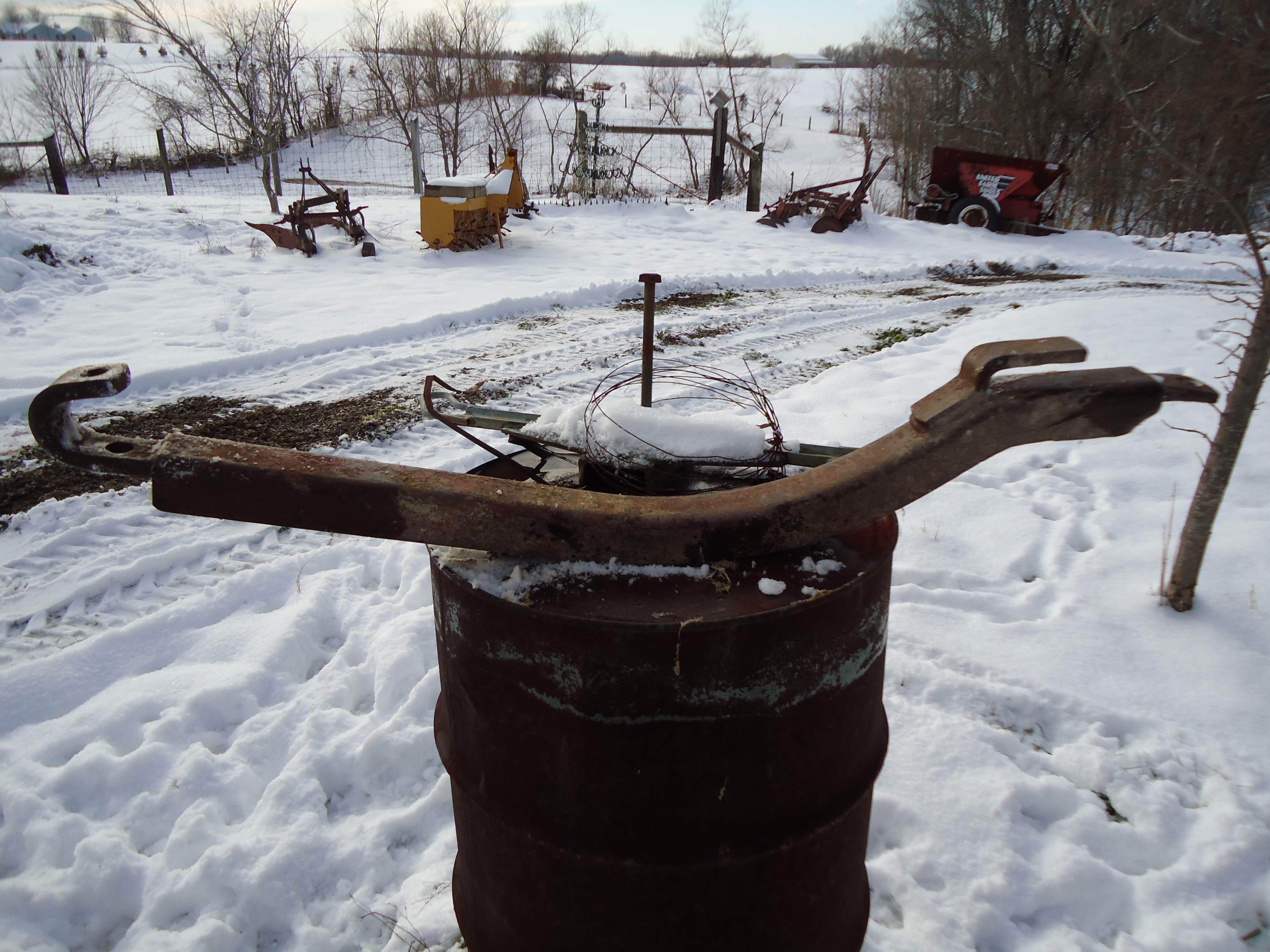

Got some pictures to help explain what I was talking about. If they are in the order that I downloaded, the first one should be of the IH 3 pt. conversion. Excuse the dusty tractor, I ground hay for my old mare today, and it is a rather dusty job...

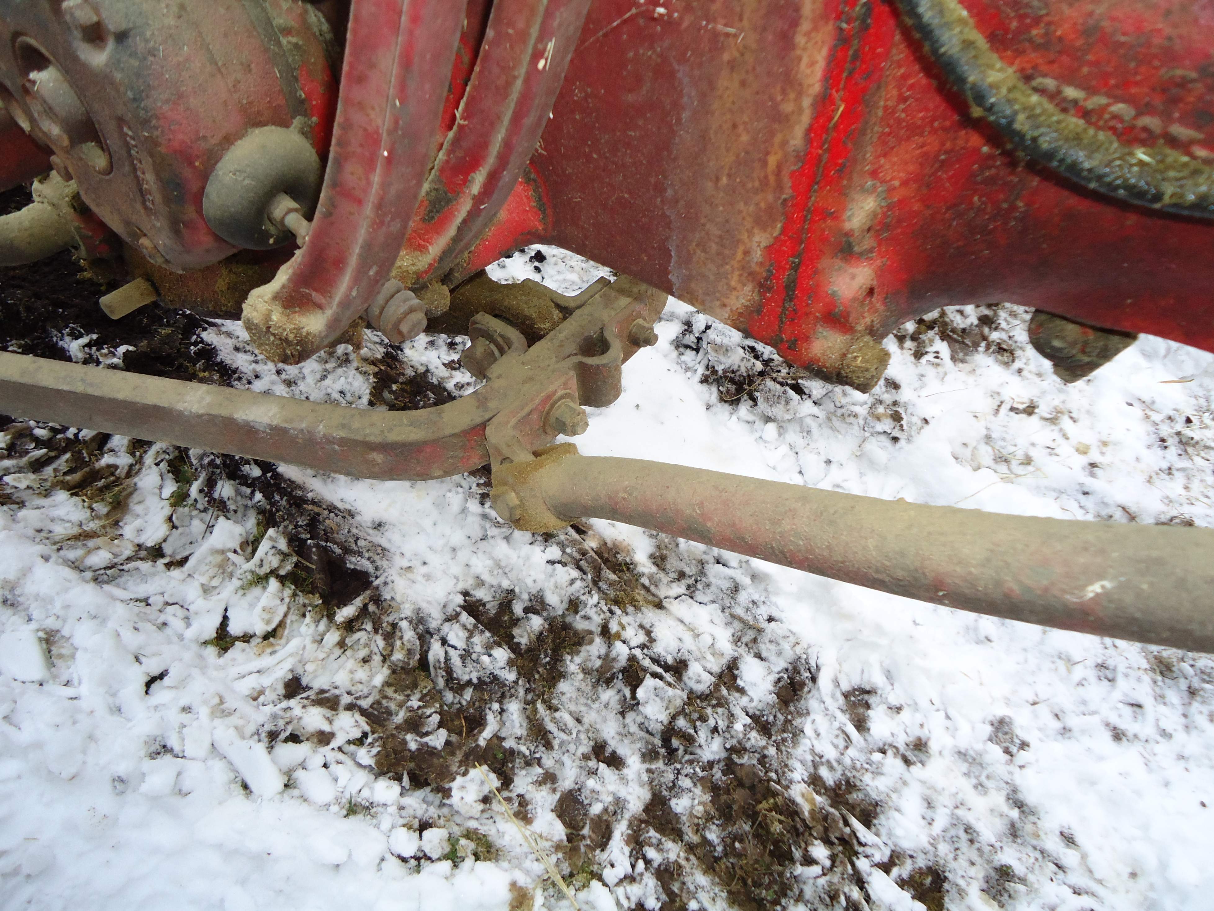

The next two should show the rod from the touch-control, down to the front of the wishbone on the drawbar. In the very center of the wishbone is a loop to the front. This is to pin a swinging drawbar to.
The last picture should be one of the actual swinging drawbar. Came with it, but never used it yet. Would probably come in handy pulling a pull type disk, allowing a shorter turn, and keeping the rear tire out of the disk. I got a Fast-Hitch disk with it, but never used it yet. Not sure that ridgid frame would do near the job my M-F 6 footer will do, with independant floating, manually adjustable gangs. Some day may hook on to it, and see...

DJ54, thanks a bunch for those photographs. They were taken in just the right places to show what was needed. I've never seen this system work, but with your instructions I believe I've got it figured out. Now I'm wondering why Farmall went to all that work when Fergurson had developed the true 3-point many years earlier. I can see where this system could be adjusted side to side and front to back without getting off the tractor, but there sure is a lot of iron mass involved and the mechanical advantage or efficiency of the system is not the best. I believe I've got the cultivator system figured out too. I'm guessing the rear cultivator (3-shovels - 1 for each tire) were mounted to a bracket bolted to the rear axles - just like one did with the rear section of cultivator if you never had a Fast-Hitch system. When you did that, you un-hooked the rod that connected to the righthand rocker from the tube that connected to the front part of the Fast-Hitch yoke. You bolted the tube to the torque-tube portion of the tractor just to hold it in place. That's where that tube is connected on my tractor right now. You then installed the front cultivators with the left one controlled by a rod to the left/outside rocker and the right one controlled by a rod to the right rocker. Both of these were controlled by the left touch lever. Then you'd have to disconnect the flat bar on the left side of the tractor and place a rod from the left/inside rocker back to a u-shapped lift bar on the cultivator. The rear cultivator would be lifted/lowered by the right touch lever. The Fast-Hitch hydraulic lever would not be used.

Fast hitch had down pressure, witch had its uses. The fast hitch disc works great. But you need to change a setting, same as when mowing, that allows the load to rise, ( or stops the downward force)
My great grandfather and everyone of his line to me say a 2 point fast hitch is much better to hook up than any 3 point. In fact i never get my cheeks off the seat. You just get lined up and back into it like hooking up a 5th wheel hitch, lift and drive away.
