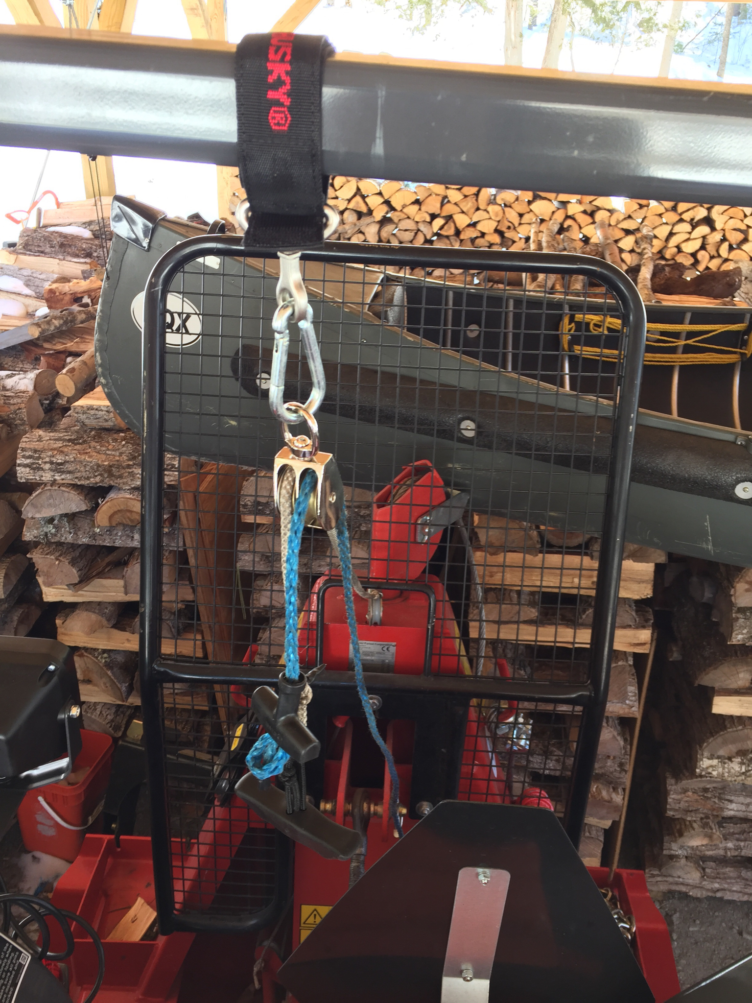

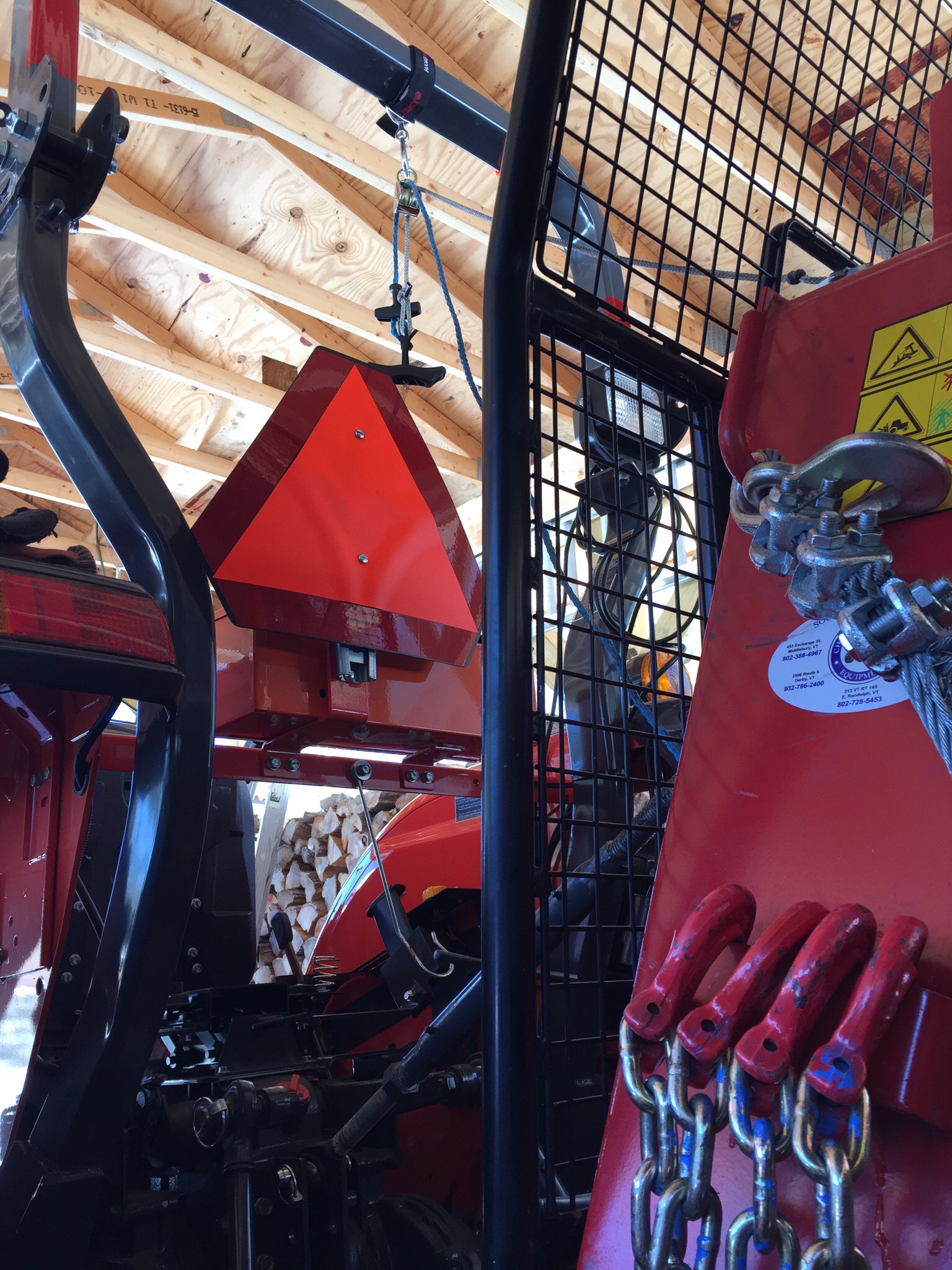

Figured an update was warranted. I rigged up a simple pulley system and put pull handles on each of the ropes. Can't tell you all the tangled rope hassles that have been eliminated.
