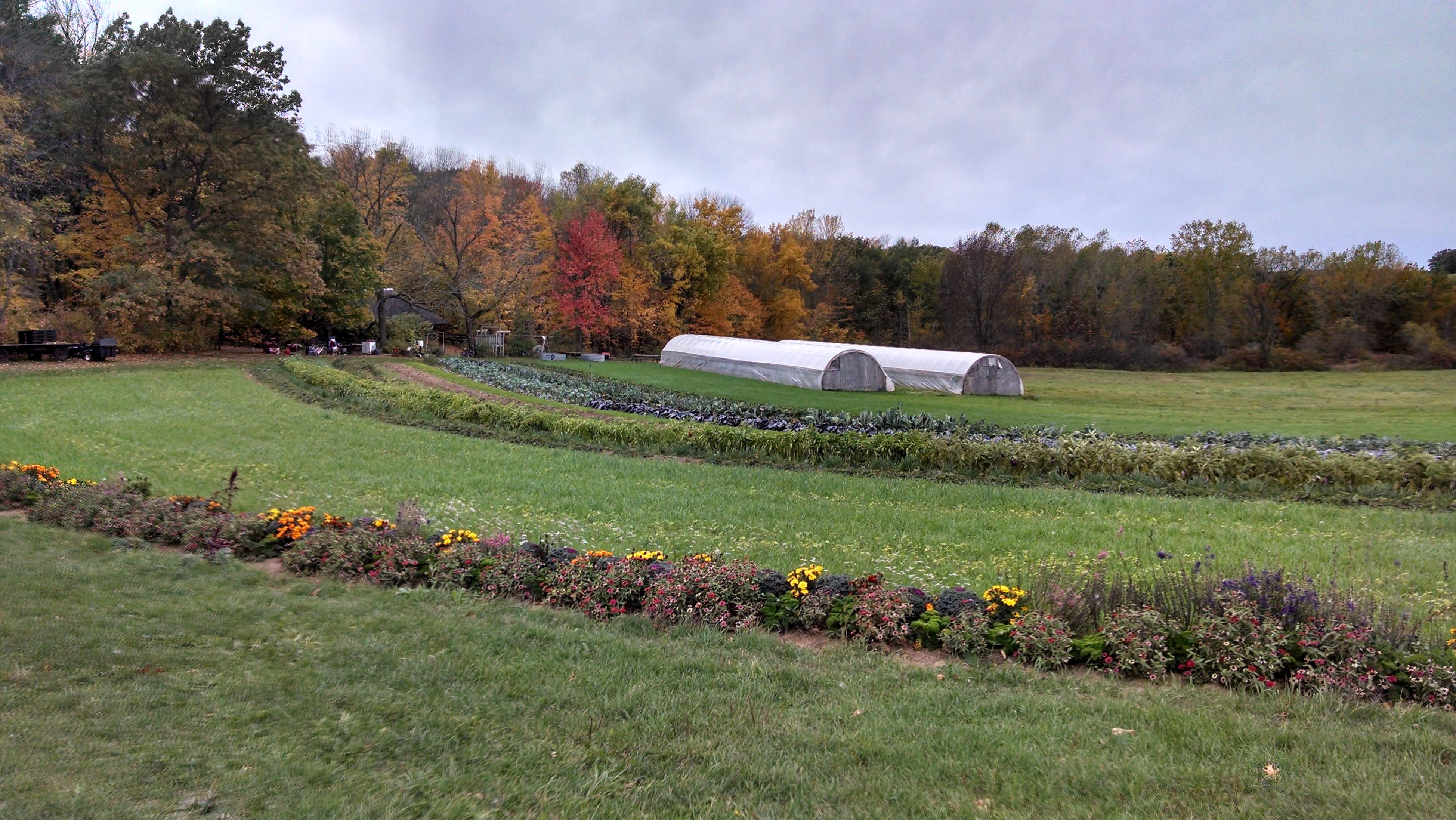

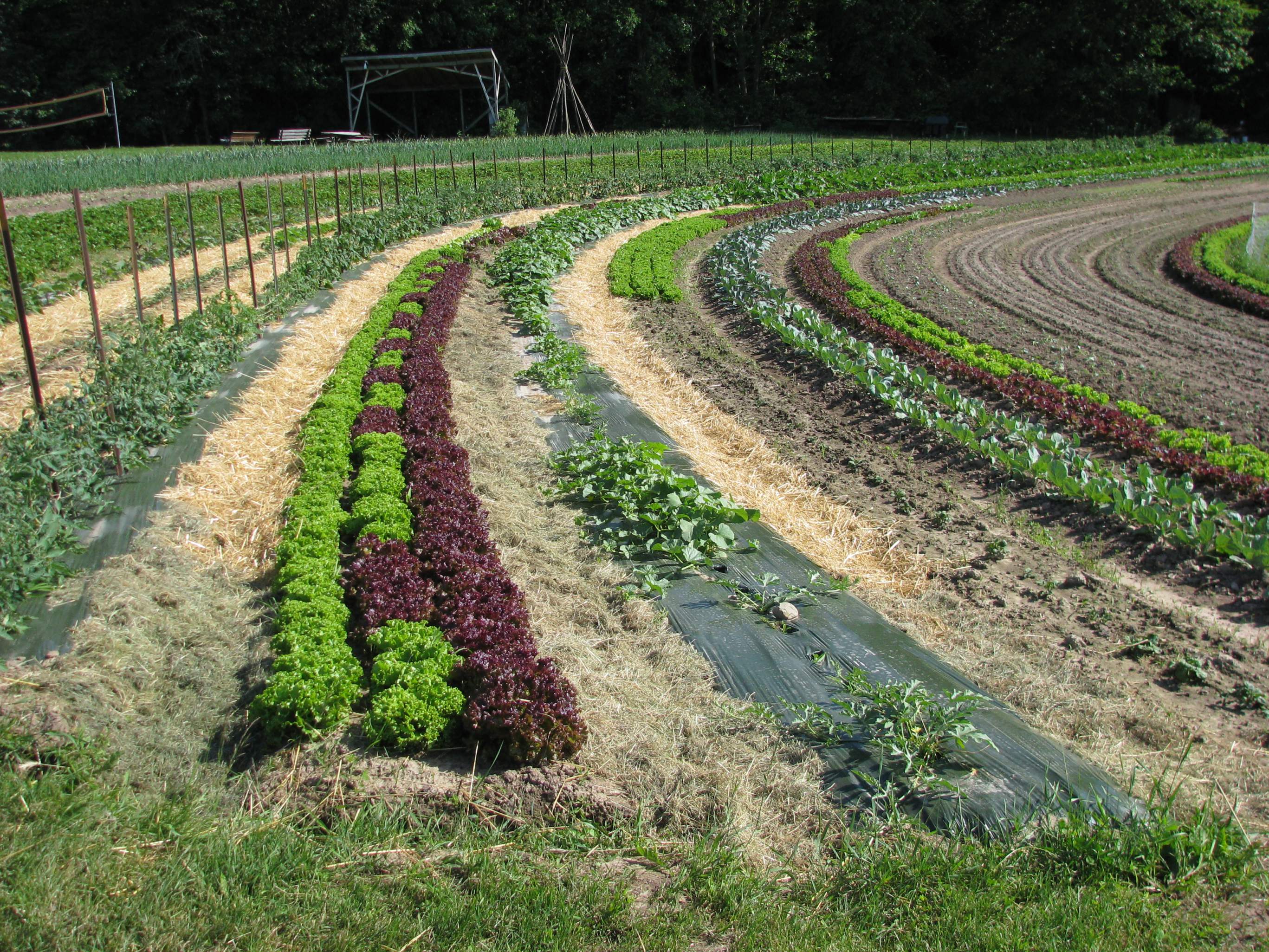

IMG_0231.jpgIMG_20131014_141230145_HDR.jpg Here are some pictures of our vegetable operation. We grow produce intensively on a little more than an acre. Granted our slope here is a lot less than 30%, it's a closer to 6%, but we don't use any retaining walls. We plant in raised beds on the contour of the slope we are on, this is our main defense against erosion. In a perfect design, we'd have the ends of our beds be lower than the centers by about 1%. This would facilitate drainage, and eliminate the risk of water building up in the center and crashing through the lower beds. I don't really know anything about the weather in GA, but I would strongly advise designing your terraces with water flow as the primary consideration. I would consider money to consult experts in the field very well spent. Also, you asked about cultivating with the tractor, which means weeding around a growing crop. I suppose this all depends on what you are farming, but on a space that small, I would recommend swan-neck hoes, and wheel hoes before tractor cultivation. It is a little slower, but the equipment is much cheaper, and it will be much easier to get good results. Tractor cultivation, requires pretty specific equipment which must be set up to work with your crop. Also, cultivating tractors are a little different than regular tractors in that the are often offset to allow the operator a view of the crop being cultivated by implements carried under the belly of the machine. Cultivating with a rear implement around a curve for a beginner is going to be very difficult. I assume you will be growing vegetables or another high value crop seeing as your area is small, and would recommend hand cultivation, it works fine for us on 1.25 acres. If you want to cultivate with your tractor, buy a Farmall Cub for a couple thousand and leave it set up to cultivate. Farming in curved lines takes practice, but once you get the hang or it, the end result is much more attractive, and functional in our type of situation, than straight lines.
If you think farming in curves is tough, try doing it on the contour of a slope like ours without retaining walls, meaning that one of your tires is always downhill. Now, try doing everything with an 8n, which doesn't have live power or hydraulics, or power steering. Essentially, you stay pretty busy up there, always thinking about the right order to do things, "okay, engage PTO, shift to neutral and release clutch to engage hyraulics, raise implement, crank side link arm all the way to compensate for slope, clutch in to shift into gear (gotta be fast enough so the hydraulics don't leak to the ground) release clutch to travel, but don't lift the implement too high and disconnect your PTO shaft. Drive onto bed, lower implement, etc. etc. etc. Needless to say, life will be different this year on our Kubota.
