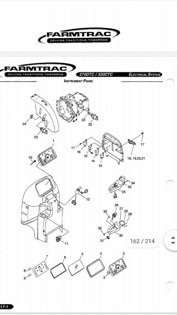

There are a few safety switches . 23 on this pic. Looks like one on the fender and one in the case Screenshot_20200421-211740_Drive.jpeg
   / Farmtrac 270DTC will not turn over #12
You need to determine if there is power to solenoid on the key side to engage it and then is the solenoid working. Power to both lugs with key switched. You can jump solenoid and it will turn over but not starting when the key is in off position. Is it engaging the fly wheel? It could be a safety switch. I do not believe there it s a PTO or seat switch. Just neutral one, maybe clutch one but not sure. Just the 2 I saw in the pic. Like said above verify. battery and connections too. A " bath" will not in any way fix or troubleshoot your issue so skip that fok r now. LOL

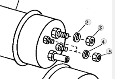

I took a screwdriver and jumped across the solenoid yesterday and it made a spinning noise. Would I need the clutch depressed?
When you attempted to jump across starter did you put screwdriver blade from small terminal(should be marked "s") to top terminal on solenoid?
It's also much safer when attempting to jump across starter solenoid posts to have someone sitting in seat with traction clutch pedal depressed. I've know people that got run over & received broken bones from jump starting a tractor
