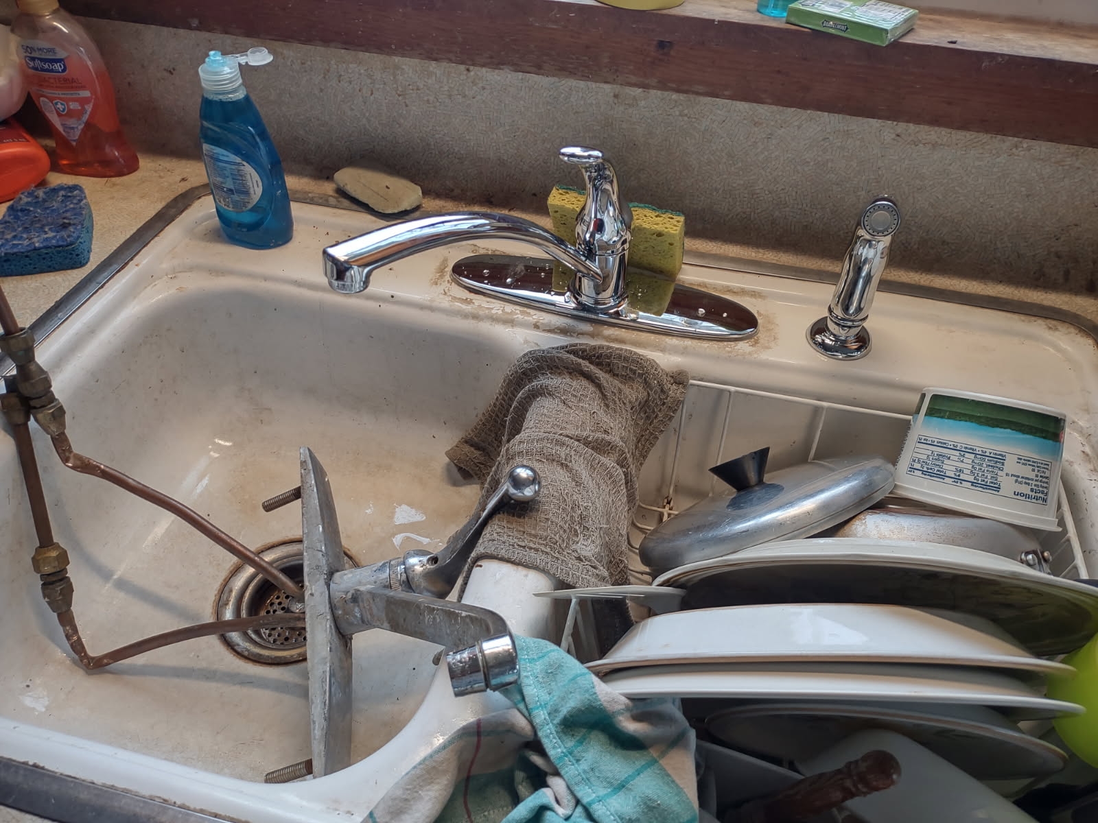

A few years ago I installed a new faucet in the kitchen sink (Not my idea, it's a long story...). My water isn't too hard and I do have a softener, but about every two months the flow slows to a trickle and I have to soak it in vinegar or CLR for a day or two to get it opened back up. I'd rather have a plain old non-aerated faucet if I could find one.

FWIW: You can remove part or all of the inside pieces of most aerator cartridge. In some designs, just removing the topmost piece, or washer, can make a big difference.
Many designs have tiny, tiny holes that clog easily with fine particles.

Mine is still plugged up and frozen on.
I give up.
Calling a plumber tomorrow to replace the entire thing.

Really? Call a plumber for this? At $80+/hour? Take a pipe wrench to it if you have to. If it breaks, THEN replace the faucet yourself. It's not rocket science. I just replaced my 30 year old kitchen faucet yesterday, because it wouldn't come apart to replace the $4 rubber bits inside - dripping when off. $70 Delta faucet at Menard's and two $7 hoses.
Yes, plumbing SUCKS, but it really isn't that hard (except for the crawling under the sink part...).
I was back under there this morning to align it better after this pic was taken.

If you're going to replace the entire thing, I'd put the coconuts to it with a big wrench first. It might bust loose before it breaks the faucet. Worst that can happen is you're at the same point of replacement.
Also, faucets aren't too hard to replace.... I have three basin wrenches to prove it. :ROFLMAO:

+1 in @MossRoad's advice to take a big wrench to it. I've mangled more than a few aerators into scrap metal doing it, but I haven't ever broken a faucet. So in my experience, the odds aren't terrible, and the worst case is that you are back at the faucet replacement stage.
An upside to a plumber might be that they have ready access to higher quality faucets than the box stores. That and not dealing with the kick plate.
I've used all sorts of items to help level out the kick plate edge that seems to be designed to scrape spines and aggravate backs; 4x4s and plywood sections, cardboard, but the yoga mat sounds pretty good.

I've had success using penetrating spray on frozen threads for the aerators. Since all mine are polished brass, mechanical removal is not a option, so I use a rubber strap wrench.
