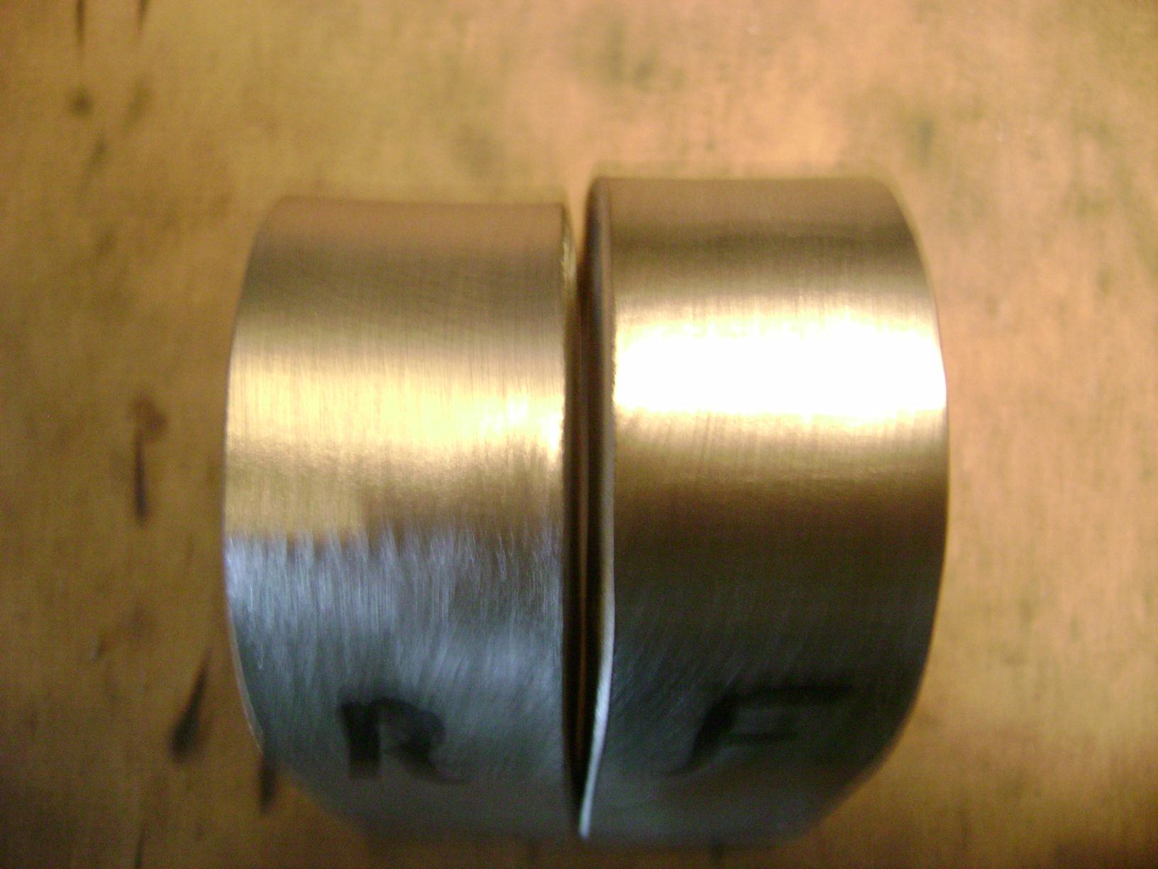

No I haven't, but remember I did one on 3/8 plate, and it bent fine, but the fillet weld test was not impressive at all! 10 blows to break the 7014 bead, and the 7018 that came out of the oven I had to beat back and forth to get the fillet weld to break.
Here's the coupons for the 7014 bend test.

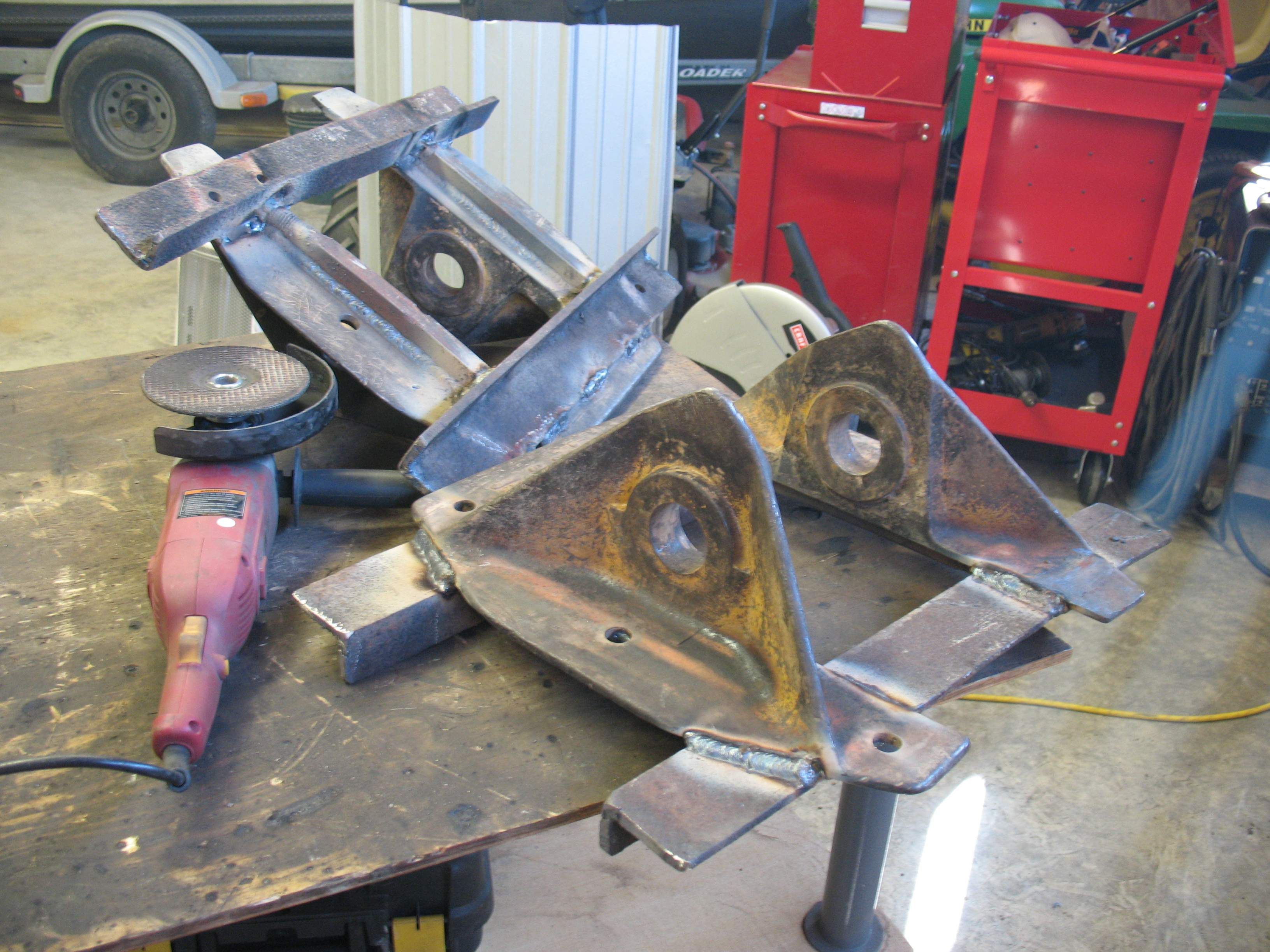

Well guys I finally finished up the stabilizer pads for the JD 310 backhoe that my shop building contractor (Ricky) has. I started out repairing the broken tips, then put on some 1" square bar from an old disc axle I had for anti-skid. That took me a good 3 hours. Today Ricky brought me some old rusty angle iron that he wanted to put on for some "flotation". That took me from 9:30 am till 2pm. I think all told, I burned about 30 pounds of 1/8 7018 on this thing. I am not sure what kind of cast steel this thing is made of but it is bad about delayed underbead cracking. It had some cracks at the ends that developed overnight. It also had some area of residual magnetism that made it difficult to weld in some spots, but thanks to my 7" grinder, I got all the cracks ground out and repaired and hopefully tomorrow it is still all attached.
