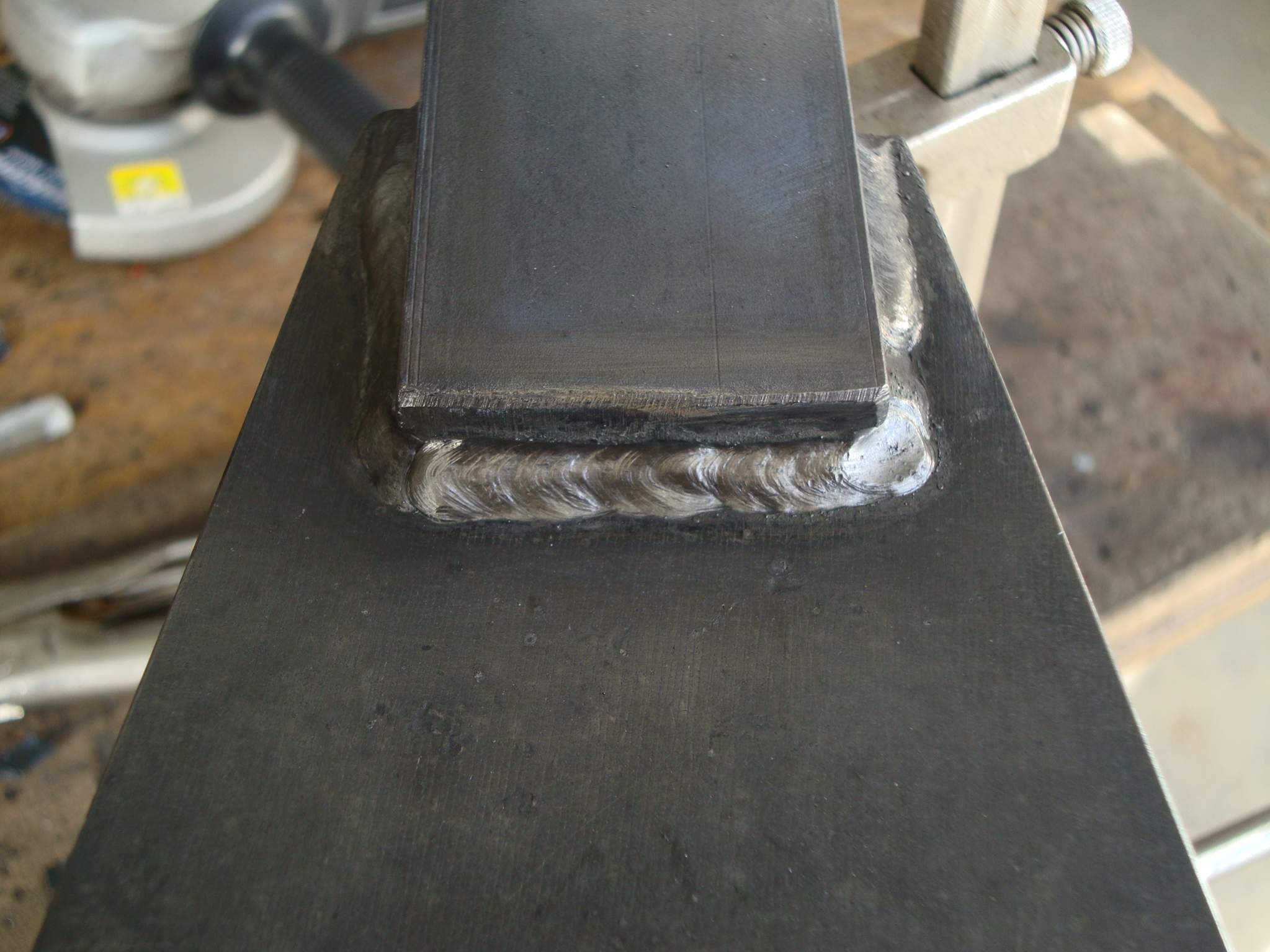

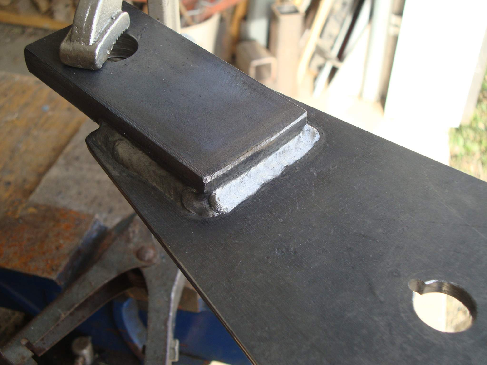

These are from today, using 1/8" 7014 @ 120 amps DCEP. One piece is 1/2", the other is 1/4" plate, part of a snatch block project I'm working on. 120 amps is what the welder says, it may be actually a little higher or lower.

Looks good Sean:thumbsup:
James K0UA
   / favourite stick rod #109
Those do look nice!:thumbsup:
I'm sure you could give a rat's azz less about my opinion, but I'll give it to ya anyway:D. I try to never to stop on the corner like that, I would much rather stop in the center of a weld zone. It's a structural thing!;)

Very nice welds:thumbsup: Makes mine look like crap. (not hard to do)
