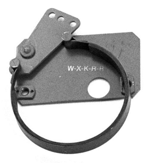

Well, first major glitch has been encountered and I don't have the machine available for a good look.
Can't find brake bands. Never replaced them on this mower and *assumed* it would be like any other commercial mower. Nope, it appears you need assemblies that have the band attached. Expensive. $35-50 depending on which side.
Need to research re-lining, I'm not throwing another hundred bucks towards brakes. All the modern bands I've installed in recent years have adhesive to hold the linings in. Can't be too hard to replace the friction material. Brakes are critical. Once you cross reference some parts the availability opens up but the prices remain steep.

On this note, belt/brake wear is dealt with by the threads on the long brake op rods that go to the handles. You'll just need to back these off or tension them down. There's a fine line in braking and steering that takes 15min to 1/2 hour to get braking and tracking coordinated. Can't do it without the machine running.
   / FD Kees 36" walk behind...
#16
Ya.. I adjusted them about halfway up each threaded part of the operating rods and there still is way too much slack in the belts.. Theres also 3 different holes for the brake actuator. Mines in the 'tightest' one now.. Whats funny is the old belts work perfect but measure out at a little over 43.5".. Wouldnt think 1/2" would make that much difference..
