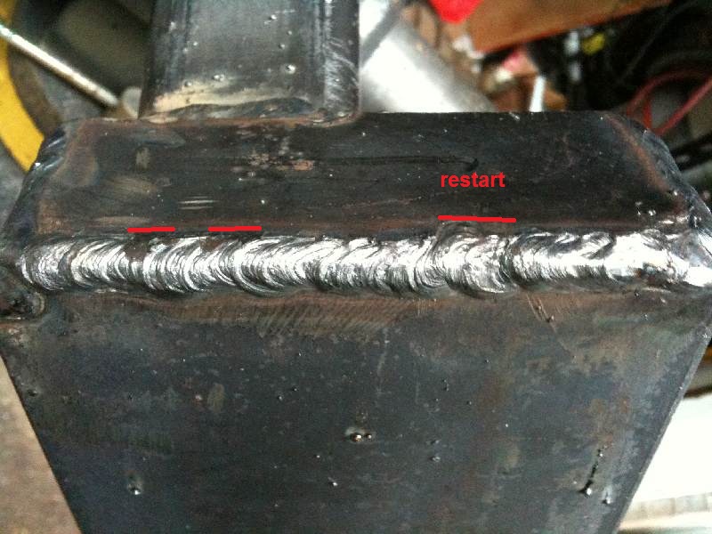

I continue to try to improve my weld quality and learn all the time.
I thought that I would ask for some feedback even though I am well aware that pictures do not always give a good idea and with a lousy iphone 3Gs as the only digital camera the quality is a bit lacking. I actually had a couple other pictures but the lighting and focus made the pictures unusable and I currently can't take new ones to replace. (not at home)
The project is made using C5-9.0# channel with 2x2x0.25 sq tubing cross-members with 1/4 inch end plates. The pictures are of the end plates attached to the ends of the channel steel. The end plates are cosmetic and serve no real purpose other than fairing the ends of the channel.
I was using 1/8" ESAB Acclaim 7018 running at 130 amps. I have to watch myself as I am inconsistent in travel speed and have been known to not weld as consistently as I would like to.
In the first picture I feel that I was really varying the speed of travel even worse than normal for me. The first two red lines depict what is about a 1 mm lip from not enough fill on the plate due to travel speed. Kind of herky jerky like. The restart kind of got buggered up and I did not fill the crater at the end as well as I should have by standing up the rod and waiting. I did stand up the rod but did not wait long enough (I think). I had mis-cut the end piece a little and rather than cut a new one I made a first pass with 3/32" at 68 amps to fill the "um how to you say resulting gap" :laughing: :ashamed: from my mis-cut. It was basically an open root edge for the end due to my mis-cut. That should not have had any effect on the weld that you see however.

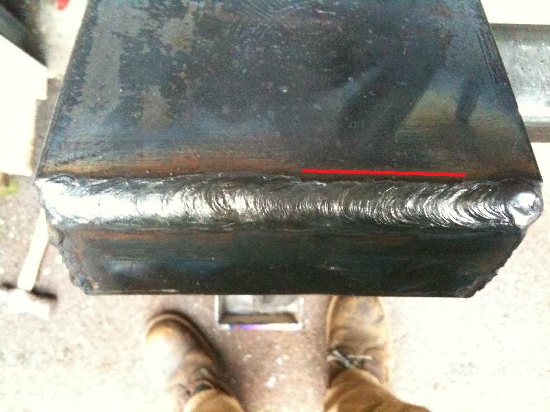

The second picture my travel speed was over-all better, I think. Where the red line is I again had about a 1 mm lip where I should have a bit more fill and I think if I had been just a bit slower it would have been filled properly. Again the crater at the end point. I have been trying to get better at welding around the corners but did not on these two welds as I had already done the sides and tried to wrap around from those welds but this weld mostly washed it out and I cratered again.

Sometimes on outside corner welds like that where you want to have a nice rounded edge, it makes it easier if you use a slight weave. Strength wise, burning the corner off doesn't give any more strength. In school when we did test plates, they wanted you to leave the edge. Your 1mm would have been perfect. You can tell speed was right in the second picture by the ripples in the bead. Rounded ripples is usually what you want and pointed ripples indicate too fast of travel speed. There are some rods/occasions where you can have/want pointed ripples. Thin material going fast, higher than normal amps, downhand, 7024, etc. Another way of doing an outside corner weld like that is to use 2 faster passes. This is usually on thicker steel though. Weld one bead to catch the bottom edge and then use the second pass on top to catch to the top edge. Done right will leave a nice round corner similar to a single pass weld. With a little experience and a non critical weld like a cap, position the piece slightly downhill and use a weave to keep the slag from running into the puddle. You can go a little faster and it's easy to catch both edges but the weld will be more flat than convex. Just for a cap on tubing doesn't require maximum strength.
You showed a lot of improvement from your first weld to the second one. :thumbsup:Do a few more and you should have it down pat. Nothing wrong with filling a gap. Just grind it so it has the same profile. Then you can do a consistent weld all the way across and nobody will know you made a little mistake. Being able to fix your mistakes is the sign of a good craftsman. That is fixing them the right way, so they are structurally sound and not noticeable. Even the best welders will occasionally have a bad x-ray and have to make repairs. A 1/8" 7018 should burn about 6".

Where did you have the arc force set? With my PA-300 I run the arc force at 1 when running 7018. I also found that Atom Arc wets out just a touch more than the Acclaim.
In the first picture I had the AF 1 because I forgot to change it back to AF 5 since I had it at AF 1 for my 3/32" 68 amp fix to my mis-cut piece. When I bumped the amps back for the 1/8" I failed to change the AF. In the second the AF was 5.

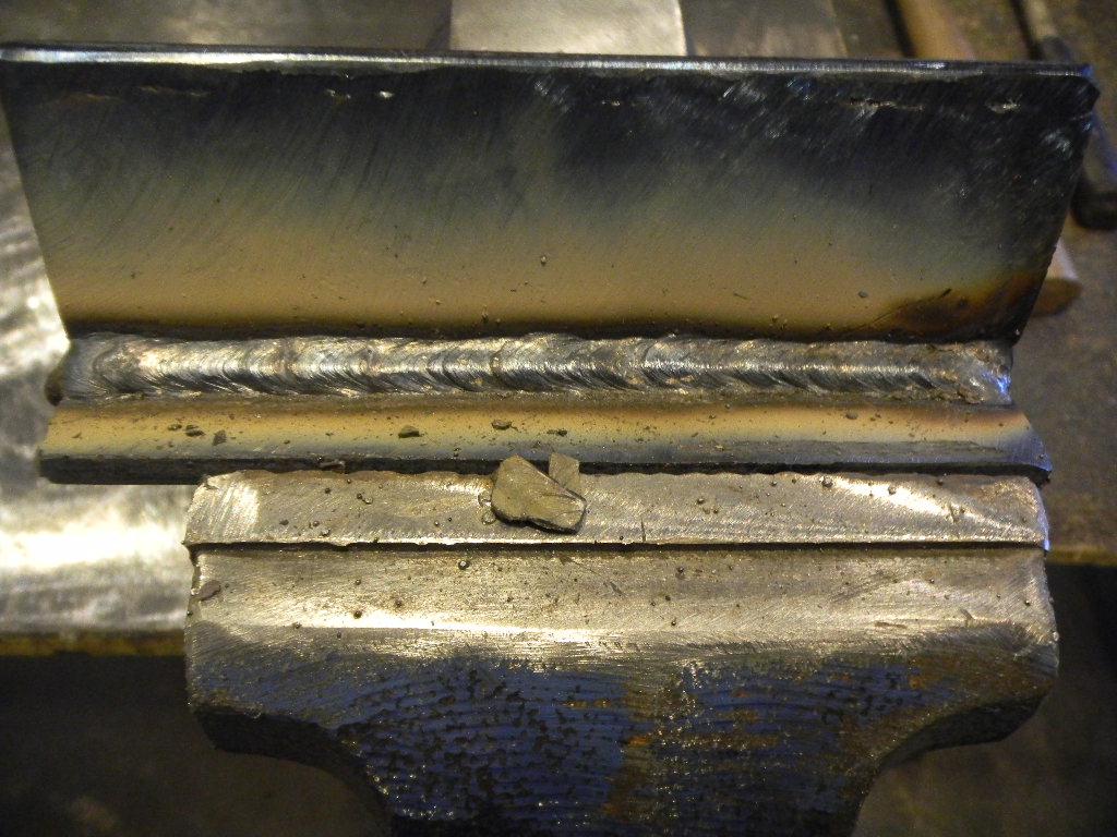

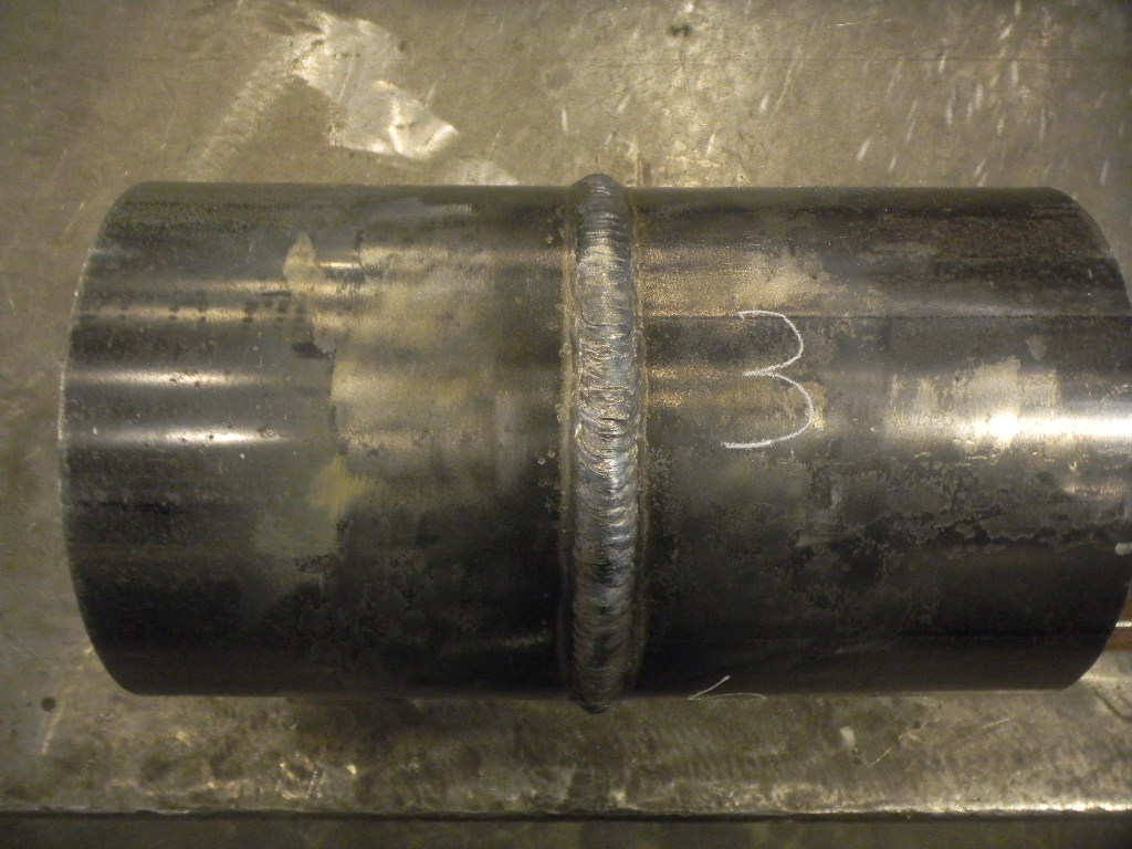

First picture is what I consider not very good wet out. Second picture is what I'd call good wet out.
