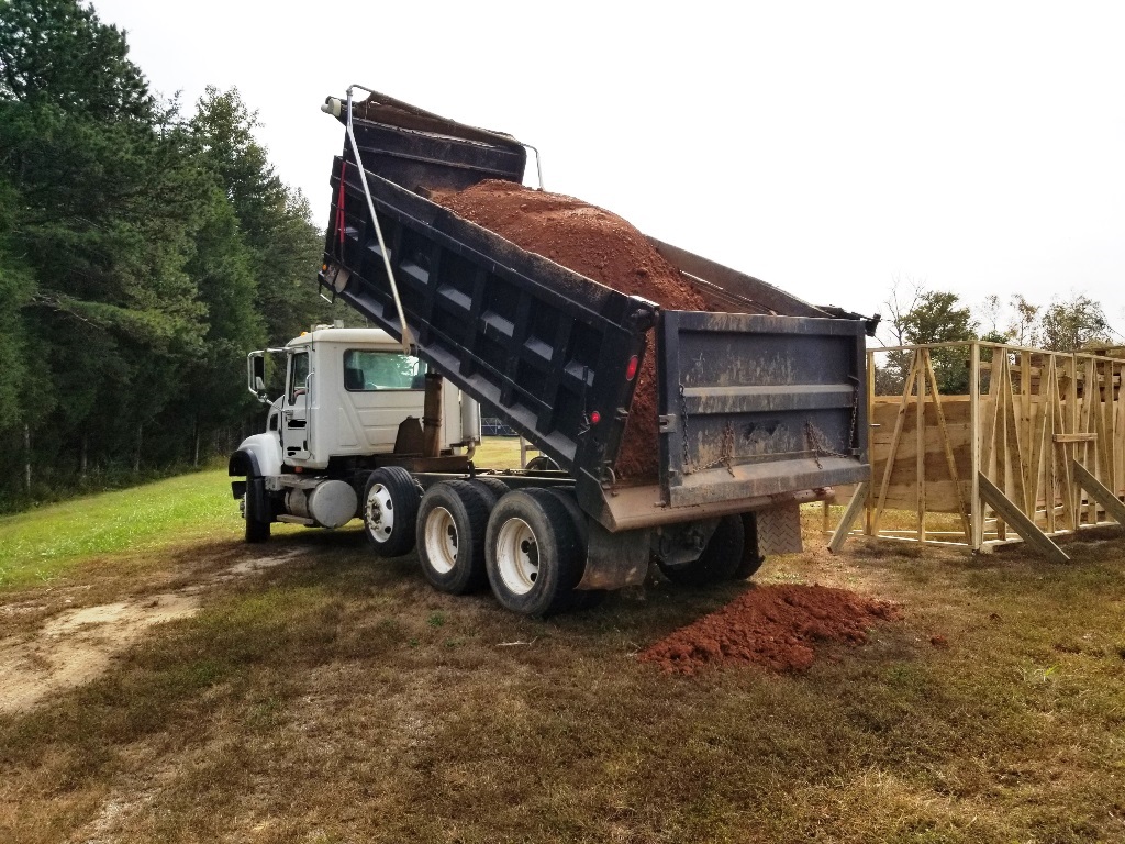

Had 2 tandem loads delivered yesterday of fill dirt. Just plain old Carolina red clay. 13 cu yds is one tandem load (advertised, sold by volume, not weight like stone).
Was extending a shooting berm/backstop. Addition is 16' wide, 6' deep, 7.5" high. So picture piling that against an L-shaped wall getting to 7+ft high at top. The way it flows/spreads, I get 6' at the bottom (with some bigger clods and stuff rolling off the mound extending beyond 6' a little), but only about 2.5' at the top. The L-shaped wall is pretty much to contain the pile so it will go up vs just continually spread out as it goes higher.
If I calculate that volume as a full rectangle shape I get 26.7 cu yds. But since not a box and the actual shape it takes is more of a right triangle, should take less dirt. So I was thinking 2x 13yd loads would be perfect - fill it and leave a small pile left to go back after it settles & compacts and top it back off. But it took all of both loads just about so no way they both = 26 yds. I had probably 3 scoops left when I was done - ~1.5 yds - and that was enough to level out the little ruts I made running the tractor over the same small area over & over piling up the dirt.
Is it pretty common to sell fill dirt, mulch, etc that way? i.e. full truck holds "about X yds" but there is a pretty large variance?
Over the years have had lots of fill dirt & gravel delivered. The piles look HUGE - esp when a quad axle delivers - and it never goes that far once you start using it - I get that part. My bucket holds 1/2 yard - not sure if that is struck or heaped, but the scoops I took weren't heaped a lot (not pushing in, curling, getting as much material as possible heaped in bucket) since I was taking to full height and keeping a overly heaped bucket level all the way up just drops a lot, so full buckets, but not heaped real high. Anyway, that should have been 50+ scoops. I didn't count, but as slow as I was going, no way I moved 50+ scoops.
I didn't see the 2nd load - he just came and dumped it while I was working on something else not paying close attention, but did get a pic of him dumping the first load. I think company name is obscured well enough to post.... Am I wrong in thinking the bed of that truck should have been "fuller"?
Remember the swell factor. The loose material in the truck has the swell added, once you place it and compact some you delete the swell so you actually put less in place than was in the truck. Folks tend to forget that. Same when you excavate; a certain size hole measures out a cube. Dig that out and it takes up a lot more space. There are tables that show the swell for for various materials in civil construction manuals.
